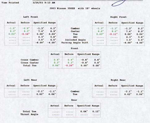

I am curious as to why the specified range figures are different from your printouts? Mine is the same form and from a local Nissan dealer, but the figures on the range allowed side differ....
Regards, Jim
Regards, Jim
Originally posted by Vincey2kr1
According to the specifications that my NIssan Service manager gave me, your Total Toe is out. HIs specs stated Front Total Toe should be at 0.0 to 0.8 If I read yours right, it was set to .09 and now its .11? Steven Lamm(NNA) is getting back with me with the correct specs .
Regards, Jim
Regards, Jim
Got the call from STeven from NNA, he says total toe spec is 0.0 to 0.8. WEll am I the only one with my total toe within Specs from NIssan? Mine is set at dead 0.0, still feathering. Picked mine up in late August Vin# 00877.

I'm cross-eyed now. Sorry this looks like crap and is a little hard to read, but I tried to put everyone's specs together. The first range is toe, the second is total toe, the third is camber and the fourth is caster. Also gave wheel size where known. Notice any differences???
aggie 300zx [-0.02*....0.06*] [-0.04.....0.12] [-1.3*.....0.2] [7.4*....8.9*] 18 inch wheels
kawataworks [0.00*....0.04*] [0.00....0.08] -[1.3....0.2] [7.4*....8.9*] 18 inch wheels
chinaclipper [0.00 in....0.8 in] [0.00....1.6 in] [-1.33*.....17*] [7.58*....8.92*] ?????
Deb's Other Half [0.02*....0.06] [0.04....0.12] [-1.9....-0.4] [0.8....17.2] 17 inch wheels
Enforcer [0.06....0.15] [0.12....0.30] [-1.6....0.4] [7.4....8.9] ???
I'm assuming you are just displaying the specified range and not what our actual numbers were "before" they did the alignment. I think there are two issues I observe here.
1) The consistency of numbers being used for the "correct" alignment.
2) The disparity in how bad some of our cars were out of alignment.
No. He is showing the specified "specs" range for the alignment. How is it possible that all of these cars got different "specs" from the dealer. All you need to do is check Aggies and Kawatas suggested"specs" on toe and this is really scary.
