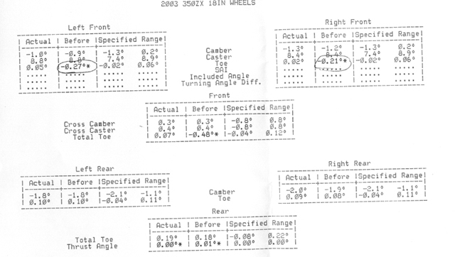

Any thoughts on why my dealer in OK would have different specs loaded into the computer for 350Z's? I'm trying to come to grips with this issue and have discussed this with the service manager. His comment has been that spec's were updated and that his alignment computer was accurate. At 1500 miles, wife's car has no uneven wear when checked by hand or by tread gauge. I would appreciate your thoughts.
DOH.
DOH,
I had the car shipped from Frost Nissan in Boston, Mass, but I use Jackie Cooper for service locally. Bob Isam, the lead mechanic at Jackie Cooper, is a longtime OK Z Car Club member/past president and z owner. I haven't had time to call him to talk about my car, but he is responsible for getting the tires replaced, alignment and everything. I don't know what specs were used. You might call and talk to him about it to double check Nelson. I doubt you would see tire wear yet at 1500 miles. I didn't notice any problem at all until around 7000 miles.

OK, I am back
a few things, the SM knew NOTHING about the bounce or tire feathering issues. but I got my alignment done anyway.
the alignment guy said that the fronts were very close to nissans latest specs, BUT the rears were pretty far out (he was surprised I was mentioning anything wrong with the fronts).
here is my cars specs
.....LEFT FRONT....................................................RIG HT FRONT.....
after............before..................................... after...............before
-1*20'........-1*17'................CAMBER.........-0*44'............-0*46'..
8*55'........8*57'.................CASTER............8*38'.. ...........8*31....
0*04'........0*05'....................TOE...............0*05 '.............0*06'...
5*02'........4*56'....................SAI................4*4 3'.............4*42'...
3*42'........3*39'..........included angle............3*59'..............4*42'...
.......................................FRONT............befo re..............after.........
CROSS CAMBER.....................................-0*35*............-0*31'.......
CROSS CASTER......................................0*18'........... ....0*27'........
TOTAL TOE.............................................0*09'....... ........0*11'........
.....LEFT REAR......................................................RI GHT REAR....
after...........before...................................... ...after.............before
-1*36'........-2*30'...............CAMBER..............-1*35'.........-1*52'...
0*05'.........0*03'................TOE.....................0 *04'............0*03'...
.....................................REAR...............AFTE R..............BEFORE.........
TOTAL TOE...........................................0*08'......... ......0*06'............
THRUST ANGLE.....................................0*00'............. ..0*00'............
it took me 20 min to do that, can anyone tell me how it looks????

According to the specifications that my NIssan Service manager gave me, your Total Toe is out. HIs specs stated Front Total Toe should be at 0.0 to 0.8 If I read yours right, it was set to .09 and now its .11? Steven Lamm(NNA) is getting back with me with the correct specs .
aggie300zx,
Oh MY GOD, your toe settings were way way out of the specs.
Your left front tire was 12.5x out of the spec range or 1250% !!!
Your right front tire was 9.5x or 950% out of the spec limit...
Not only that but your front camber is right at the spec limits and your rear tires are right at the spec limits too. Yikes!
