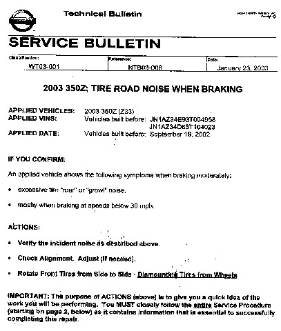

Mine are feather pretty badly and I have mostly Highway miles. I have low speed brake grinding and rubbing sound on sharp low speed turns. I also have the grease streaks on the windows.
