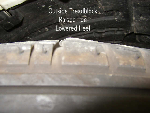

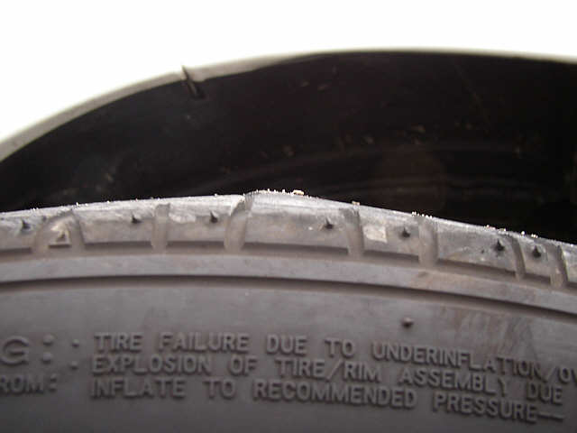

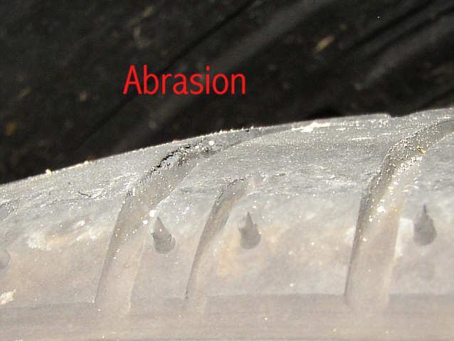

Alright, I have 1400 miles on my Touring edition (vin # 109310), I have been monitoring this thread and my tires.
The screwdriver depth test shows that the inside tread block is more worn than the outside tread block. But no signs of cupping yet.
I have some experience with this. My father owns a garage in PA and does quite a few alignments, I messed with my last car's suspension (a 97 Integra) and got the same problem.
I found that when I lowered the car I was able to still get it into the manufactures specs. The stock wheels and tires had no problem, When I 1 upped the wheel and tire size and went with a softer tire I got cupping on the inner tread block.
Pop said that the spec is wrong for that tire geometry and we needed to installed a camber adjustment kit to bring the top of the wheel out slightly.
I sold the Teg before I needed new tires so I never tried the fix. But boy were they humming at hiway speed.
I believe the following:
Wear on the inside tread blocks are useally caused by camber.
The camber is not adjustable on the Z, therefor they are not goign to publish a new spec with the correct setting.
Cupping caused by suspension problems (spring rates vs. shocks), in my experience causes flat spots across several tread blocks in both directions.
Cupping on each block, as I believe people are seing here is caused by not having a flat enough contact patch under load. This may be exagerated by the soft compound in these tires.
This cuppig could be caused by toe settings but is more likely caused by the camber toe combination under turning load.
The manufacture will not neccessarily fix the problem. For example I recall reading somewhere that the Acura NSX has a known issue with rear tire wear, which is corrected with an aftermarket kit yet Acura continues to manufacture the "defective version" of the NSX and sell them for $80K.
Therefore it would be likely that we could fix the problem if it was possible to really align the car.
The aftermarket will have to get there eventually as people lower their cars so can't we get someone like Stillen to help find a fix?
Unfortunantly I live several hours from home now so I don't have the luxury of letting pop tear into the car and see what he can come up with, so does anyone have ideas on how to make the caster and camber adjustable or better yet aftermarket contacts?
