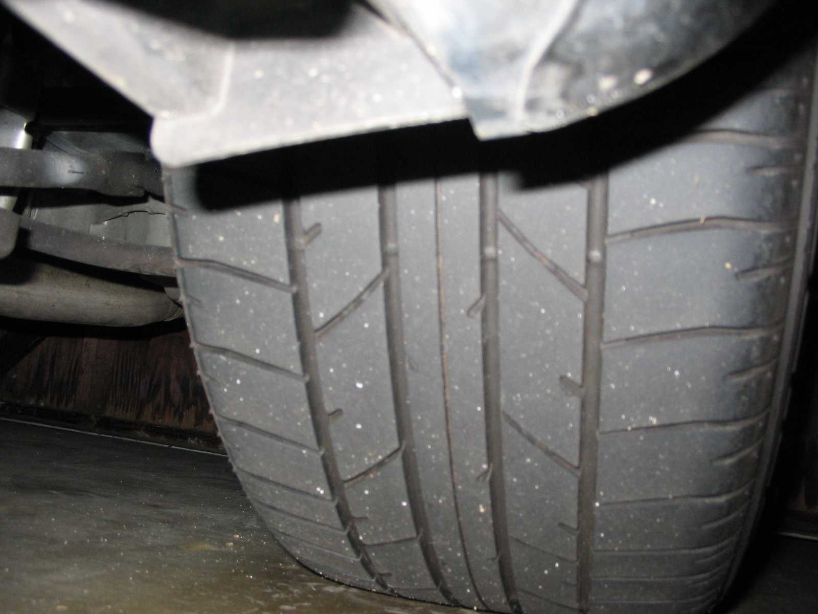

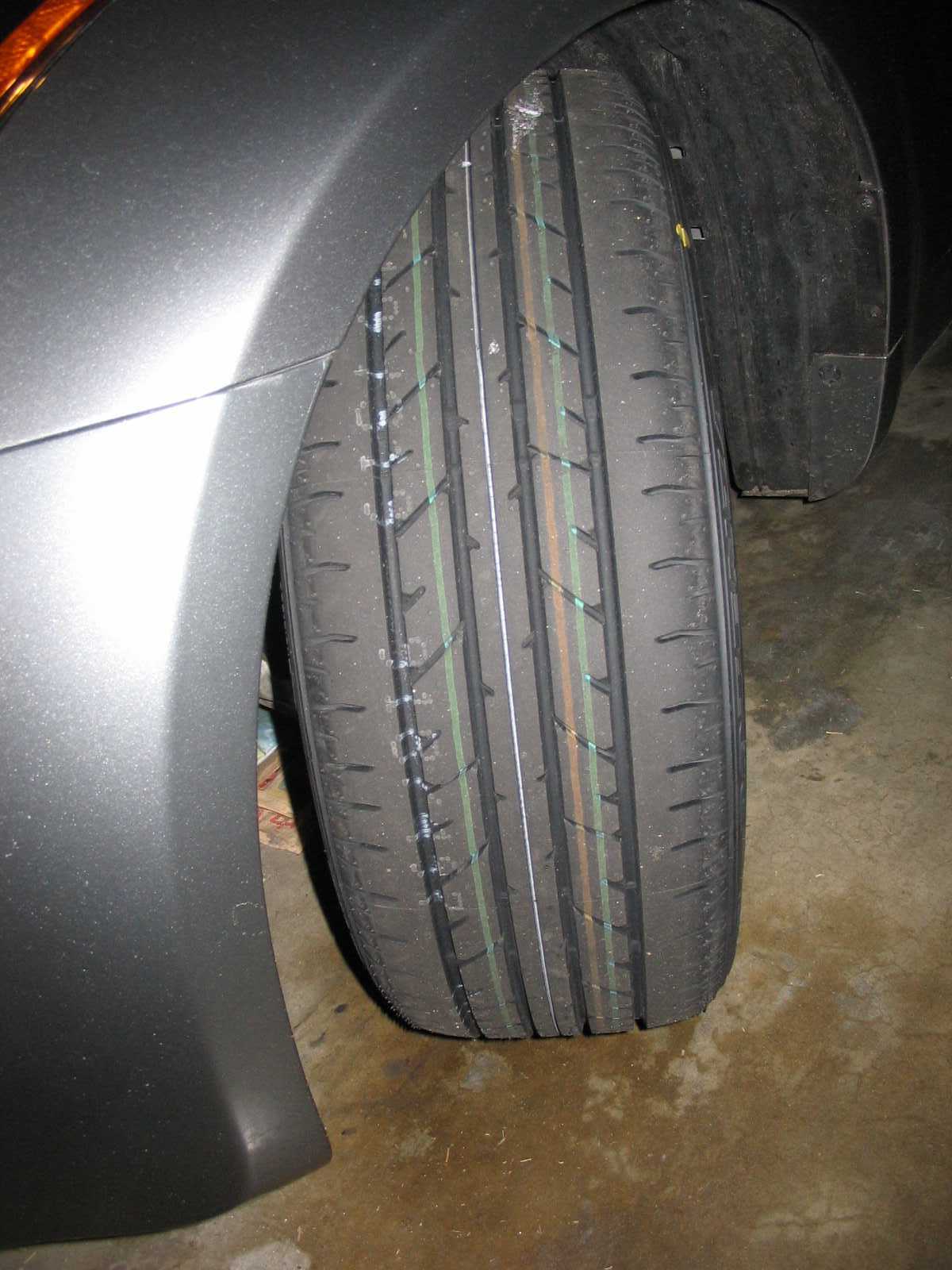

I don't think this has been posted so here's a pic of the "NEW" RE040 tread pattern. It looks so different from the "original" RE040 (pic attached for comparison, rears tho). I wonder how these tires can both be called RE040.
Attached Thumbnails Tire FEATHERING: FYI-img_0762.jpg   Tire FEATHERING: FYI-img_0763.jpg
The only change that was made was to the outside treadblocks, which are now connected instead of having the sipes running all the way through. Otherwise the interior pattern, construction and materials are all the same from what I recall.
Anyways, thanks for posting these photos...someone did post these awhile ago and I could not find them for the life of me!
