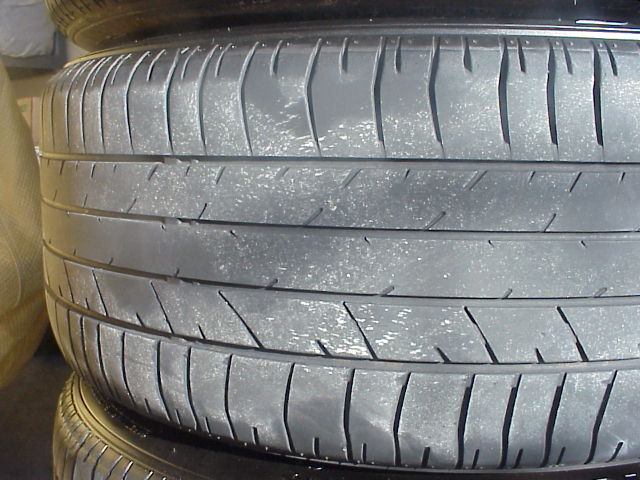

I just turned 10K last weekend. Eveything had been going good with the car until about Sep. When I started to get an increase in road noise. I was checking the tires often when the tire problems started with other people. I figured that I had over 6K i was going to be alright. But today was the first time I check my tires in a while and found that I have developed the same problem. I have an apt at the dealer next week.

The wheel bearings are not the problem. If they were bad enough to make the tires cup and wear out the steering and front end would feel like a 300,000 dump truck.
The problem is a combo of geometry, spring and shock's. Bearings are cheap and easy to fix. NNA wishes it were only the bearings

15,000 miles and my front tires are feathering badly. Told my dealer about the roaring noise and uneven tire wear during routine tune-up and requested an alignment (under warranty). Unfortunately their alignment machine was down at the time.
Based on what I read on Discount Tires' site, the problem appears to be from too much negative camber. Hopefully the alignment will correct this problem. I definately want to make sure before I purchase and mount the new 19's I'm planning on getting next year.

I took my tired *** to a Firestone/Bridgestone tire store and asked the guy to take a look at my OEM Protenza's. He took his hand and felt the inside tread and asked "What happened, these are brand new tires?"....
So I gave him a bit of a History lesson as to the problems many Z owners have been facing with the "feathering" of the tires. He had heard of a problem but hadn't seen the problem in person. He offered to write up a invoice showing that the tires are in the lack of a better term "ruined". He advised me to push for a replacement. Thanked him for his time and went on my way.
While speaking to the service mgr yesterday, I informed him that I had the tires inspected by a 3rd party and they gave me a write up to produce. He had his reservations (of course) and I informed him that when I signed the dotted line, I wasn't signing up for a car that chews up tires. I also informed him that I have better things to do than bring my Z in for the 5th time - I've had to take time off work 3 times to fool with this. He argreed that bringing the car in for the 5th time is a bit unreasonable for a new car. I agreed also and thanked him for the prompt service I received the 4 other times. I also called NNA and informed them of same - the customer service rep looked over my case # and agreed that all the TSB's have been preformed and there are no other options except replacement.....
So we'll see on 10/25.

This guy could definitely be smoking crack, and I cannot verify his expertise, but he also said that toe-in or out alone would not cause true scalloping... and this seems to make sense as nobody has been able to find an 'adjustment' that will fix the problem (nobody that has had the problem has been able to fix it). Some of us don't have the problem and that also leads me to believe that it cannot be a suspension setting that can be varied... otherwise people with the problem should be able to 'set' their cars just like the people without the problem.

BTW, I am surprised anyone can get 15,000 miles or more from the OE tires, their wear rating is 140, which is very low for a street tire.
