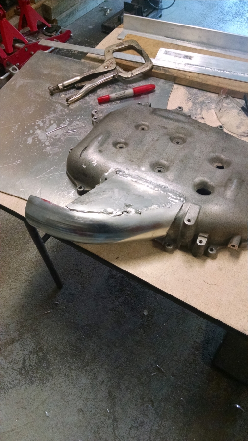

Well, I had my first stab at it. Its not done, but made some progress. It looks terrible, but it will do what its supposed to when done. When I was practicing TIG welding it was a lot easier I felt. You can see in the second pic, the welds on the left were the last ones I did before I started on intake and they are not too terribly bad.
I had a lot of issues welding on the intake itself. I don't know if its because its cast aluminum or what...The pitted spots you see on the pipe is when I ran out of gas...LOL I didn't know what was happening. First time newb problems.
Anyway, I ran out of gas and there isn't a place to get more on the weekend.
I'll grab another tank tomorrow and get cracking at it again.

Attached Thumbnails 87mm TB Project-optimized-round1.jpg   87mm TB Project-optimized-tig-weld-practice.jpg
Yeah cast aluminum is much harder to weld than extruded or billet. It tends to pop and splatter for no reason, it requires a decent welder and lots of actual experience to get consistent pretty welding on cast. I've welded some elbows to turbo outlets and it wasn't pretty the first couple times.
Although, no tig comes out nice if you are running out of gas

the nice thing about working with metal, you can always add metal and take metal away. sand the welds down and polish it up it will look awesome

Yea I def plan on cleaning this thing up when its all done.
