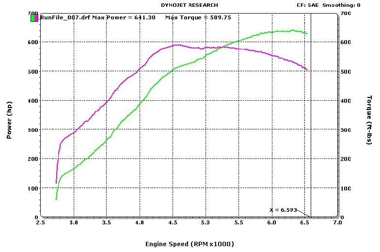

Call me crazy, but the 641rwhp pull looks like a greddy kit. Whats the specs on the 37r?
tyler, you are not so crazy.. hp curve is a lil similar
but it would take like 18 psi for a greddy to achive similar numbers. tq curve is different 2. its pretty amazing that the aebs kit (engine) get the gt37rs(2) to spool like that

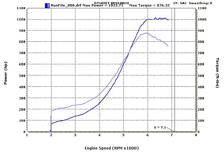

I don't get why you'd have the variable cam timing turned on for the 600WHP run, but then you disable it for the 1000 whp run.

Quadcam/Turismo, I could be wrong, but I believe they were still testing some features of the EMS when the did the lower psi pulls.

awesome power, but it looks somewhat laggy....

take a look at the Run File numbers. The 600 whp run is run7. the 1000whp run is run8. It could just be a coincidence that the numbers are consecutive, but it seems odd to go from 600 whp with the cam timing on, and then turn up the wick (and turn off the cam timing) and go for 1000whp. Especially, when you read the OPs comments that attaining the 1000 whp mark wasn't easy and also that Intense asked the owner if he wanted to push it to try and hit the mark. It doesn't sound like they went immediately from 600 to 1000 on consecutive runs. Again, maybe the numbering of the files is just a coincidence. I Dunno?

lol, they did more than just 2 runs ovbiously
also, well cam timing on/off isnt going to affect peak power very much.
Keep in mind the engine headgasket did fail so there could be something that played on that.

Quad.... the 600whp pull and the 1,000whp pull were over a month apart. I don't know if it's pure coincedence, but they weren't done on the same day.

good. thanks for the info.
What EMS was used on the 600 WHP run? 1000whp run?

most strokers arent suitable to raise the rpm..but you can see there is plenty more power to go with more psi, the curve is just going up flat

ProEFI
