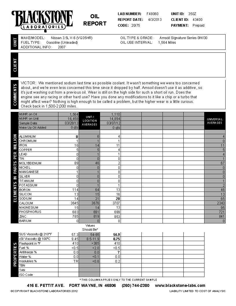

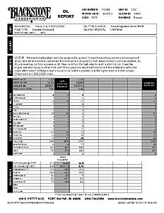

Here's the results sorry about the pdf.

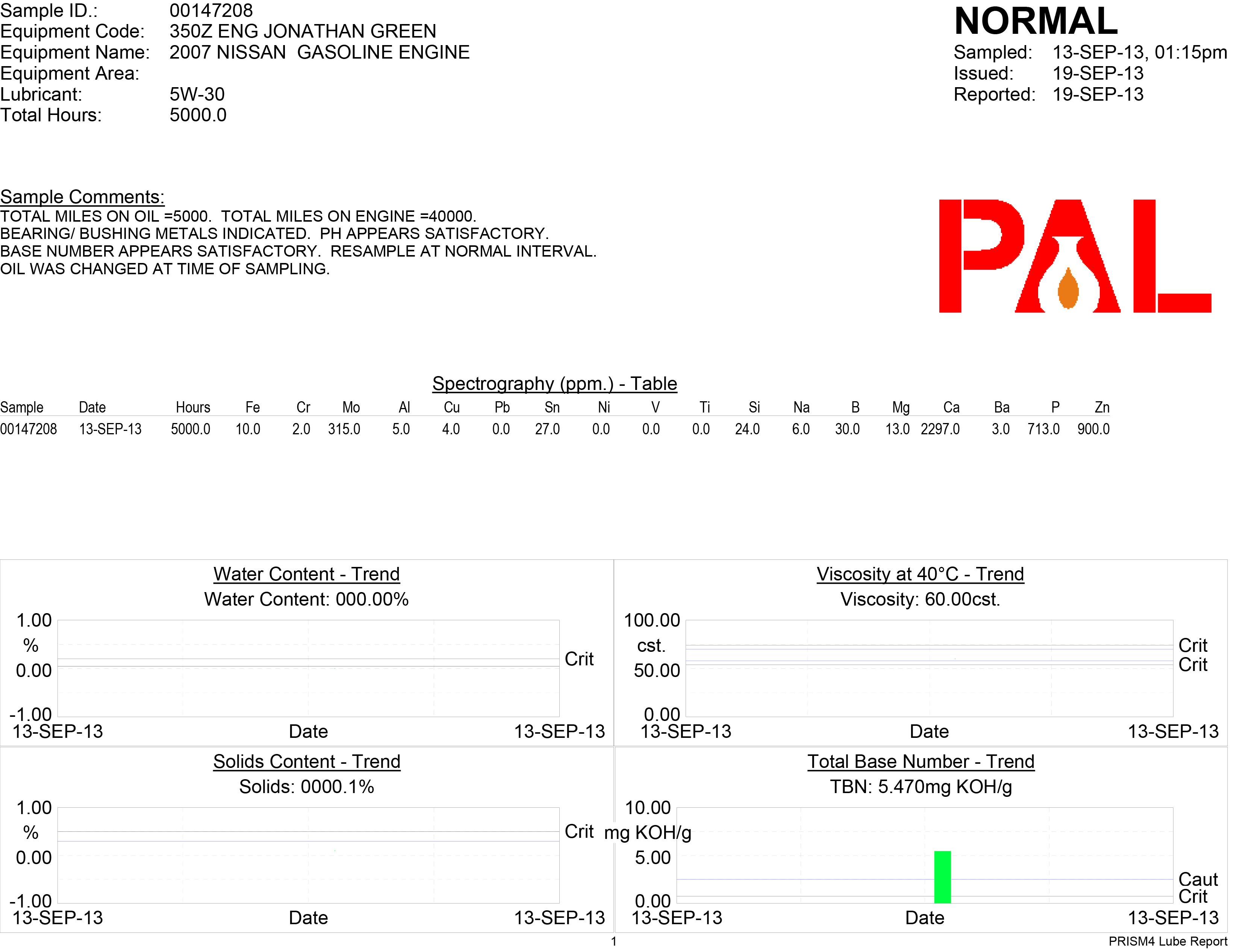

From: Valrico FL
just did my 2nd oil change since i owned the car, we have a family friend in the lubricants business so i had him to a analysis when i changed the oil. i looked into many threads talking about oil change intervals and possibly changing to full synthetic. The oil is Pennzoil 5w-30, driven 5000 miles, the engine at the time of change had 40k miles. heres the results. i dont personally understand them but i am told it is well within range and 5k mile intervals are fine. i will continue to analyze a couple more changes to ensure consistent results.
Attached Thumbnails 2007 VQ35HR Engine Oil Analysis-350_z_engine_9-13-13-1.jpg

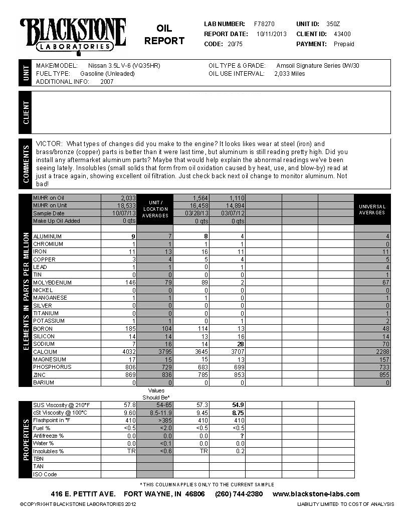

Here are two more oil changes with Amsoil 0w30
