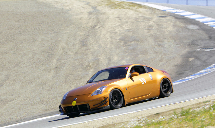

So.. here is the problem child, REVIVED! (Scott and I were scratching our heads)
Setup:
F- 9.5x18, 255x35 Toyo R888, 2.4 camber
R- 10.5x18, 274x35 Toyo R888, 2.0 camber
I was able to fix the rubbing by stiffening up the Koni's on front and rear + a fender roll. I think the R888 275's runs a lil wider...
Awesome day at Laguna seca and pushing it my the limit!!
Many thanks to Scott and Z car garage to help me set this up!
Setup:
What springs, what spring rate , how lowered are you ? The pic shows your car with the suspension fully bottomed out. Do you have bump stops?
With my set up, the only place i can rub up front is the fender lip. Fully bottomed, my tire slightly touches the inner fender well plastic ( i removed my spring and fully compressed my suspension for testing) The rear on mine has a mile of clearance.

Thanks! I bought Tein springs long time ago.. don't really remember the spring rate. It was lowered close to an inch. I don't have bump stops. I didn't feel the car fully bottoming out. Luv those Koni Yellows!
Half your front and rear tire are tucked and the mud flap is almost on the ground. Spend a couple hours removing springs, looking at your travel limits, seeing what is causing the problem. It helps for setting things up.

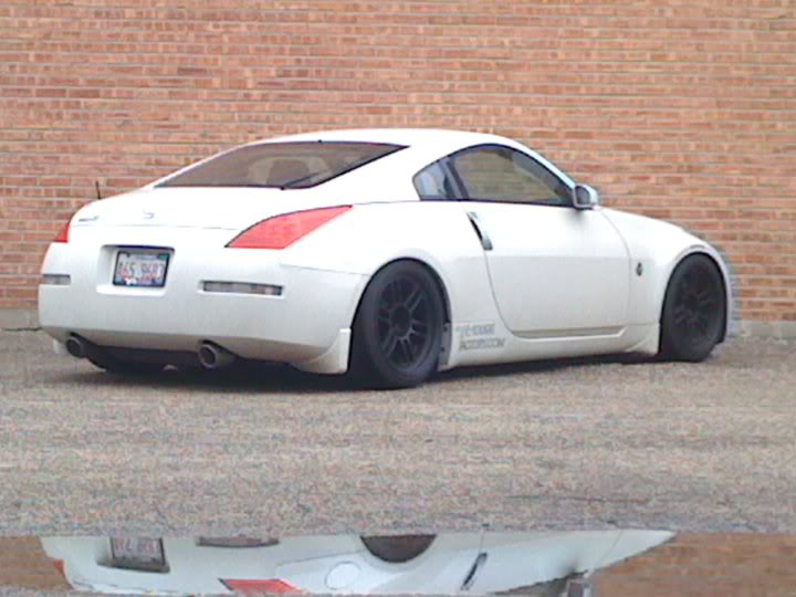

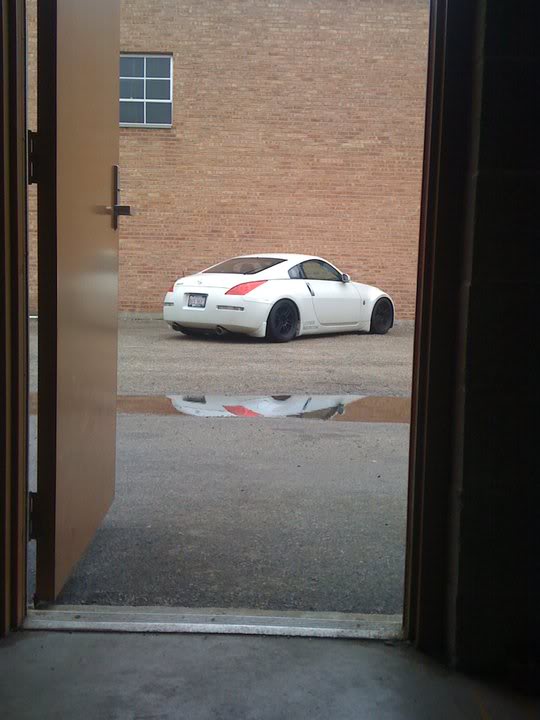

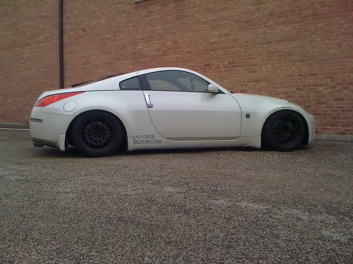

From: Chicago
18x9.5 +15 225/40 F
18x10.5 +15 255/35 R

that's mo fo low!
