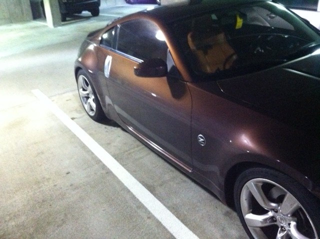

Old Mar 15, 2012 | 03:44 PM
  #743
MantisMan's Avatar
MantisMan
Joined: May 2011
Posts: 190
From: Indiana
Originally Posted by MantisMan
Car looks great though with the 25/30 setup......I"ll get some pics posted up.
Pics....
BEFORE
AFTER

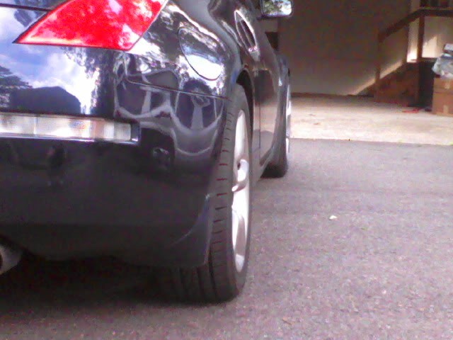

Old Mar 25, 2012 | 04:11 PM
  #759
Brogan07's Avatar
Brogan07
Joined: Jun 2011
Posts: 168
From: NJ
Yup, that's them.
Gonna need another member who has the same setup to find out for sure. 25mm spacer + stock v2 18-inch Tourings + stock lugs. I'd also have the shop double check the fitment, especially the fronts, 20mm should definitely work fine.
Here's my rears:
