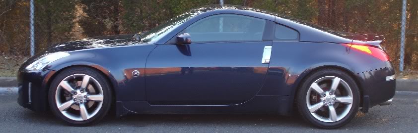

Just got word from the shop that my 07 with stock wheels/tires and 25mm spacers front and back DOES NOT rub at all after being lowered on Eibach Pro Kit springs (1", 1").
He also mentioned that it looks like no camber kit will be required.
*fist pump*
Will post a pic after I pick the car up tomorrow.
edit:
