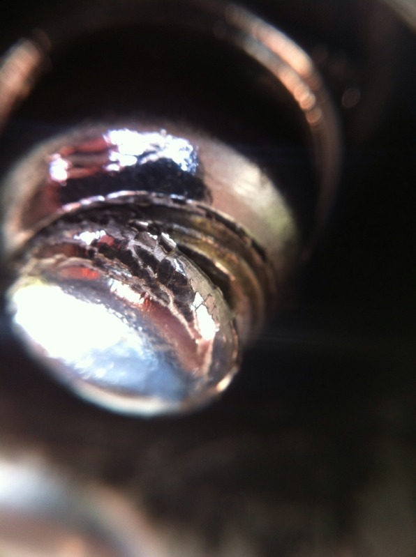

Here is a picture with my iphones macro lens- its pretty close up so you can see the detail... This is one of the more drastic ones though, most of them you can just see the stress of the bolt- but they haven't pushed through.
I'm wondering if they did use an impact gun, I thought you werent supposed to do that with spacers though (unless that is just the spacer lugs, and not the actual wheel lugs).

Wow, that's f*ckin' crazy!
And yep, I'm sure that was done with an impact and obviously over-torqued since I highly doubt 80 ft-lbs would cause that damage
I don't think I would trust driving around like that since you really don't know if the wheel is torqued to spec. Better safe than sorry and pick up some open ended lugs.
Yeah they already ordered new bolts, I'm not sure if I can wait for the ebay ones (although they are $40 less) to get here, since this is my daily driver. I may just go have them put the new ones on.
Do I need to make sure they dont use an impact gun this time (or is that only for the lugs that connect the spacer to the hub)?
