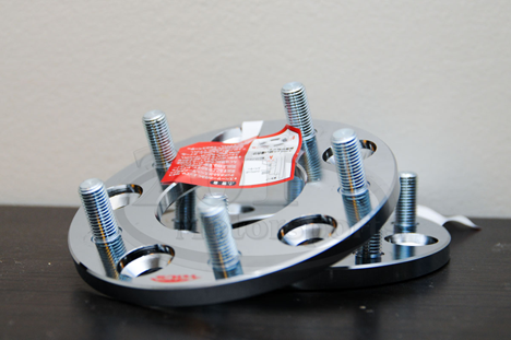

Originally Posted by tSaroya
The problem with this is how expensive it is to have the studs installed. That the whole reason Im trying to buy 10mm PRE-STUDDED spacers. That way i just throw the space on with the OEM stud still in play. The problem here is, from what ive seen from searching, is that no one makes 10mm prestudded spacers. If i went the slip on route, it takes a long time (labor cost) to attach the studs into the hub. Im not a mechanic by any standards, but i have dont little things myself like changing the OEM battery, all the laighting being changed to LED/HID's, etc. But with things such as suspension and brakes, i dont trust my ability or my mechanical work. Hence why i made the thread in the first place. So again i must ask, anyone know any company that makes a studded 10mm spacer?
Project Kics makes a 10mm spacer with studs built into it. I'm pretty sure it's made from steel though because aluminum probably wouldn't hold up very well.
Old Jun 11, 2012 | 11:42 AM

^ Nice find! I must have overlooked that during my searching, because I know I looked for both KICS and Ichiba 10mm w/ studs. Maybe I just used the wrong search terms.
To my knowledge they are the only ones that make them. I've seen them up close and they're pretty high quality and have some heft to them. They probably weigh as much as a standard 50mm aluminum spacer.
There are multiple vendors online that sell them though.
