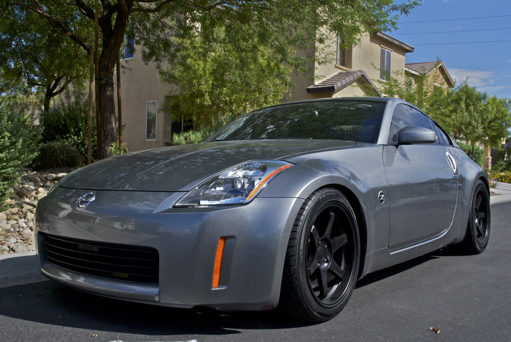

so i have 18.9.5+22 on all four corners of my Z with 255/40 F and 275/40 R lowered an inch or so on tanabe gf210 ... been wanting the wheels to sit more flush but wasnt sure what size spacers to go with without having to worry about rolling or pulling my fenders. if it matters im running about -2 camber in the back.
was thinking ichiba v2 15mm front and 20mm back? what do you think?
Old Sep 23, 2012 | 02:17 PM
  #955
Bmurray350z's Avatar
Bmurray350z
iTrader: (34)
Joined: May 2011
Posts: 8,075
Likes: 92
From: Burlington, NC
you will have to roll your fenders if you put any spacers in the rear. i would do 10mm front and 15mm rear.
also, did you do the rear spring mount mod?

no i didnt cut the rear spring mounts. that pic is the first day the springs were on, its been almost a month now and its much lower. but it would be necessary to roll my fenders with 10mm F and 15mm R ?
Old Sep 23, 2012 | 02:48 PM
  #957
Bmurray350z
iTrader: (34)
Joined: May 2011
Posts: 8,075
Likes: 92
oh just re-read it and saw that it's 9.5 on all four corners. i thought you had a 9.5/10.5 setup. you could probably get a 20mm spacer in there. but if it's much lower than this picture, i would advise you to get your fenders rolled just to be safe. its not a big deal, so why not?

You will hear a donk when you go through dips with the 15 or 20 mm spacers in the rear. I had 18x9.5 +0 -2 deg on 255/40 and it would rub/bump the rear fender w/o roll, w/ roll and current wheels 10.5 +5 285/35 no issues.

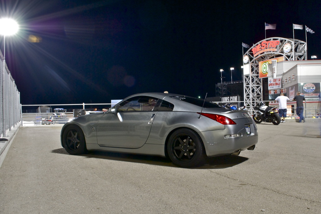

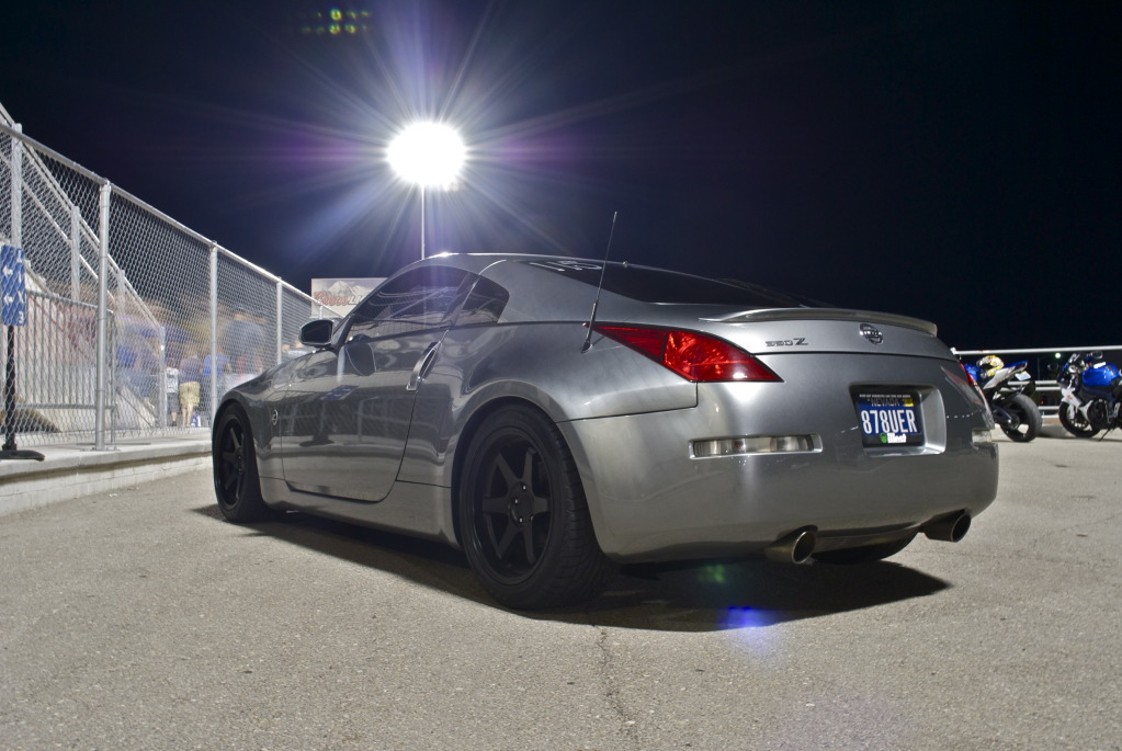

yeah 9.5 all around. well the wheel gap in the back is about one finger width and the front is barely one finger width. as when i first installed em the back was about 1.5 finger width.
Old Sep 23, 2012 | 03:05 PM
  #960
~trtlespeedZ~'s Avatar
~trtlespeedZ~
Joined: Dec 2011
Posts: 44
From: las vegas
how far were you lowered?
