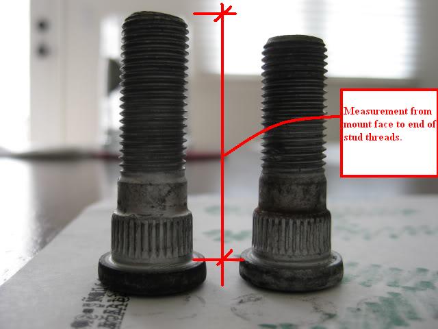

Need help finding shorter length replacement studs?
From JasonZ-Ya's post...
The Z OEM studs are M12X1.25 with a 14mm knurl at the head
FRONT OR REAR: M12X1.25x42 (42 mm length) OEM F/R replacement -
NAPA P/N 641-3210
AUTOZONE - 610-378.1 98353.1
I called ARP and they said they can't match those sizes. I don't get it, I thought someone posted ARP replacement part #'s?
Another post showed 20mm spacers with OEM studs protruding +3mm. I have 15mm spacers (3+5=Pie squared?), so I would need 34mm overall length studs.
My other options are:
1. taking the car to my fabricator and paying big time to have them professionally matched cut.
2. Selling the Ichiba's and buying Eibach's with extended studs which still requires removing and pressing in studs. Although I did see a thread where someone whacked them out with a hammer and they got pressed in when the lugs got torqued.
Where could I get "quality" steel studs, any sponsors here? I don't track the car, so I really don't need titanium or T71 aluminum but would want stainless or high grade steel that won't rust and/or strip easily.
Last edited by goracerx; Jul 21, 2012 at 01:37 PM. Reason: Found correct OEM stud sizes. Need -8mm shorty replacements.

http://www.jegs.com/i/ARP/070/100-7716/10002/-1
Reply from ARP with part # 100-7716. I'm really not sure how 72mm is 8mm shorter then 42mm. They must be using the governments budget calculator.
That means my only options are:
  1. Have OEM studs cut - 8mm
  2. Sell Ichiba v2 kit and buy Eibach kit with extended studs.
ARP extended is way to much to cut in half. RA's price for Raybestos brand w/ship+tax = dealer retail price. Finding a machine shop to cut them is like asking for a favor.

dude, when i went through this, i found that the measurements on studs vary...some measure from the end, others measure from the base of the knurl/mount face....
So;... the "mm" dimension given on their websites is complete crap unless you know from where the measurement began...get it?
I literally have a few sets of 10 studs in boxes too long or too short for my needs....
you have to email directly to each vendor and have them measure, provide a picture and hope they know how to use a damn ruler...
stoopid i know...
you literally have to email them this picture and tell them what you need:
-J

Keep V2, convert to V1 and get the studs from Ichiba or ARP, simple and easy.
