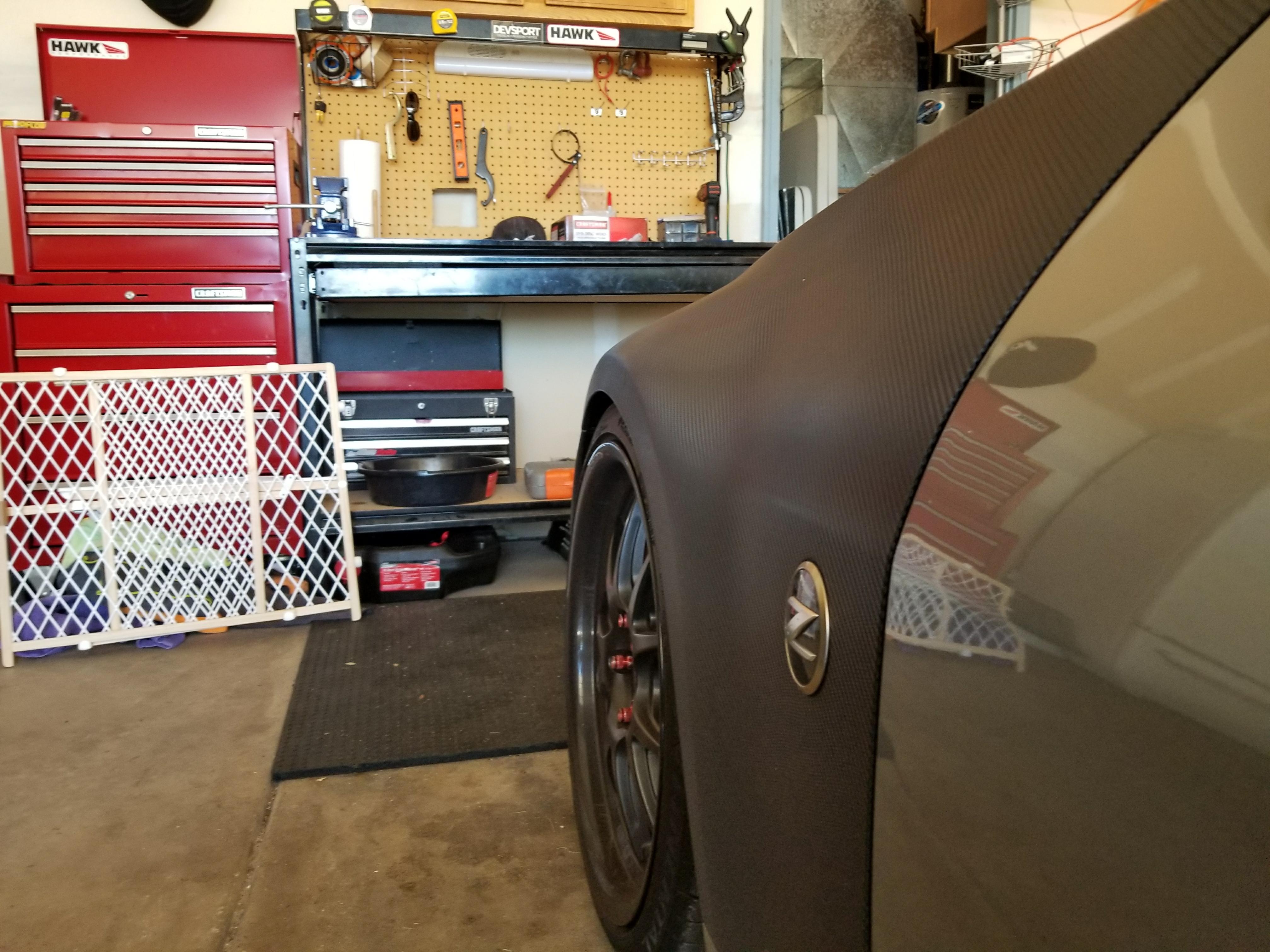

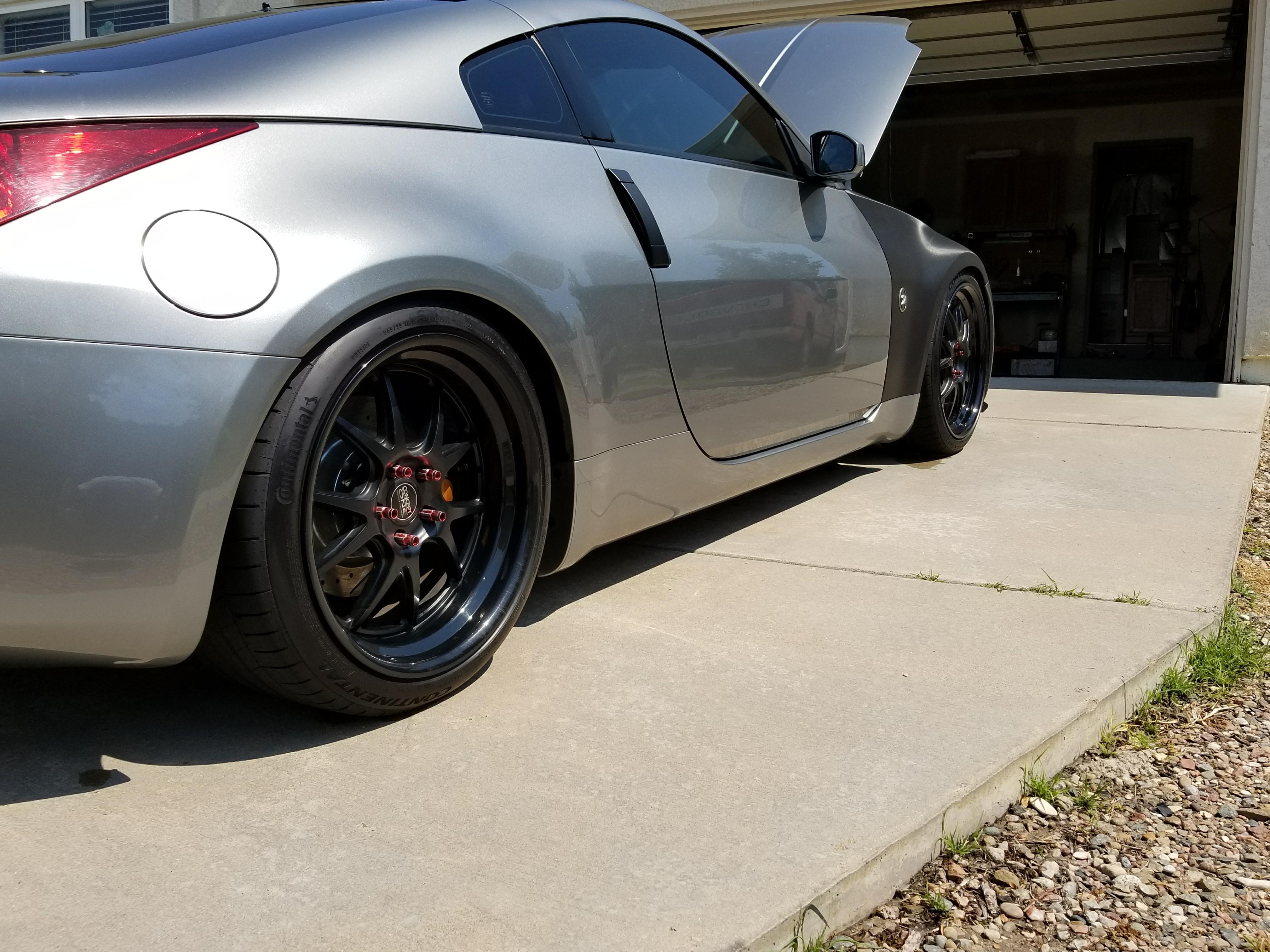

the rook's Avatar
the rook
Joined: Aug 2016
Posts: 439
Likes: 31
From: Pueblo West, Colorado
FAQ: Official wheel "SPACER" thread!-20170903_131744.jpg
Attachment 1
FAQ: Official wheel "SPACER" thread!-1505938766150.jpg
Ordered H&R 15mm bolt on spacers all the way around.
19/9 et25. 245/35
19/10.5 et20 265/35
Lowered almost 2 inches now.
Shooting for a half inch lower all around.
Setting camber at -2.2 front -2.5 rear.
Fenders are rolled but not pulled or flat rolled.
Thought??? Yes, No?
Pics of similar???
Just in for some feedback and similar setups.
Thanks.
