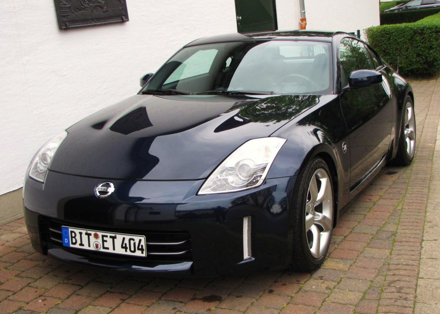

Smile Ichiba V2 Spacers Intalled
Just wanted to share some new shots. The car is lowered with Eibach Pro Kit Springs with Ichiba V2 Spacers (20mm front / 25mm rear). It doesn't only look better, but it handles better as well. This thread definitely helped me a lot.

great addition in pics....
thanks,
J

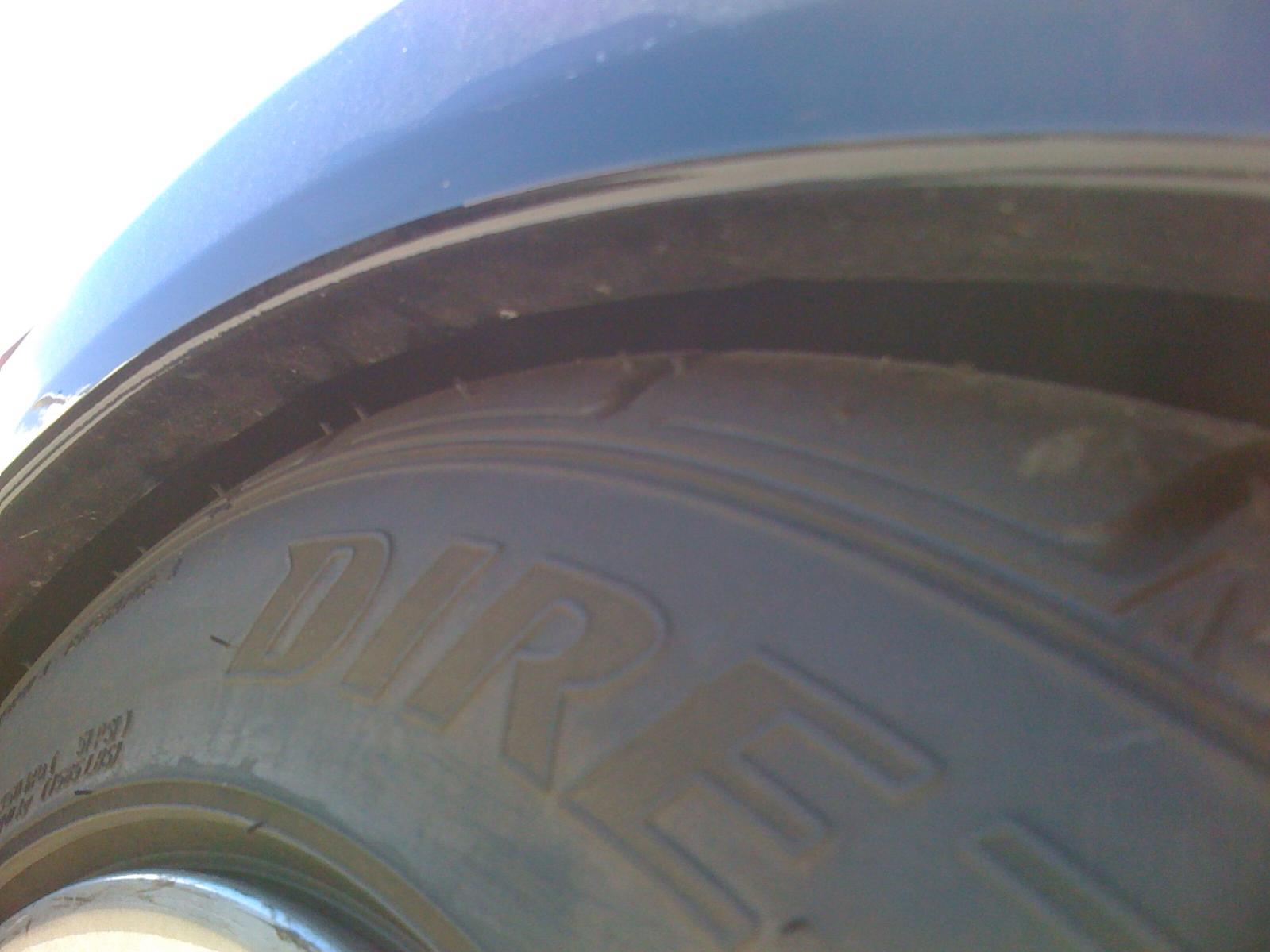

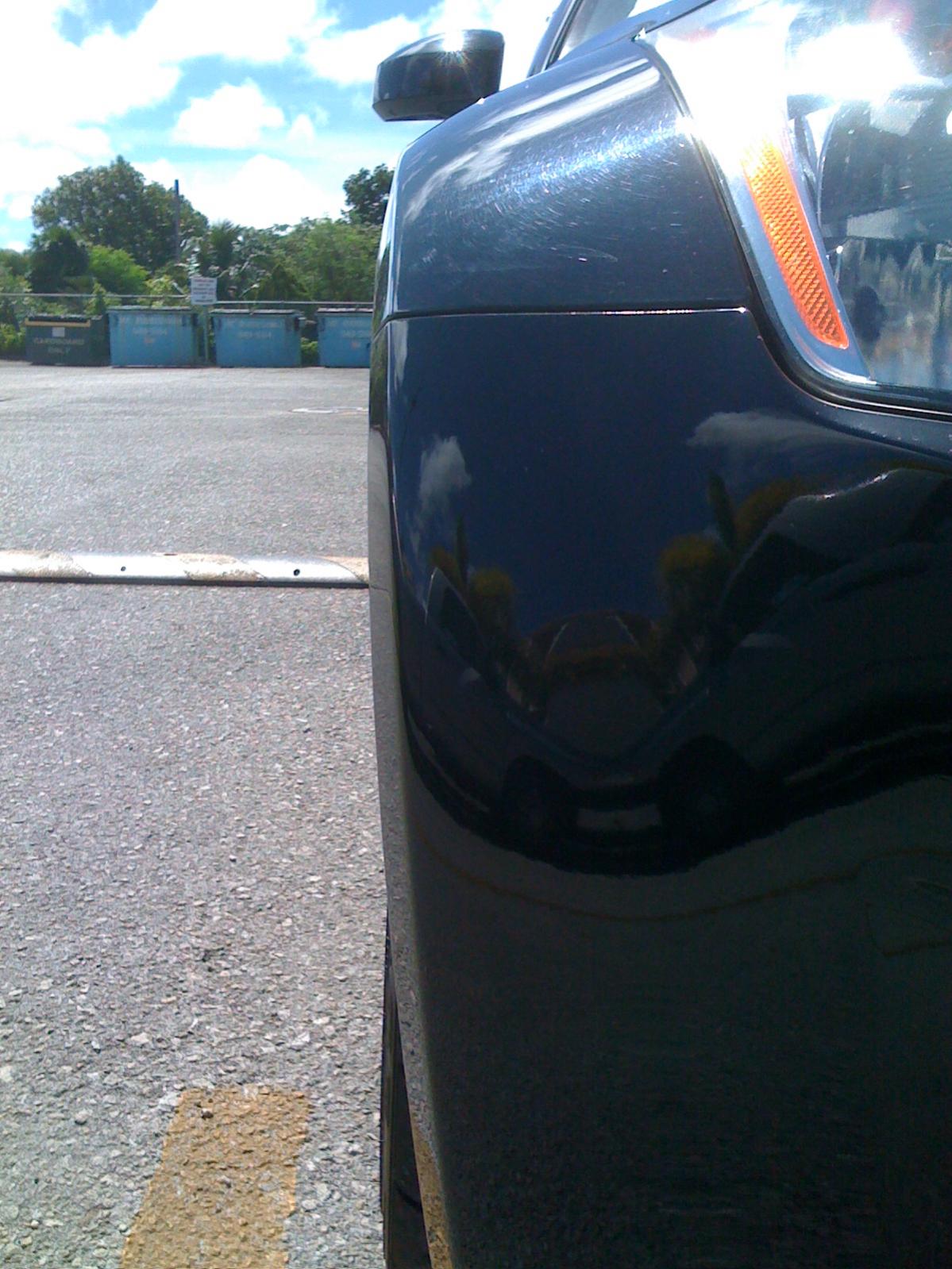

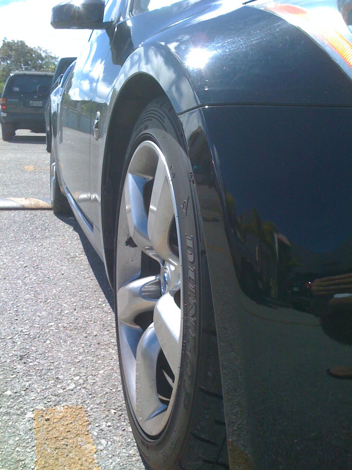

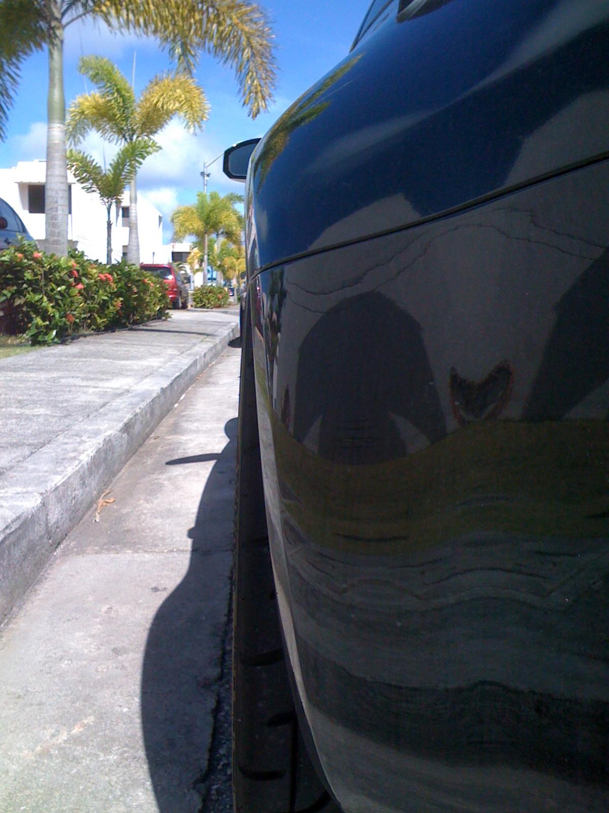

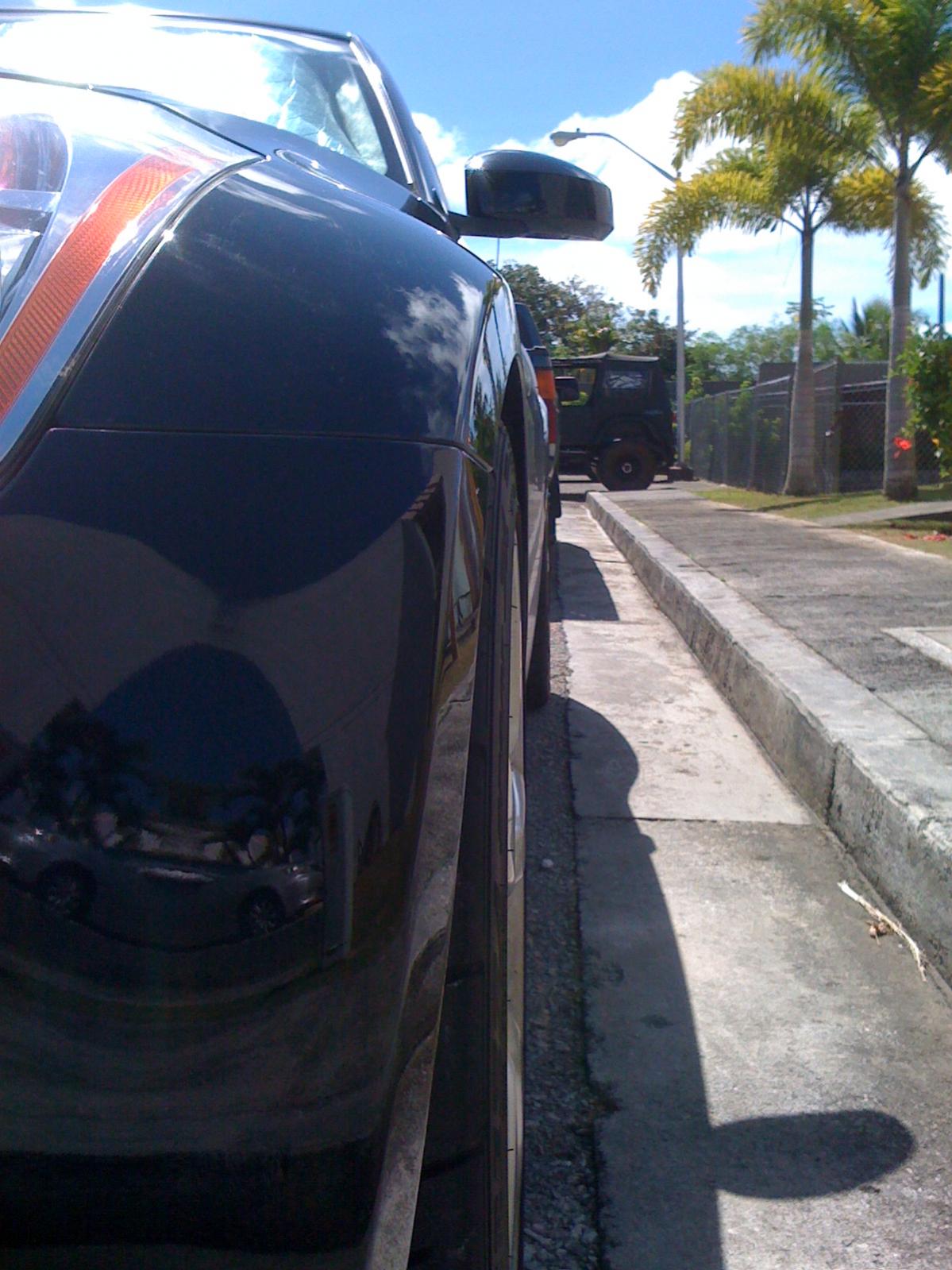

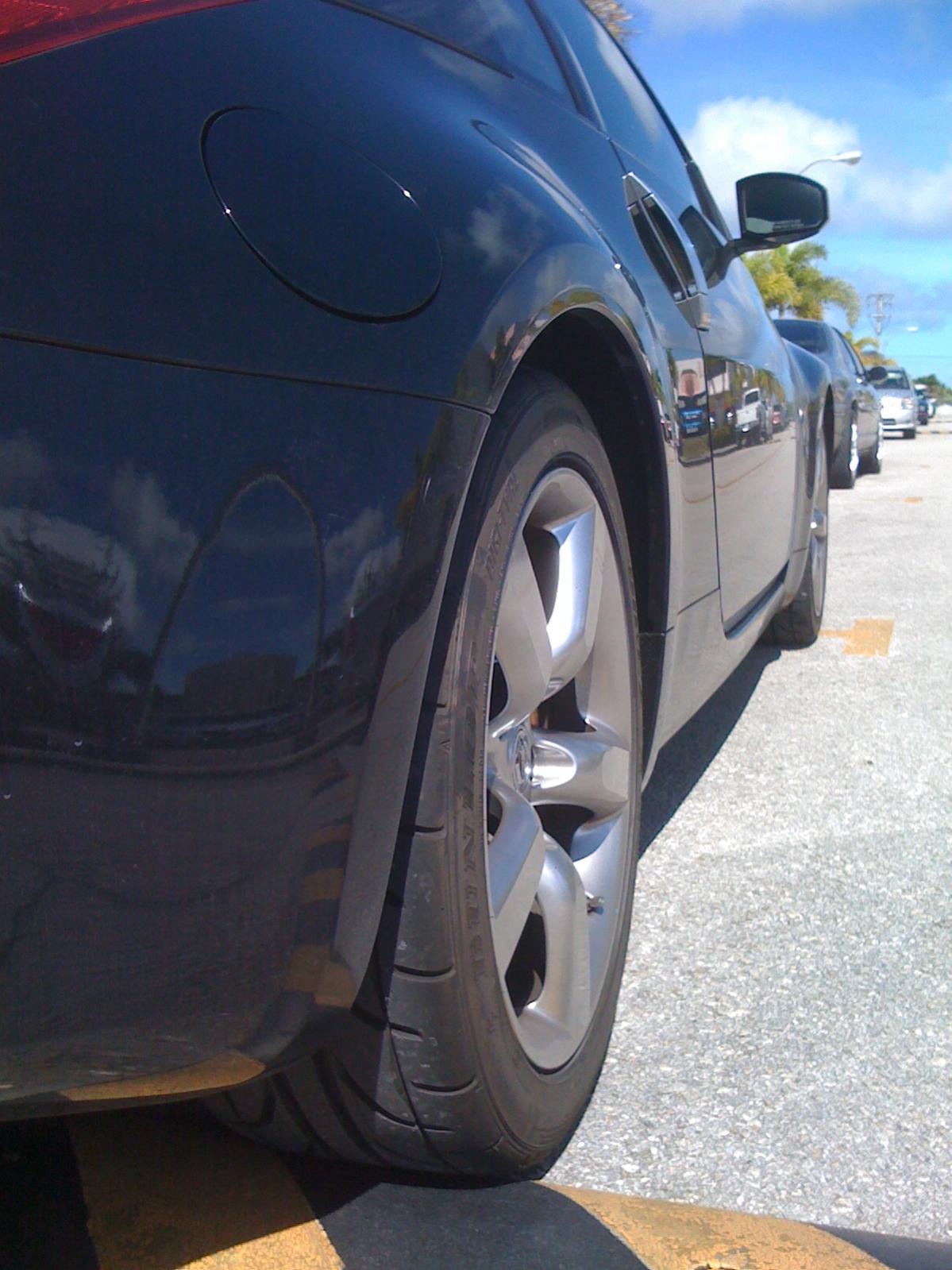

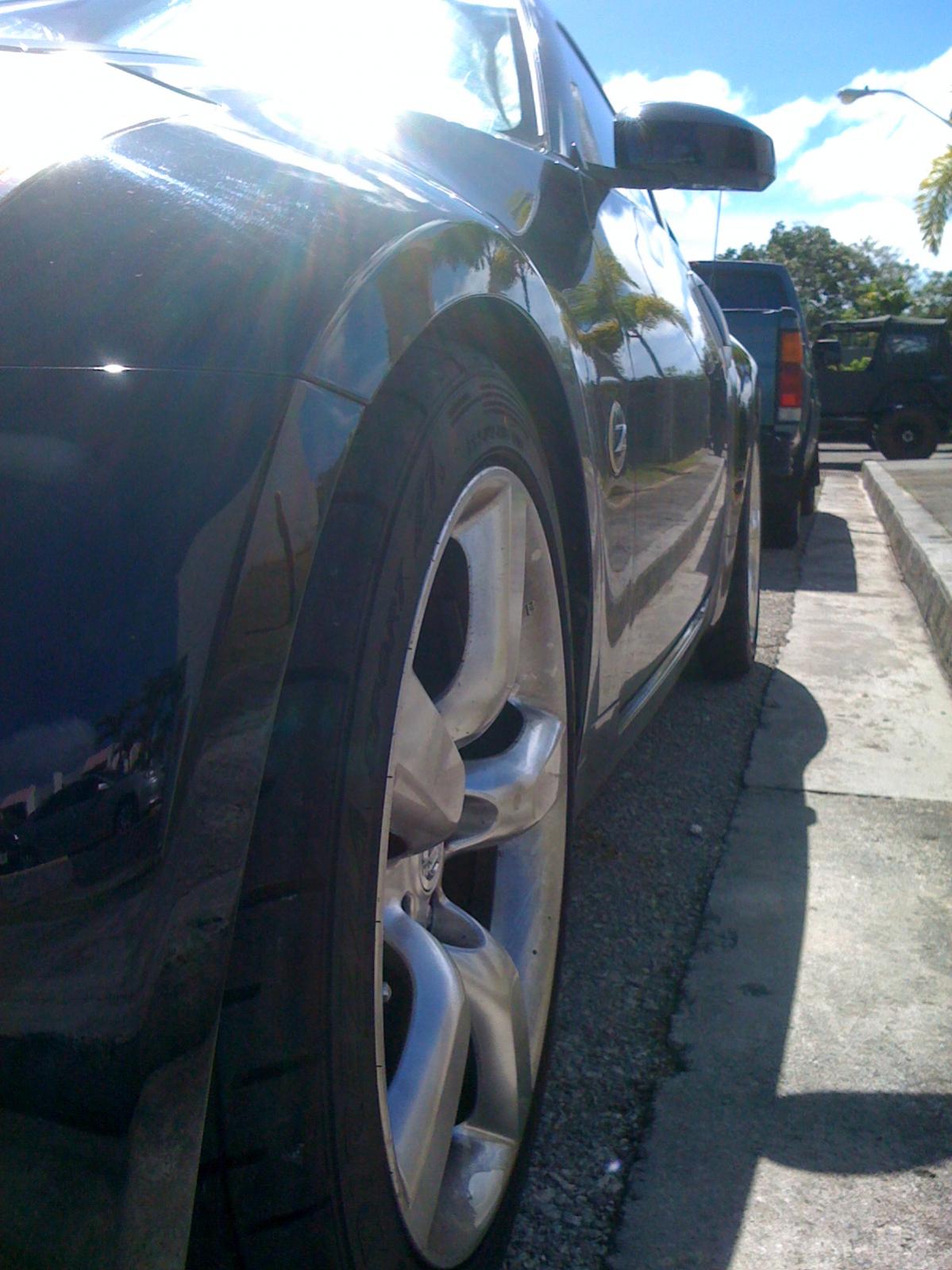

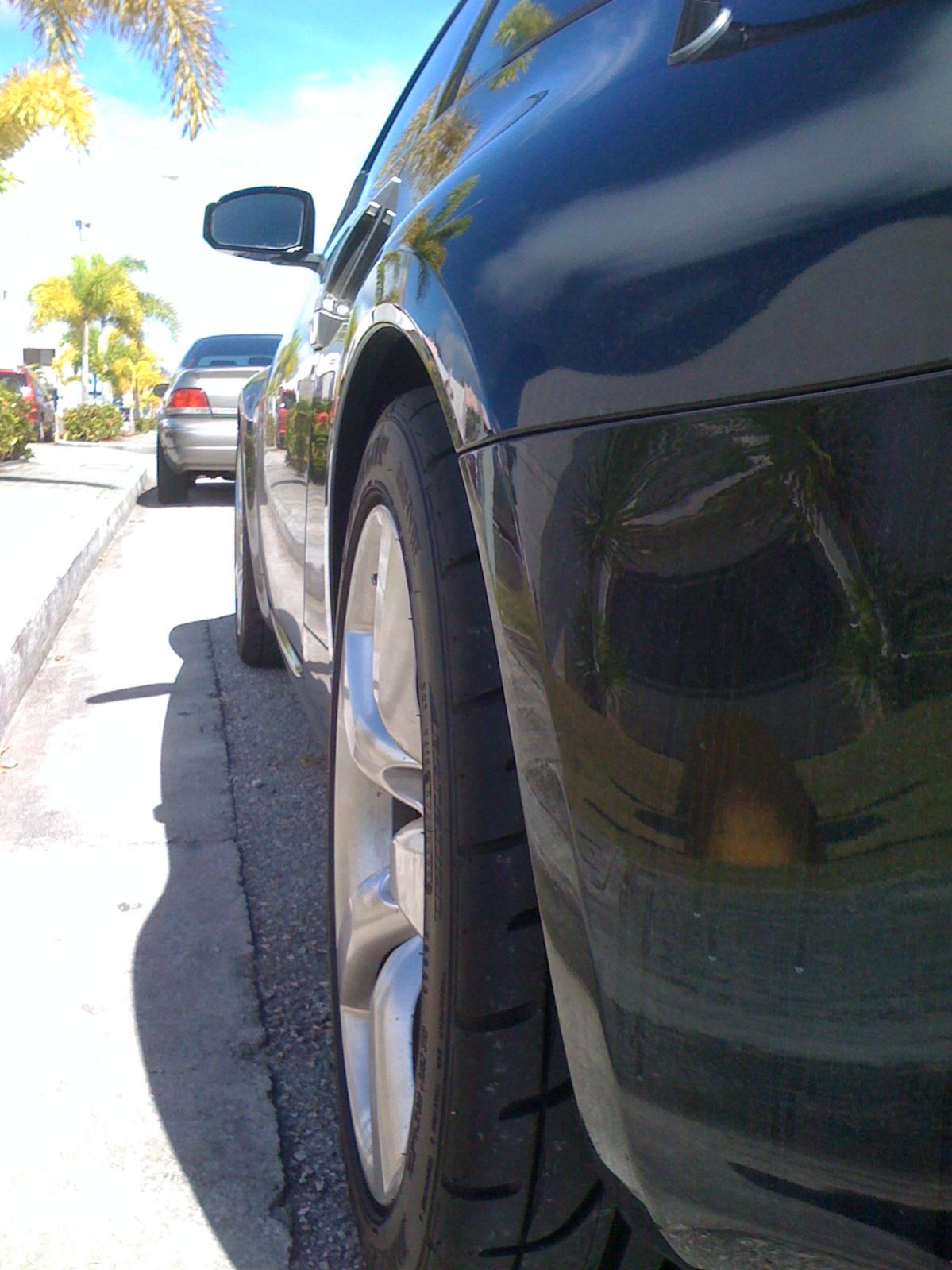

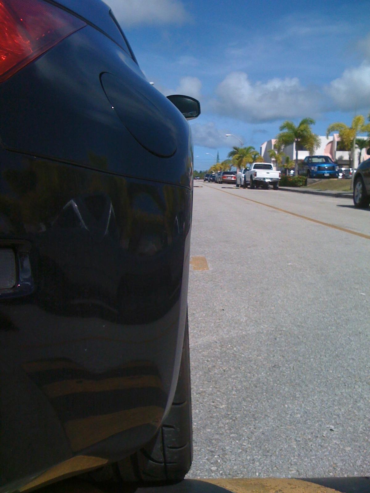

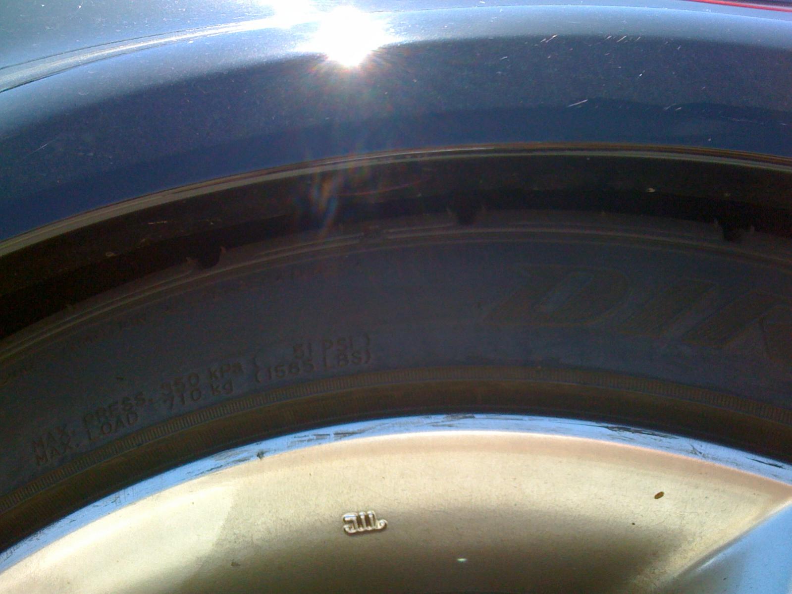

Okay, I finally installed my spacers but I did a little before and after first before completing the work. IMO I probably would just do a 15mm-20mm instead of a 20mm-25mm only because the back looks like it will rub if I drop the car a bit but i will perform the 4X2 wood thing on the rear to confirm this. I'd have to admit that it looks like a nice simple cheap mod to do. The Ichiba's look realy sturdy and can handle the job quite well. The only thing I noticed is the 90ft/lbs of torque for the stud seems not enough but I did 90ft/lbs anyway and will re torque them the next time I do my oil change. Kudos to Jason for a very informative thread.
Rear pics...
Attached Thumbnails FAQ: Official wheel "SPACER" thread!-img_0736.jpg   FAQ: Official wheel "SPACER" thread!-img_0737.jpg   FAQ: Official wheel "SPACER" thread!-img_0738.jpg   FAQ: Official wheel "SPACER" thread!-img_0739.jpg

Front...
Attached Thumbnails FAQ: Official wheel "SPACER" thread!-img_0740.jpg   FAQ: Official wheel "SPACER" thread!-img_0741.jpg   FAQ: Official wheel "SPACER" thread!-img_0742.jpg   FAQ: Official wheel "SPACER" thread!-img_0743.jpg

I don't think the 25mm spacers are recommended for the rear if you are going to do one of the following:
1. The Z is dropped significantly
2. If you are planning to autocross your Z
I probably will try my 20mm spacers for the rear and see what happens or maybe roll the fenders a bit.

Old Jun 1, 2010 | 11:00 PM
  #357
BlackSpec02's Avatar
BlackSpec02
Posts: 2,039
From: San Diego
^ gotta roll the rear fenders.
