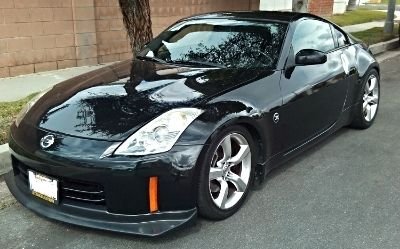

You want your wheels to stick out like this? If so you will need spacers.

It is a matter of taste and what you want your wheel/tire/stance to look like on your car. Spacers allow you to have a more aggressive look with a conservative spec'd wheel. Like sparco said, spacers will push out the wheel further away from the car.
