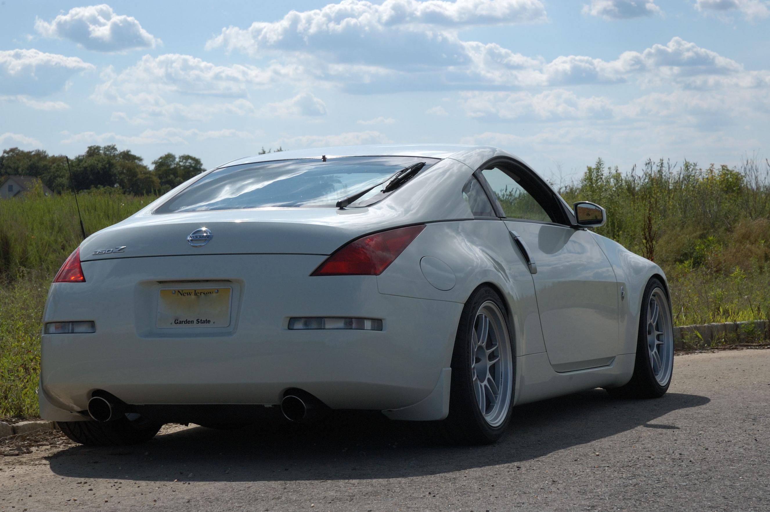

Nothing insanely meaty but definitely no stretch
18x9.5/10.5 +15
285/35 255/35

Clean n simple.. what type of suspension and how much camber are you running?
He posted in the ENKEI wheel thread that he was running -2 degrees camber all around.
18x9.5/10.5 +15
285/35 255/35
Attachment 317658
Very nice! Similar to my setup. Do you have more pics of different angles?
