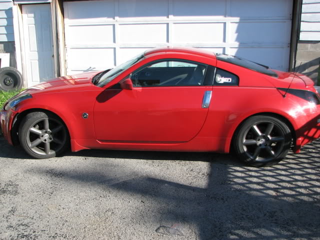

Smile Will this set of OEM rims fit my Z with Brembo?
Thanks guys I look throught Ebay and see the G37 spare for sell at around US$140. but the shipping to Hong Kong is going to be darn US$200. So I guess I will just buy a set of used OEM Z rims with tires here it is the measurement:
OEM 18" 350Z (Gold),Front (Dunlop SPORTMAXX 225/40/18),Back (Goodyear REVSPEC 235/40/18)
I got some photos here in the forum please anyone can tell me if this style can fit my Z with the Brembo setup?
Attached Thumbnails Smallest Wheel size to fit the OEM Brembo Brakes?-dsc00032.jpg   Smallest Wheel size to fit the OEM Brembo Brakes?-img_0964.jpg   Smallest Wheel size to fit the OEM Brembo Brakes?-dsc01408.jpg

Will the above style and size fit my OEM Brembo?

I use some old 2004 350z base model 17 OEM wheels on my race car when the car is in the garage...they fit over the Brembo brakes with no problems at all.
It is my belief that ALL OEM 350z wheels will fit fine on a 350z with Brembos

From: Eastern NC
^^^ correct.
