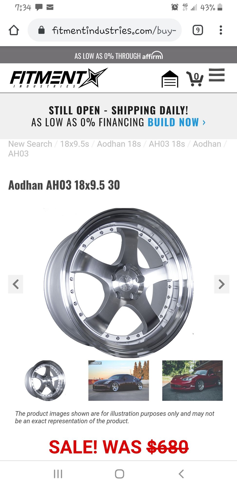

Looking at putting a set of Aodhan Ah03s on the 05 G35 Coupe RWD. I'm worried they will stick out too far, I'm looking to be flush or near flush.
Right now the car is stock ride height but it will most likely be lowered on Tein S Techs or coilovers soon.
Will these fit right? My other option is to go 18x9.5 30mm on all 4 corners.

There are several stickies in the Wheels & Tires section in which you posted this topic that address offset. I suggest reading through these to determine how much offset you need. Tire will also make a big difference on how flush you sit. You can always spacer your way to the offset you want. My guess is you'll need 10mm - 15mm spacers to make those wheels sit flush-ish.

That's correct. Adding spacers effectively lowers your offset. Think of spacers as negative thickness in relation to offset. Using 15mm spacers would be equivalent to subtracting 15mm from your wheel offset.

Tucked in too far is relative. You stated that you wanted fitment close to flush and +30mm won't get you there with this setup. I remember my G looked as though it needed something near +5mm to get flush with 10.5" wide wheels, particularly in the rear. I think they can tolerate lower offset than the Z, but don't quote me on that.
Typically with the Z +15mm on 10.5" wide wheels with appropriately sized tires will get you near flush once lowered. Here is my car with 10.5" wide, +18mm wheels with 285/35 tires on all four corners (pre-alignment). It sits as flush as I'd like, though I'm sure I could spacer it further if I wanted. I do run a bit of camber now since this is basically my track car, so take that for what it's worth.
