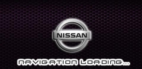

Nice Burner! I tried creating a nissan loading screen, 480x234 as a bmp, but it caused an error... also when I try to look at the default loading image i get an error in windows xp...
did you do anything special to create the .bmp loading image?

06blueZ's Avatar
06blueZ
Posts: 899
From: St. Louis
Attached Thumbnails My 0 like OEM fit NAVIGATION setup-lunapic-125309468857570.jpg
You have to edit the "branding.zip" file....you don't have to touch the "data.zip" file. Open up "branding.zip" (without uncompressing), copy your loading.bmp image (overwrite the old one) and close out. When you copy the file (Windows Vista or newer, I was using Windows 7) it will recompress it automatically. Copy that to the SD card and it should work. Make sure you only change the loading.bmp file in the 480_234 folder.
