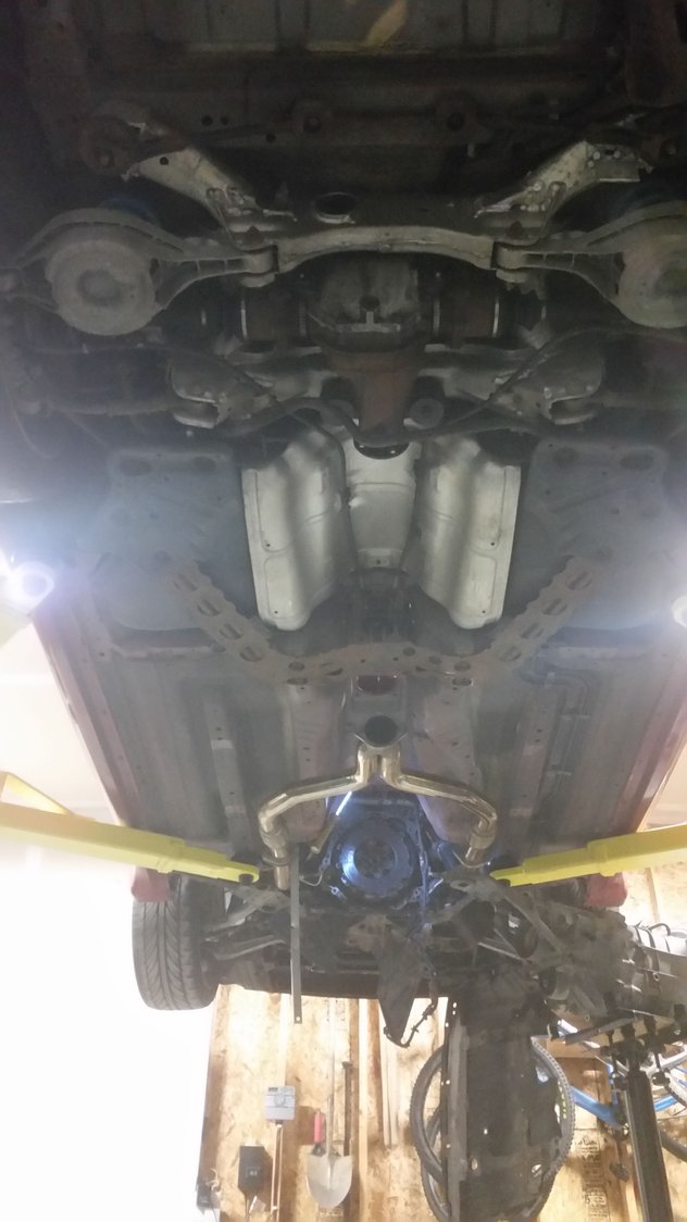

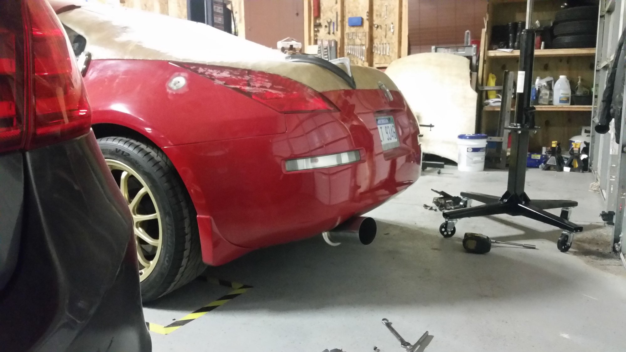

Flywheel and exhaust complete.

Sweet. I'm sure the new lift has you loving life. I like the outlines for the wheel positions.

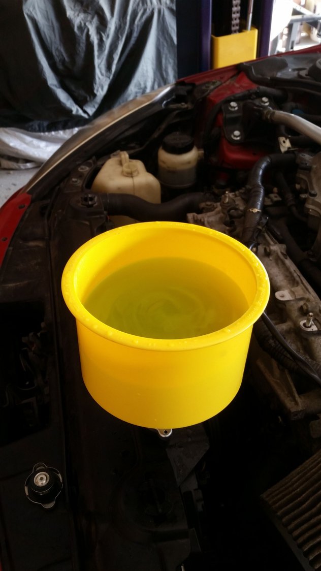

Im having trouble bleeding the coolant system and ive just about everything I could think of... anyone have any ideas?
Few notes: Heater core removed, bleeder screw also removed.
Topped the radiator off, inserted my Lisle spill free funnel, put a little bit of fluid in there, let the car get up to temp and let the thermostat go through a few cycles... when the thermostat opens the funnel goes from almost empty to almost full! This is a huge funnel... the fluid doesnt re-enter the system until you turn the car off, at which point the funnel drains back to almost empty. The temperature gauge stay constant during this process. You can hear and feel in the car a water hammer effect in the coolant system. I put the radiator cap back on just to see what happens and the coolant temp started going up above normal so I shut it down... with the cap still on and the car off you can hear the system slurping and pushing the fluid/air around.... im at a loss on how to bleed the system properly. Dont want to overheat it! Anyone thoughts?

If you have a blanking cap on the rear pipe behind the engine you may try popping that off , you setup it a bit different than mine. I use my heater hose bleeder to help get the air out.

When car is warm
When fans turn on it fills up all the way! <br/>When car is turned off it drains bsck down to image 1

I think i figured out whats going on but I dont know how to fix it... the water pump feed line is cold which means its not flowing anything... with the cap on the coolant is just getting dumped into the reservoir... the slurping noise when i turn the car off is the coolant being sucked back into the heads by the vacuum pressure (coolant was being pushed out and replaced with nothing). So either there is air being sucked in somewhere or the T-stat is stuck closed.

In that whole process you got rid of the heater line bleed port didnt you? If I remember my VQ's right, that was the highest point to bleed air out. You may have an engine that has no way to bleed air out of the block and is air locked.
Thermostat replacement shouldn't be too bad. can you try and use some sort of electric pump to push water through the block? if you rig it to your radiator inlet and return lines you both clear air out if its flow is enough and also prove or disprove a blockage.
Yes the bleed valve is gone, but by removing that line I made the cap highest point in system. I also removed one of the plugs while filling it to get air out... the return circuit is full of coolant... the feed circuit is what isn't filled... I like your idea of pumping it through, gotta figure it out...

It could be thermal air expansion, if air is trapped behind the thermostat it can happen. Ran into a similar issue when i first started modding my cooling system. I found if you refer to the TSM, it says to fill the system slowly to allow the air to escape. Pouring a little at a time and very slowly seems to help get the system topped of. I don't use a spill free. Since you don't have the bleed port on "A" heater hose. I wonder if you still have a hose bunge on the rear pipe above the trans that you can uncap to purge air as you fill.
The good thing about a simple cooling system like yours is that a couple cycles of the thermostat should pushing the air out on its own through the resevoir. I had actually at one point thought about putting a air bleed valve on the heater pipe that you had blocked off so all the air from behind the thermostat can be manually purged alot easier. Might be an idea for you. I was thinking of one of those pull valves that they install on air compressors that are spring loaded so you can pull on it till you see coolant then release.
