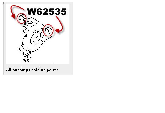

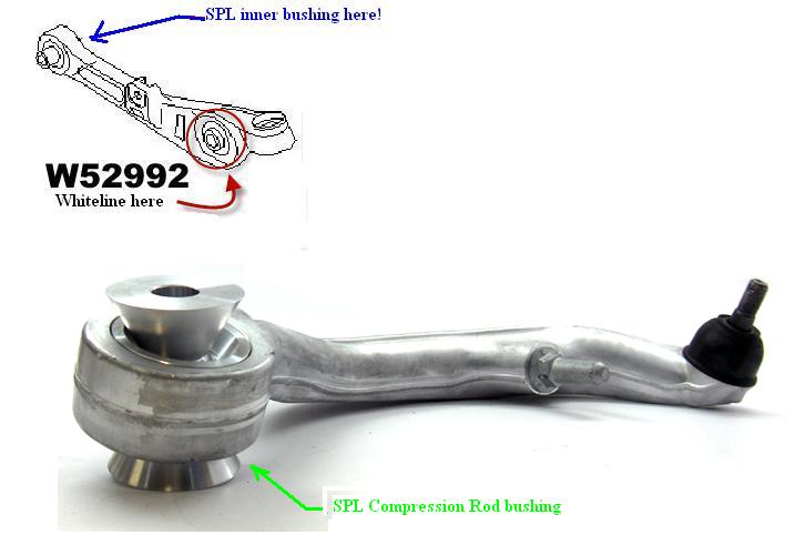

SUSPENSION RELATED:
Originally Posted by JasonZ-YA
quick answer:
Front:
1. SPL compression rod bushing ~ $157
2. SPL inner translink bushing - at k member location ~ 1
3. translink shock mount - whiteline or spl, no biggy there.
REASON:
Notice that the two points that connect the wheel to the chassis are items #1 and #2 -- so, its not recommended that you have solid at the compression arm and rubber (whiteline) at the translink, ie....a whiteline rubber bushing there will have friction coeffiecient much higher than at the solid (bearing designed) SPL compression rod location.
Any suspension movement would have to over come this friction for the Transverse link location to begin travel....thus changing the suspension arm at the bottom slightly.
Now remember, theres nothing wrong with doing whiteline at item #2, but its not optimal is all....still a very great improvement over stock for sure!!
Upper control arm - something after market that meets your needs, budget.
Ideally the same thing applies here..........
if you have solid chassis mount points at the lower arms then optimally you would go with arms like SPL's front upper control arms - becuase they use machined rod ends at the chassis tower mount (caster adjustment) location.
see here in blue:
arms like the 350evo or Esprit arms that have rod end solid chassis mount points.
at the very least, get arms that have a metal SLEEVE in them like the kinetics arms:
Rear:
1. only one to really watch is the rear shock to spindle mount bushing.
2. radius rod, replace with rod end styled arm like SPL.
REASON: Due to item#1 being the shock mount location, especially on true coilovers, this location gets beat up, off-centered and in time can show cracking/tears in it.....
the other bushings in the rear spindle as small.....and have very minimal articulation that oem rubber is fine for the most part.
Item 1 - Shock mount bushing just use whiteline. SPL's would be nice, but ive only seen Import parts pro sell it separately.
Item 2 - Radius rod bushing is large, and during launches can deform.....replacing with solid rod end style arms like SPL, battle version, etc would eliminate this and ensure the rear suspension geometry doesn't change under loading.
2. depending on car use, subframe bushings - whiteline
Reason - Whiteline subframe rear bushings i feel wont be utilized till your on the track frequently......no point in doing all that work on a street driven car......the oem bushings dont tear, but they are soft......so you can go with out replacing them if your not a track *****...
Solid subframe bushings (if wanted) can be fabricated easily from any local machine shop.
see some solid ones here:
https://my350z.com/forum/autocross-r...verything.html
-J
SUSPENSION RELATED:
REASON:
see here in blue:
