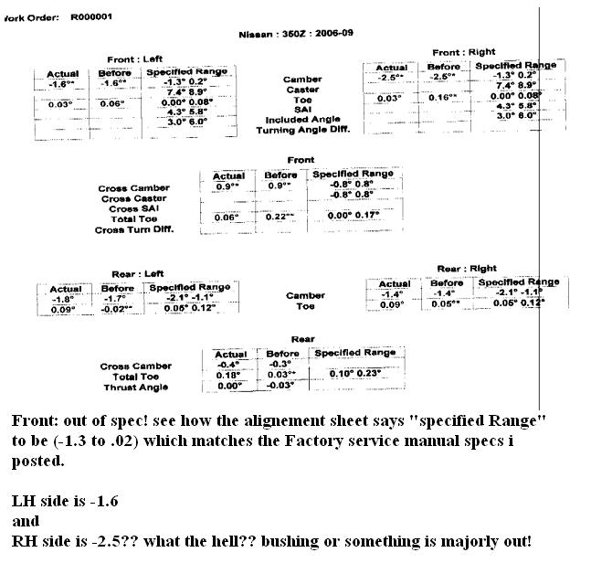

Originally Posted by dpotter
Ok Jason, I had them put it back on the rack today and get me a print out.
Tell me what you see.
Keep in mind I do have the Eibach front and rear camber kits installed.
Attachment 305056
oh man, your front right is way out! It must be a RH side torn transverse link bushing or compression rod bushings, or both........ and if its determined that they are, i wouldnt bother with another alignment till you got them replaced.
Both front and rear toe is fine, as its in spec per the range.
REAR:
your rear camber isn't matching...
LH is -1.8
RH is -1.4
also, for whatever reason, they didnt record your front caster.......the range is shown, but the caster figure for your car is blank???? that can help determine if your compression rod bushing is out, but ill bet it is anyways, so no point really knowing...
I would call this an all around horrible alignment...sorry...
-J

Jason,
Thanks for taking a look and explaining it to me. Sadly these guys are considered to be the best in town. I guess I'm in trouble and better start shopping for a much better alignment shop that knows what the @#$& they are doing. This is disapointing. The alignment was even worse as you will see on the on the prior adjustments and get this. They aligned the car with the factory wheels on it after the drop and then I made them re-align it after I had the new wheels and tires put on so the current alignment did improve significantly with the new wheels and tires in a couple of areas, or at least closer to specs.
Thanks again for your feedback.

^ no problem man,
ya but i would definitely take a look at your RH side......odds are your bushings are gone.....
It may actually be both sides, but as you drove it up on the rack, or turned into the bay, or whatever it was, may have caused the bushings to tweak that the RH side was worse than the left.....
when you have torn bushings, you can get an alignment like that....remove the car from the rack, drive around the parking lot, get back on the rack and it will be completely different that 2 minutes ago!! If you have busted up bushings, doing alignments is pointless so i would look at getting the two front problem child bushings replaced for sure.
https://my350z.com/forum/brakes-and-...ight=translink
https://my350z.com/forum/brakes-and-...g-install.html
-J
