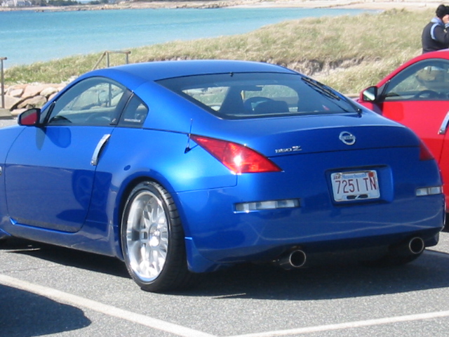

I'm debateing wether I should go with the tein basic dampner or just and koni shocks to my eibach setup. Can anybody give me some suggestions on what to do. I just want to get rid of the bounce and it doesn't handle as good as I want it too. What are the best sway bars to go with? I was thinking cusco!

I hae no clue about the shocks but you have a good height going with those eibachs. What size wheels and any rubbage?

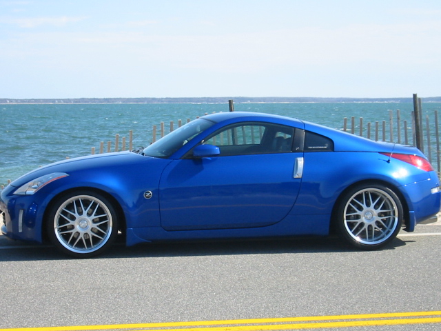

The height is great, but the ride is s***. I have 19x9 on the front and 19x10.5 in the rear with 245/35/19 front and 285/30/19 rear.

Looks great! I ll be getting sway bars but that doesn't affect the smoothness of the ride does it?
