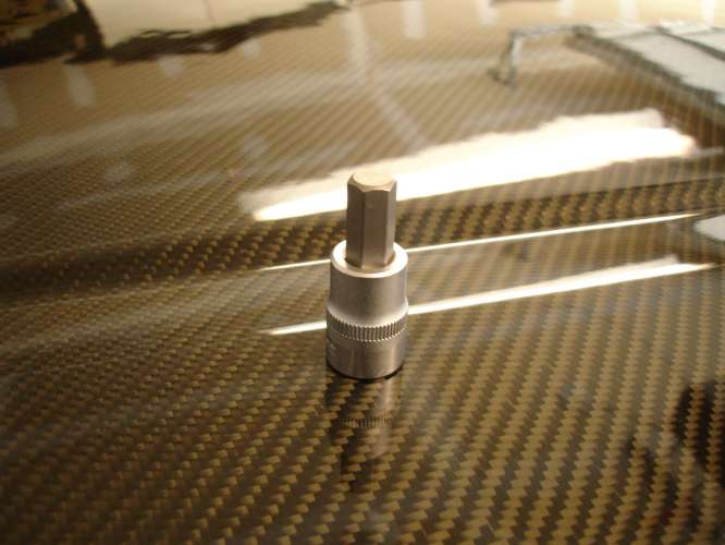

Manual transmission is M18x1.5
Maybe they are the same for an auto????
Isn't the drain plug a 10mm hex key, not a hex head?
-J

Nope there is big 'ol pan with a hex bolt in it. The 5AT holds 10 qts of fluid!

Really appreciate your replies...and it is an external hexagon. Don't know what size wrench is required, but that won't be a problem. The problem is not knowing what size millimeter diameter and pitch magnetic drain plug to order, BEFORE I drop the pan. In addition to cleaning the inside of the pan, I will be adding a Magnefine filter and removing the pan magnet(s). That's why I want a magnetic plug, i.e., so I don't have to remove the pan every time I change the ATF. With a magnet in the drain plug, in the Magnefine filter, and by using Red Line 100% synthetic ester ATF, the ATF will remain cleaner, not accumulate much crap in the bottom of the pan, so I won't have to remove the pan again. Thanks!
