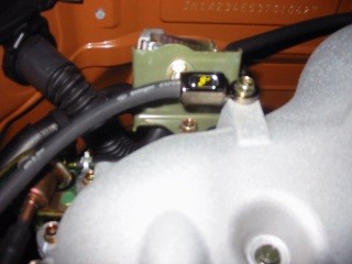

Stinger expert ring installed.
Attached Thumbnails Custom Engine Grounding/Earthing Kit-expert-ring.jpg

^^^^what is that pic ^^^^

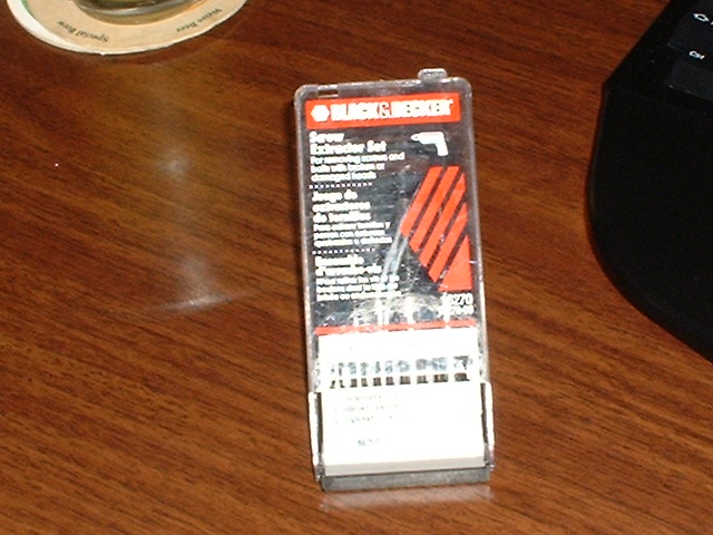

Default Black & Decker Screw Extractor
Time for the ole Black & Decker Screw Extractor Set. Found at your local Home Depot or Lowe's for under $10.
Center drill the broken bolt as best you can with a small drill bit. Start SLOW! Widen the hole if necessary. Use the screw extrator to remove the broken bolt.
The screw extractor has a reverse thread on the tip so, as you tunr the tool in the normal direction to remove the screw, the tool "bites" into the broken bolt and pulls it out.
In theory, mind you!!!
I broke a stud on my MR2 Turbo's header! Talk about a pain in the rump.
Attached Thumbnails Custom Engine Grounding/Earthing Kit-dscf0013.jpg
