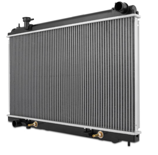

All aluminum with built-in transmission cooler ???, Any part # or Link please ?
This is the only one from mishimoto with trans cooler, link

youre on the wrong item. says OEM replacement.
they sell OEM and racing versions. I would call them to make sure it has the trans cooler though. I have a G35 and mine had it, but they make revisions so even mine was different from what they had shown but revised to be better.
edit: according to Z1's website it says no auto cooler for 350z model. I would say use a g35 radiator or add a trans cooler with inline thermostat to maintain the temp.
http://www.mishimoto.com/nissan-350z...diator-03.html
