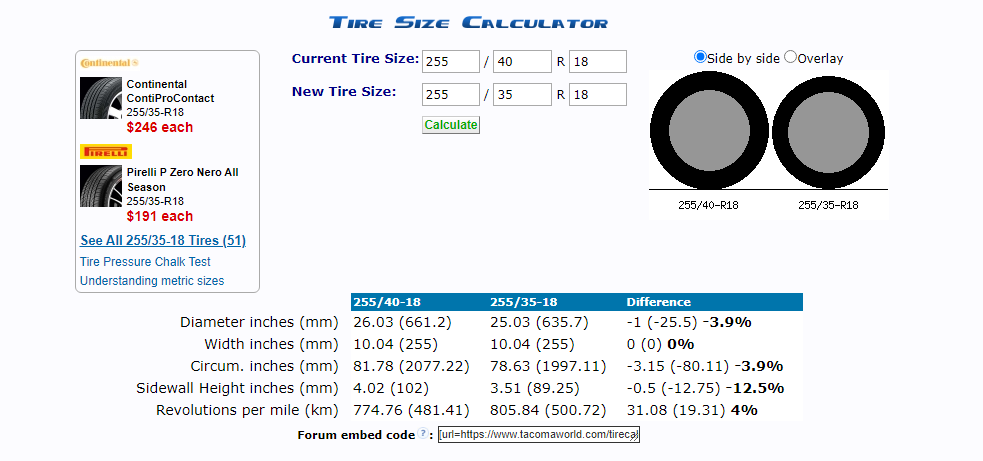

rears are too short,
thats a cool tool. I mean i knew they werent ideal. I was just trying to get by on something cheap and avail, until i do tires and suspension. Im kind of confused that heel said the issue i was talking about in rain, must be tires. It doesnt feel like tires, and has happened with all the different tires ive used. Even when no difference in size.
its either wait til round 1, and get good tires then too. Or
just do rear camber arms and fucas, sooner. and schedule the special alignment sooner(and do it again later with bushings soon)
the first option i also have a choice of buying one more set of used tires for rear, or buying 2 new tires and a normal alignment. So i can make it to round 1..

ideally 275/40 in rear... depending on what wheels you have
https://www.tacomaworld.com/tirecalc
I would like 275 in rear because i figured it would offer ideal track performance. Will wait to change wheels, with more important issues in the forefront. Idk what size my wheels are it doesnt say on them. all i know, is they came with 255,40,18 on all tires, and it looked pretty normal.

In order to get your suspension to BASELINE, before anything else, you need to:
1. Install adjustable front upper control arms
2. Install rear adjustable camber and traction arms
3. Install properly sized tires
4. Get an alignment
You should do steps 1-3 (in whatever order but at the same time) and then step 4.
I don't remember what your wheel specs are, but they will likely be stamped on the inside of the barrel or behind one of the spokes.
Stock staggered size is 225/45/18 in the front on an 18x8 wheel with a +30 offset. Rear is 245/45/18 with +33 on an 18x18.5 wheel. Enter that information in one of the many wheel/tire calculator tools widely available. I like this one: https://www.wheel-size.com/calc/
Then, enter the new specs for your new wheels and whatever tire is available at your dollar general thrift shop used tire shop that you seem to like and see if the overall diameter is 3% difference or less in order to keep TCS/VDC happy.
