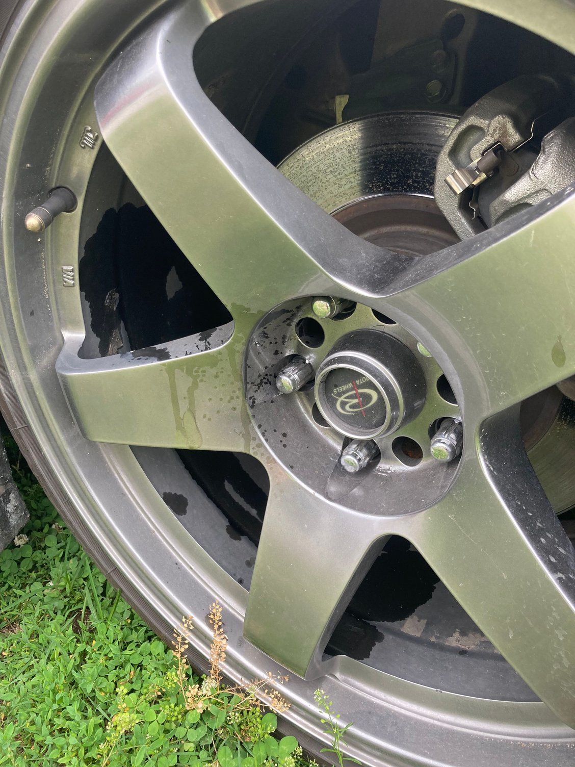

edit: may be brakes or wheel bearing or something.. I just noticed my rim had crap all over it. something was definitely wrong last time i drove.
thats front passenger wheel

Originally Posted by luv350sass
no kidding... especially since i checked the oil, and it was below minimum! i thought it was running a little rough last time.. its hard to check this dipstick sometimes, but last time i thought it was halfway between min and max.
if the engine goes with the new loan im screwed. Def not burning the house down. If it gets too bad ill try to get a damn scooter for work or something lol. My shop is on their annual vacation next week too! When my trans and clutch arrives, and rental expensive.
That looks like brake fluid. Probably too late now, but that will destroy the finish on your rim. Also, get that checked immediately. Leaking brake fluid is a problem that can literally kill you.
Dayam, those rotors ever been replaced? Your brakes are f'd up. Look at that pitting and the ridge. I'd wager if you mic'd that, they'd be waaaay under tolerance. Jeebus, pay attention to some details, how about it? "Baseline" applies to brakes too! You don't listen to shid and this stuff just gets more unbelievable as time goes on. Soooooo tempted to lock this thread for the reason below.

and thanks ia8. Im not missing much brake fluid out of resevoir, thought it may be hydraulic fluid or something else if brakes even have those lol. about to wipe rims down now.
what did i ask again mic? I also have been listening to the advice. I only have so much money. The brakes were going to be after tune, but looks like theyre now. I dont know how to recognize how bad the brakes are, but i could tell they were not ideal. im wondering what else i need other than a brake kit for brakes, but im sure the shop will tell me
Im in a bad spot right now, because my shop is going on vacation next week. Im in a rental thats 300 a week. Its eating up all the money i need for the car. I wanted real nice brakes, but may get powerstop z26 street warrior drilled and slotted. I had them on a different car, werent too bad. Im open to other suggestions, but cant break the bank this time. The z1 non-brembo kit looks okay.
about the only thing i didnt listen to, was i got my nice race bushings with the loan i just got. I still feel the suspension is more than out of alignment and want it fully baselined bad. I thought the clutch went out, i could hear rotational scraping noises more in neutral than in gear. If its brakes, i will save my money for clutch and trans, and just do brakes. Hopefully i can do suspension before clutch and trans, but i do think the clutch may be whats killing the idle occasionally. My shop said they heard the throwout bearing.
both brake an clutch use brake fluid. if i were you, i would pull the wheel off and look at the brake line
Check you clutch reservoir level too. A leaking clutch line may also be the cause of your clutch going out. If it leaks fluid when you depress the clutch pedal, that will cause the clutch to not fully disengage, causing rough shifting and excessive wear. If it's leaking, replace it with a stainless line.

Clutch and brake fluid reservoir are on the driver's side. That pic shows fluid all over the passenger side wheel. I'm guessing it's the brake line to that caliper, but who knows at this point. This is just one disaster after another.
