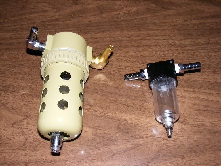

Heres two I made. Small one, and also a larger metal one because I realized I had an extra air/water filter in the garage.

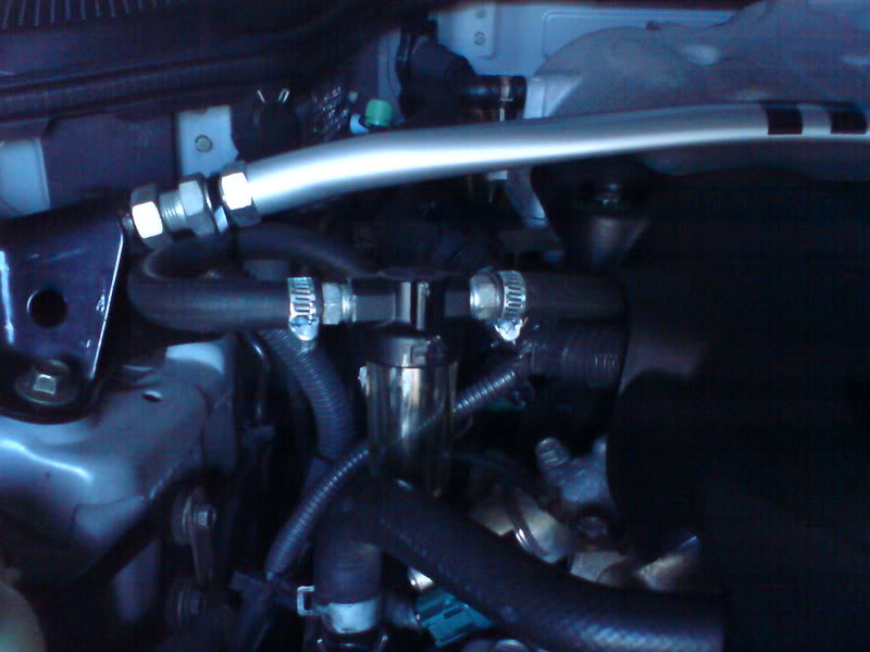

here is mine, has been done for a while but I snapped a few shots while cleaning my filter.

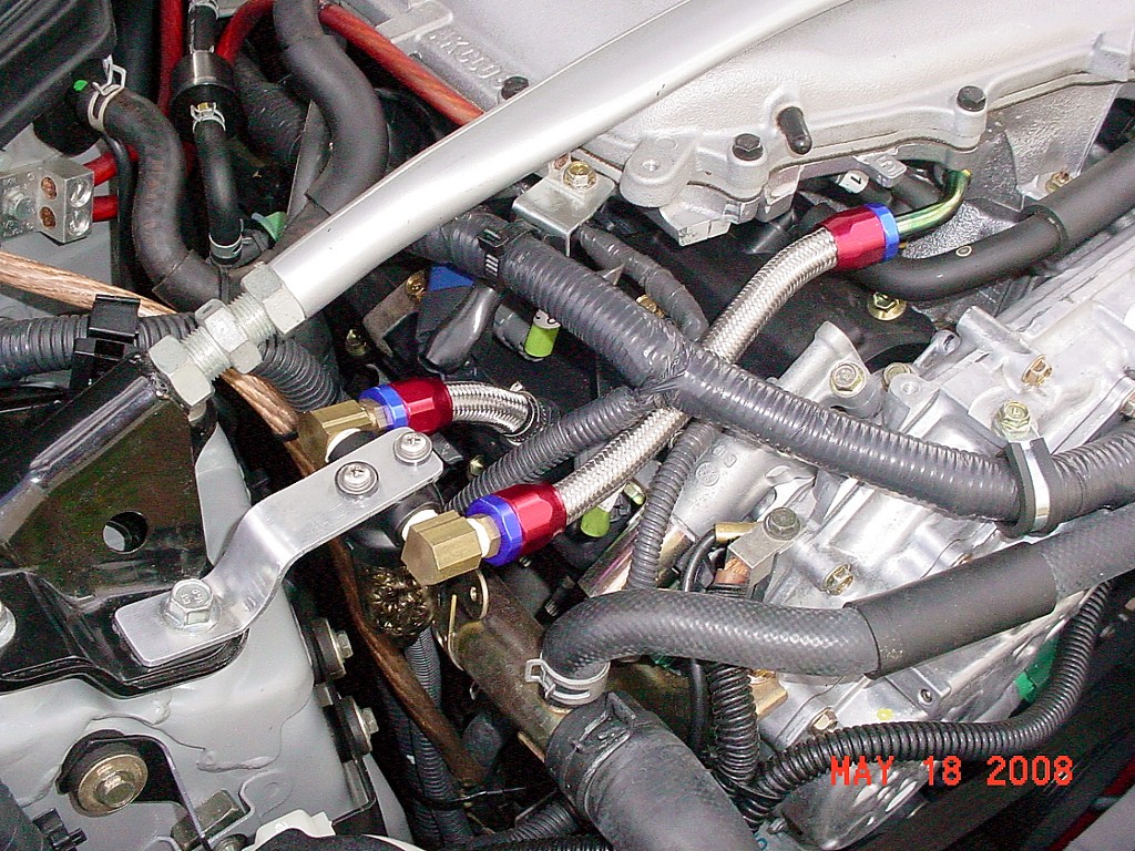

Was bored today... Fabbed up a bracket and switched to stainless hose with anodized fittings. I've been running this catchcan with stainless mesh for about a year. Totally happy with it. I cracked open my plenum last weekend just to see how well this catchcan has worked over the last year, and it was spotless. :-)
Attached Thumbnails Homemade Catch Can-dsc02359.jpg   Homemade Catch Can-dsc02361.jpg
