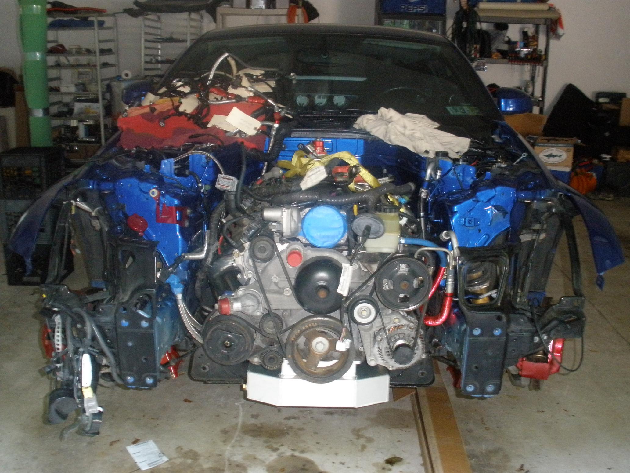

Is this how other are installing the Sikky PS kit? Seems like it would get mighty hot from the header.
...and the fuel system is nearly done!
Not sure if this is an LS1 vs LS2 issue, but my alternator is below the PS pump, not the way its shown in your pic. Also, my PS pump mounts with the line on the top at the drivers side.
https://my350z.com/forum/9287926-post122.html
https://my350z.com/forum/9284721-post99.html
https://my350z.com/forum/attachments...d-p7141823.jpg
https://my350z.com/forum/9265270-post55.html
https://my350z.com/forum/9265323-post57.html
Hope that helps.

From: KC
Well crap. Thanks cass. I'm sure Sikky didn't know that either , lol

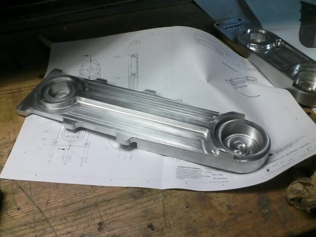

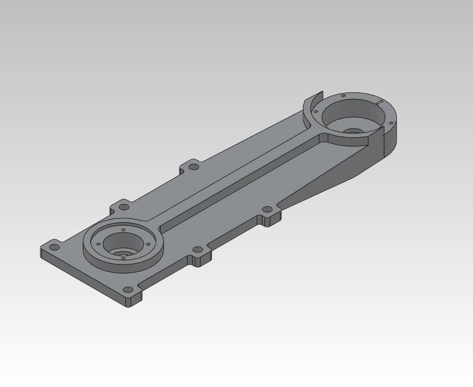

Here's a sneak peak at a shifter housing I've designed. Here's a pic from SolidWorks:
It is for the T56 Magnum and will uses the guts from the sikky shifter if you've already purchased it. Sorry for the cell pic:
There's a still a little more work to be done but I got all gigidy when I saw it today.
