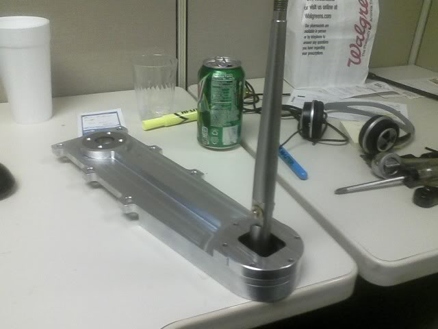

The machine work is done! The guts from the sikky shifter appear to fit. I'm going to do a test fit tonight to see how much, if any tunnel work will need to be done.
...another crappy cell pic. I'll get some with my actual camera tonight.

Old Oct 20, 2011 | 11:20 AM
  #345
bbs350z's Avatar
bbs350z
iTrader: (85)
Posts: 6,662
From: Scottsdale AZ
Jesus that thing is a beast!
