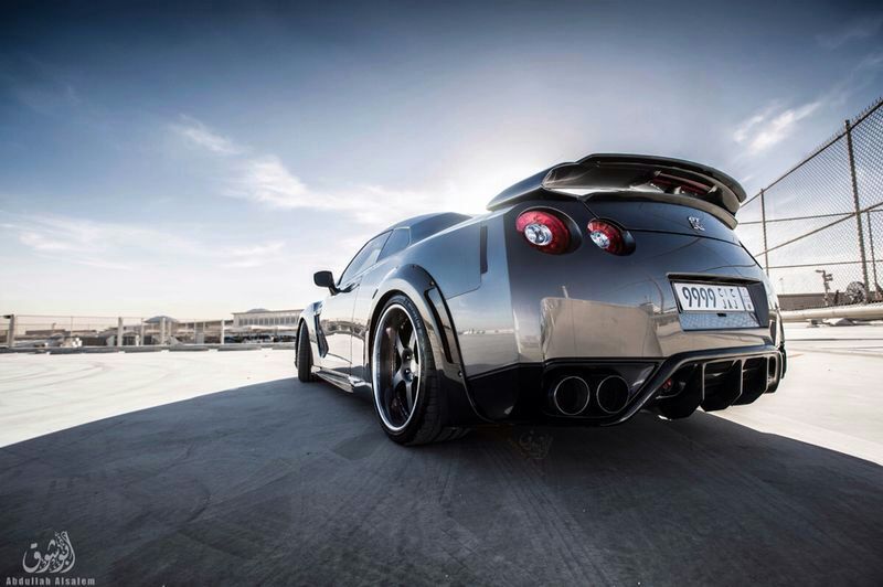

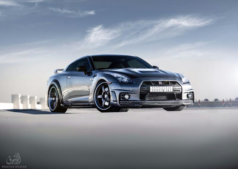

A sneak peek of my friend's ~1200whp GTR.
Attached Thumbnails My 2JZ-GTE VVTI swap thread.-img-20140126-wa0000.jpg   My 2JZ-GTE VVTI swap thread.-img-20140127-wa0000.jpg
