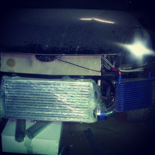

I have not updated this in awhile.
A sneek peak for now:

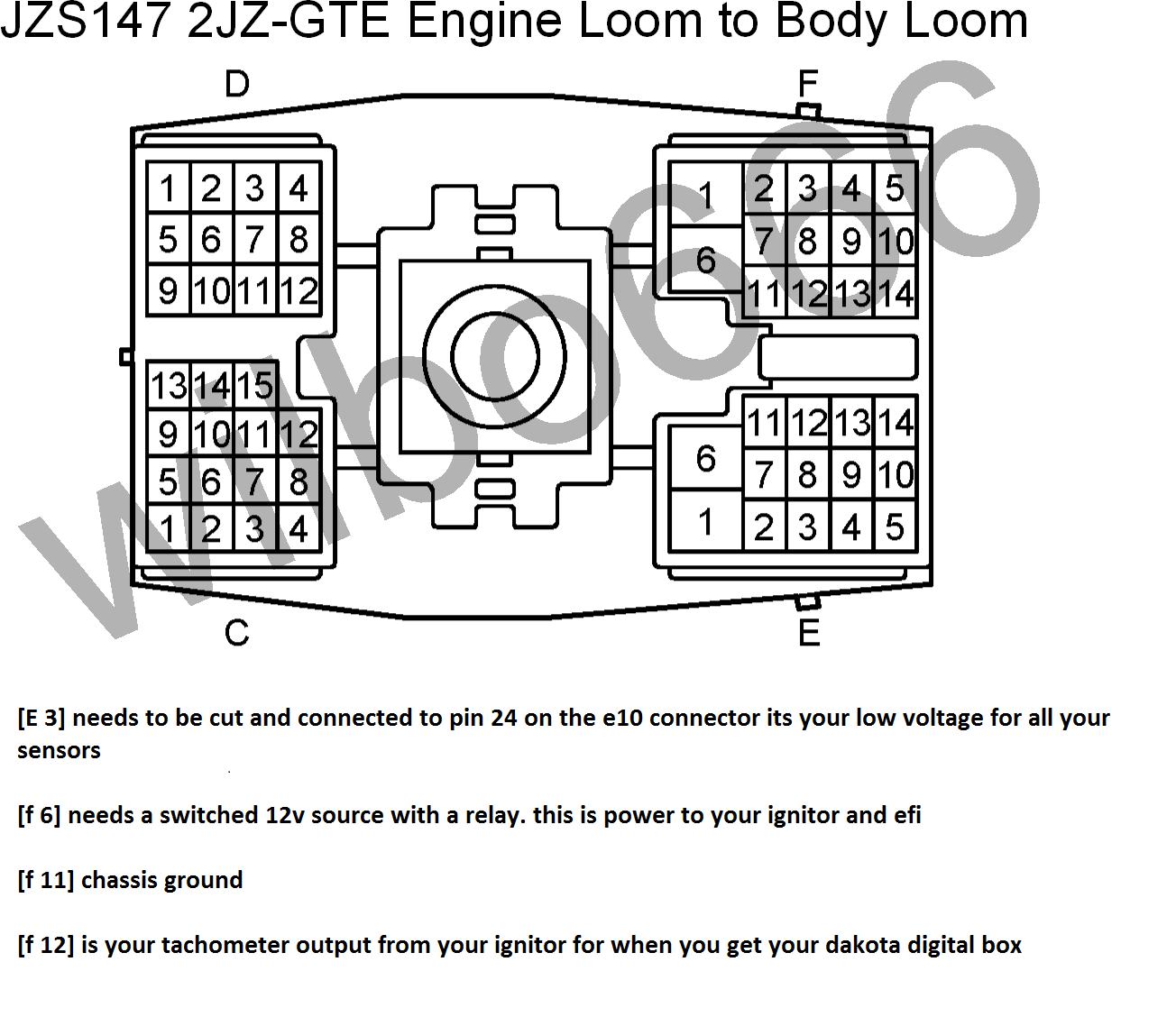

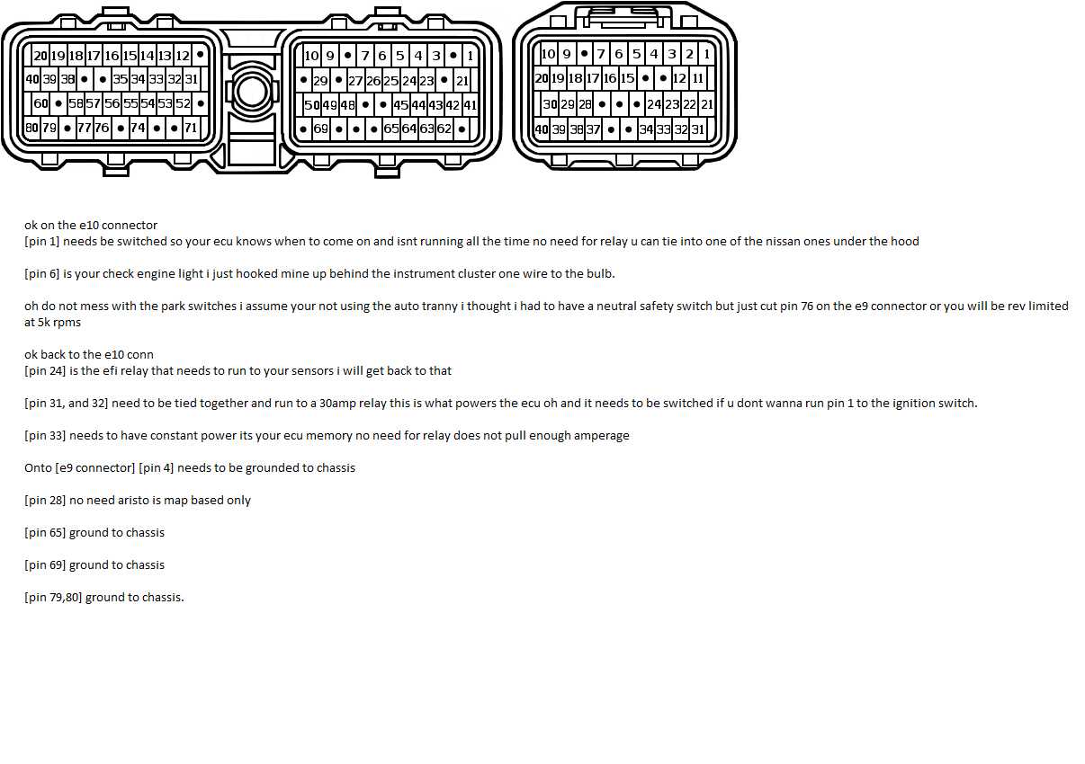

And to help people out, here is how to wire and start the 2JZGTE: (Aristo JDM harness)
E10 is the small one. E9 is the bigger one on the left.
I collected the info from the internet. I will test it out this week and report back later.
Attached Thumbnails My 2JZ-GTE VVTI swap thread.-pinout-toyota-120p.png   My 2JZ-GTE VVTI swap thread.-201104221920-jzs147-engine-body-pinout.png
[IMG]https://my350z.com/forum/attachment.php?attachmentid=361888&d=1394486749[/IMG
Hey man now when you say start and running what else is involved to actually drive it lol and I'm assuming you needed to extend certain wires and what not ?
The JDM aristo harness does not come with the E10 plug. You can get it out of a GS300, GS400 or an IS300. I will take my harness and AEM to someone tomorrow who is familiar with the 2jzgte harness and make him wire it for me and remove all the unneeded wires and plugs. I don't want to fry my AEM or start a fire
You also need to wire the starter, fuel pump, hook up the VQ water temp sensor, wire the A/C (if you want it), make power steering lines for the 2jz PS pump and you have a driveable swap to the exhaust shop. I may forgot a thing or two, but that is the main things for a swap.

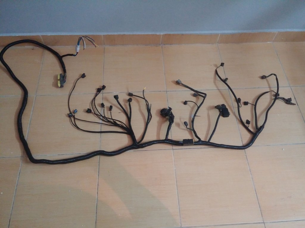

I just got my harness back. Costed me like $450. All that is left to do is to pick up the E10 connector plug tomorrow from the junkyard, wire it and start the POS car

Originally Posted by Cubano4ever
why the shop that did you swap didnt do the wiring???????
It took him 5 months to finish the swap, I don't want to wait another 5 months more for him to figure out how to wire it.
Also this guy knows the 2JZGTE harness like the back of his hand. He removed everything that is not needed from the harness, extended it and soldered in the new sensors and injectors.

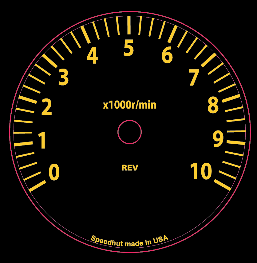

And I finally gave in for now on getting the OEM tach to work and ordered the Speedhut gauge.

Speedhut art dept just sent me this:
I love this company already.
