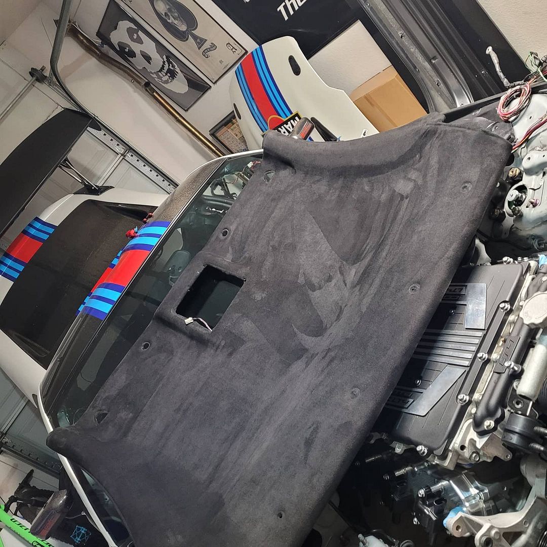

Interior should be back from stitch work beginning of June...
removed he visors and headliner and swapped em doa local for a few hundo and his stockers.. that way we have a fresh batch to recover and stitch up w matching material.

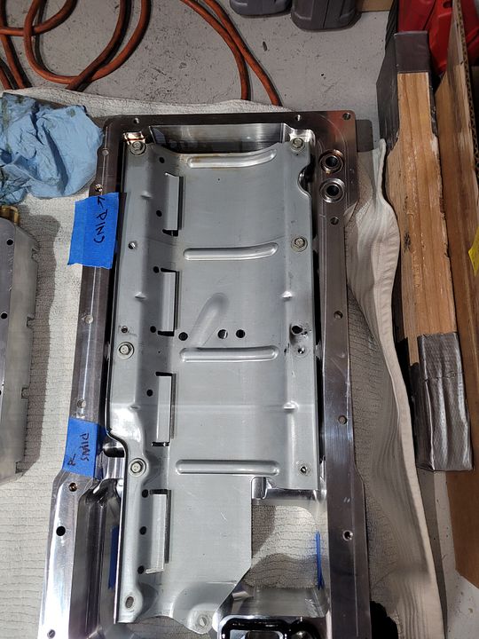

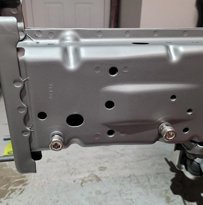

In other news, things are moving in terms of the oil pan.. had some friends step up and help me design a flange file to be CNCd out of aluminum.. having the test part 3d plastic printed now.

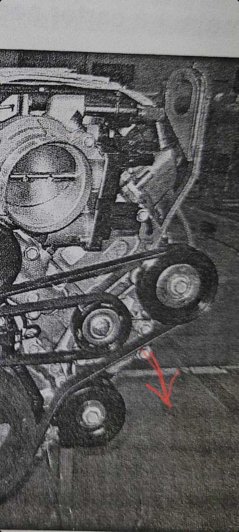

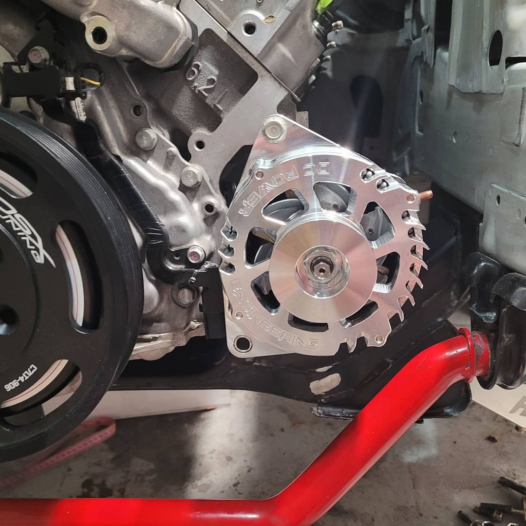

Ran into more issues w the alternator.. it wont fit on the stock water pump location.. Id have to cut out where the front arms mount .. nope.. so now I have to engineer a crazy mount to hang it off the drivers side below the tensioners.. and run it off the supercharger belt.. ill have to build a bracket and also try and add another idler to take care of belt wrap on the pulleys.
Im going to have to do the same to put a blank idler pulley where the alternator would have normally been.. this LT4 pulley system is INSANE.

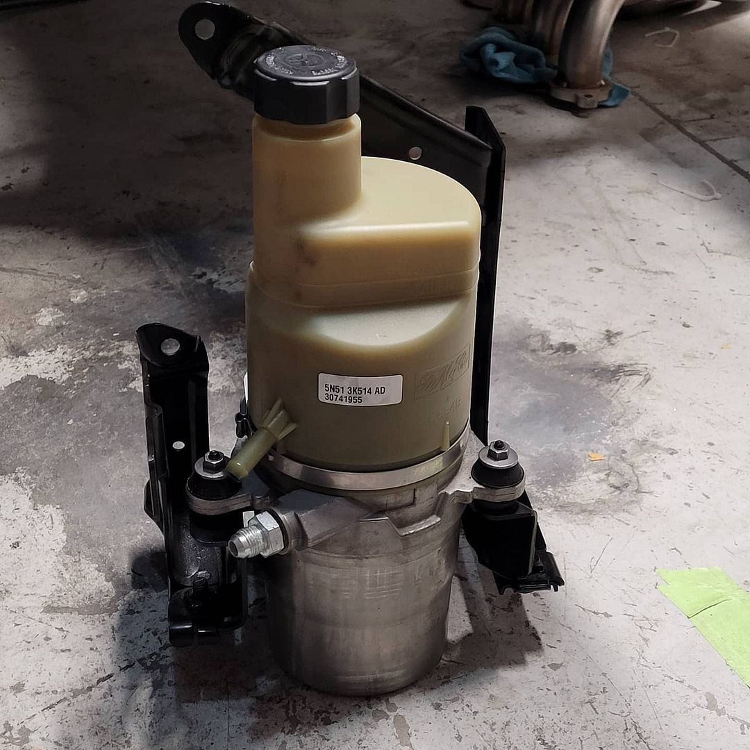

This being the case, I opted for a volvo C70 electric ps pump.

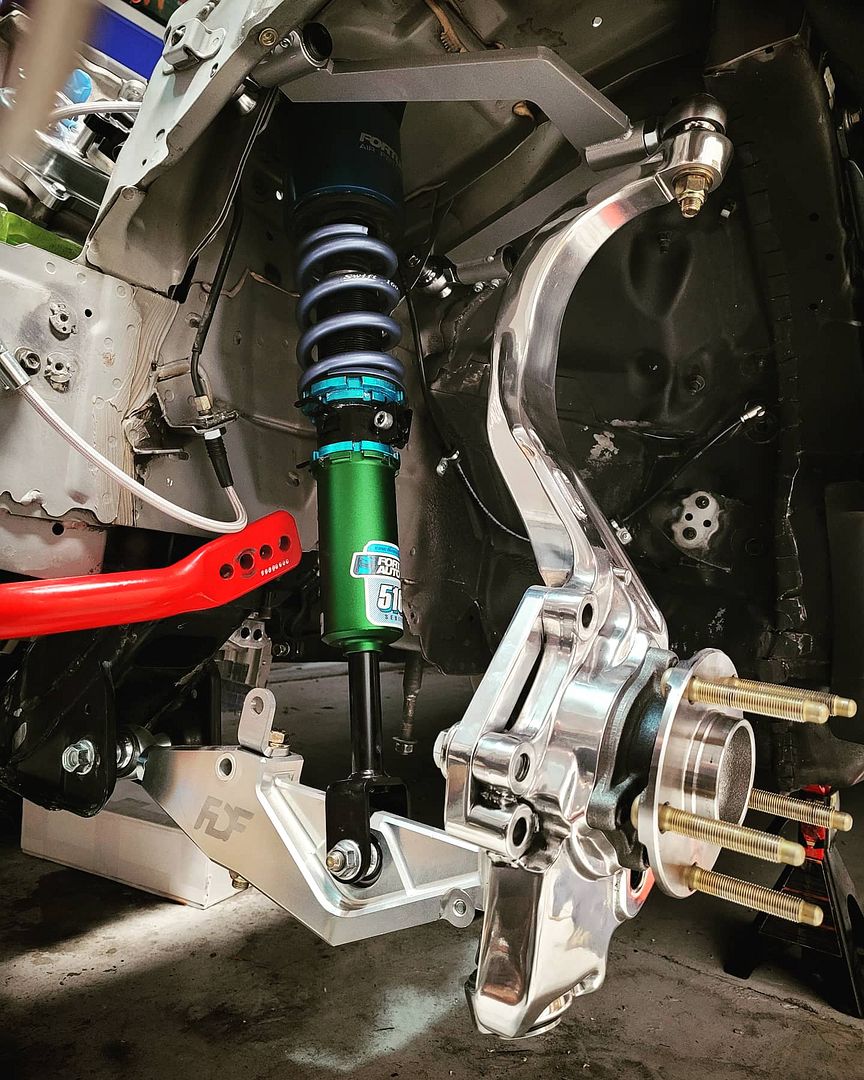

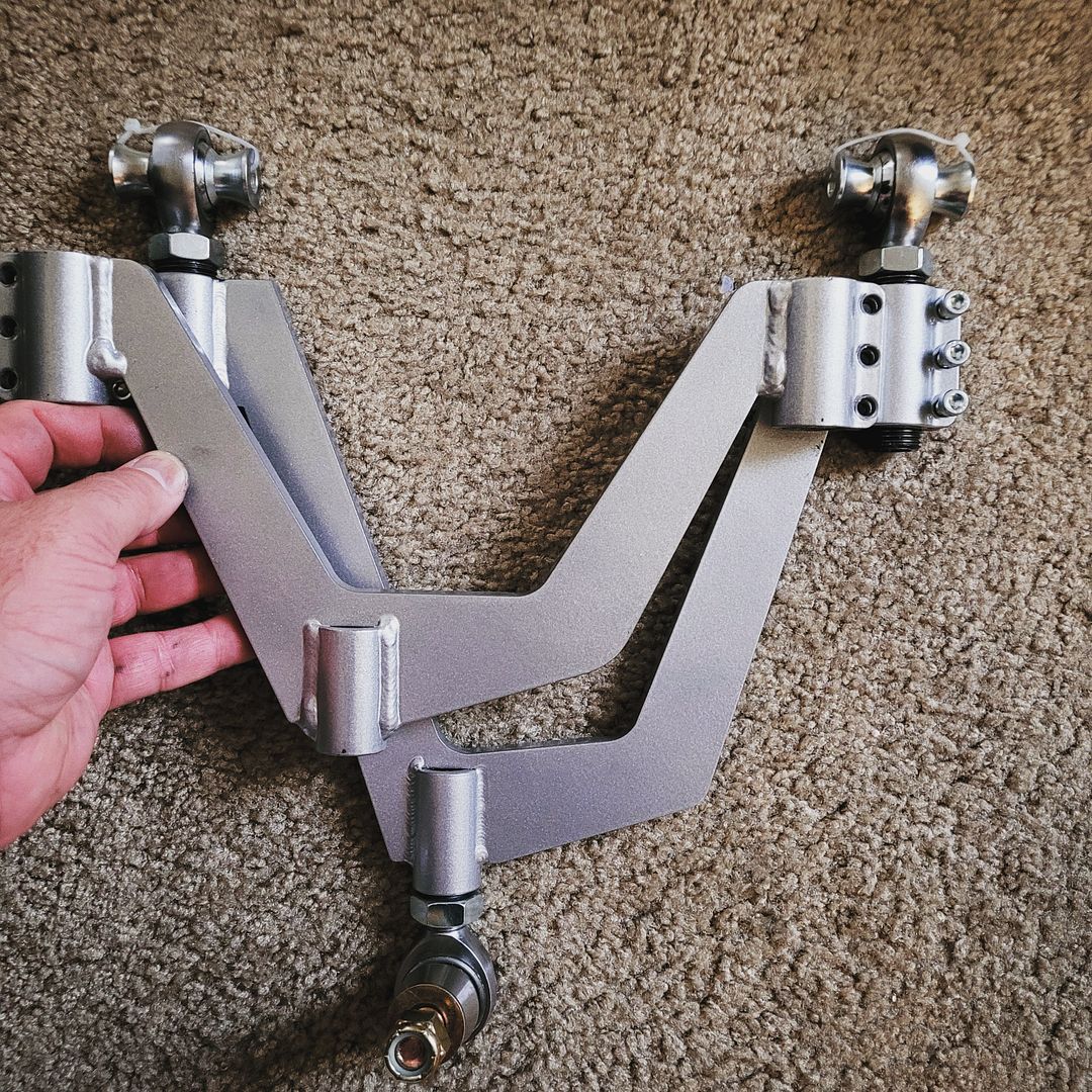

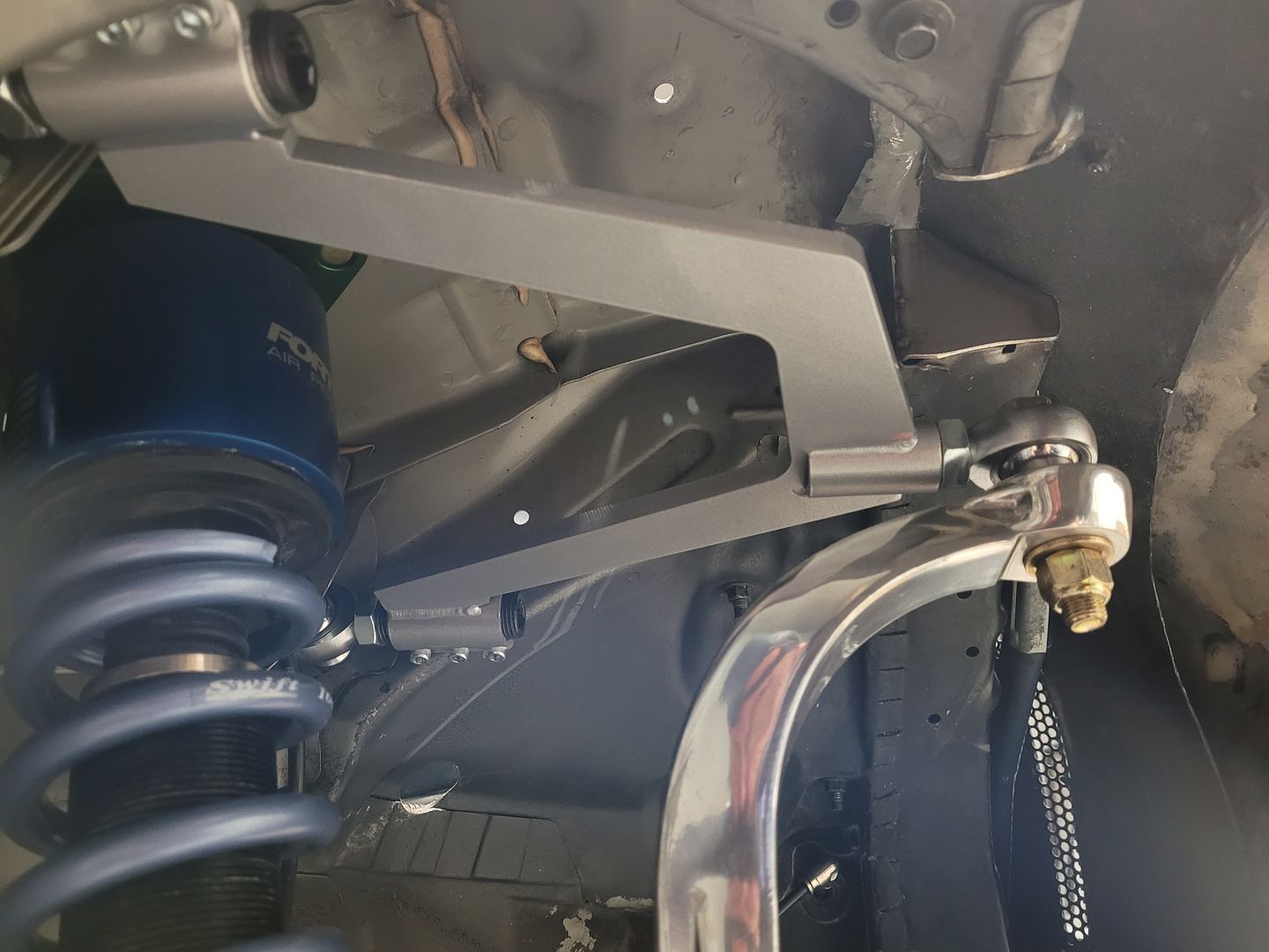

Got the FDF custom wider upper arms in place.. they came out stellar.
Now just waiting for my FDF lower compression rods built for non drift cars.

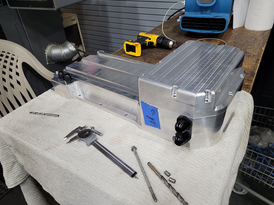

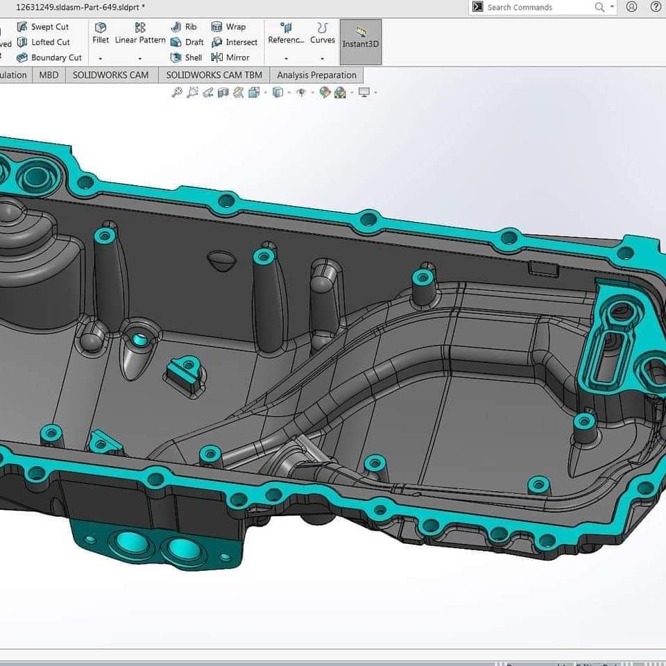

Dude is still working on the program file for my cnc oil pan... Hooray.. Super fun.. Can't wait to have to pay for that lol.

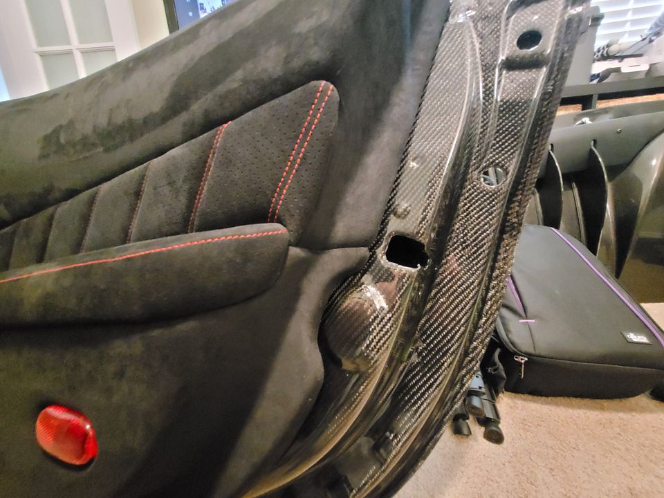

Al Vincent made me some custom A Pillar speaker pods for the hertz three way set up midranges..
Off to upholstery as soon as they reach me.

Also, the FDF arms are installed but I'm a little co cerned about how low they sit vs the oe arm being centered on the chassis pin. The solution?
Leave it the f alone for now lol.. If it becomes an issue for binding or hitting the steering rack boots as it seems it may, I'll simple machine out a steel sleeve to fit over gktech solid or es poly bushings and cut off the heim and weld that in place instead.. It will still have a heim joint at the knuckle so it can be adjusted and widened either way 🤟
I sent the alternator back to DC Poowr again to have an 8 rib oversized pulley made, so it can run off the supercharger belt, and won't be spinning at warp speed due to my larger up sized supercharger lower pulley.
I can move up to 370 Amp, but I'm told the bets overall performer w good idle output is to stay w the 270a.
With my volvo electric steering.. Big fans etc.. I'll need all I can get.

Oil pan is basically done.. Alternator bracket is done.. Idler bracket is done.. Holley ecu is here in hand..

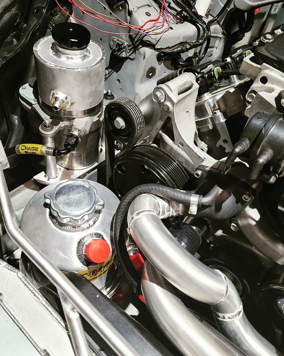

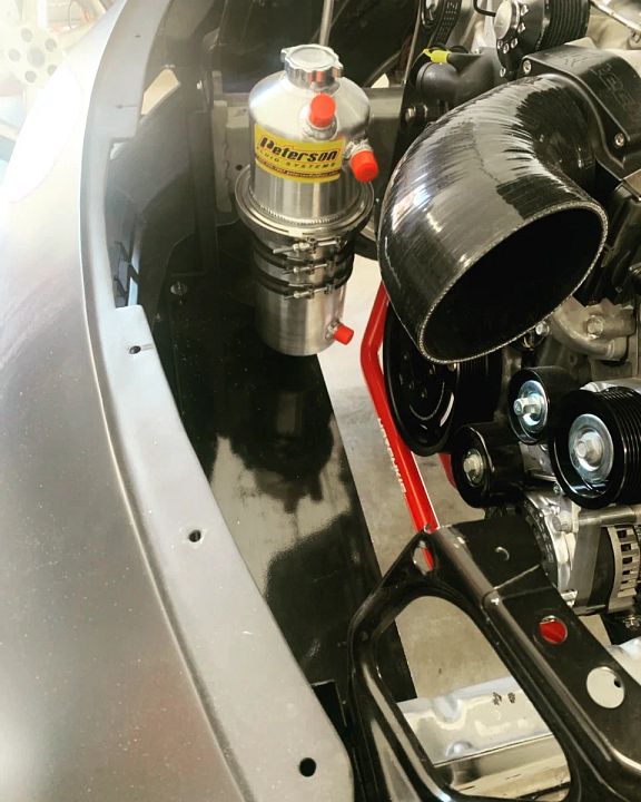

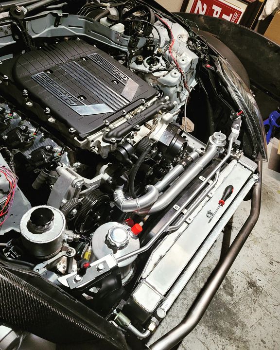

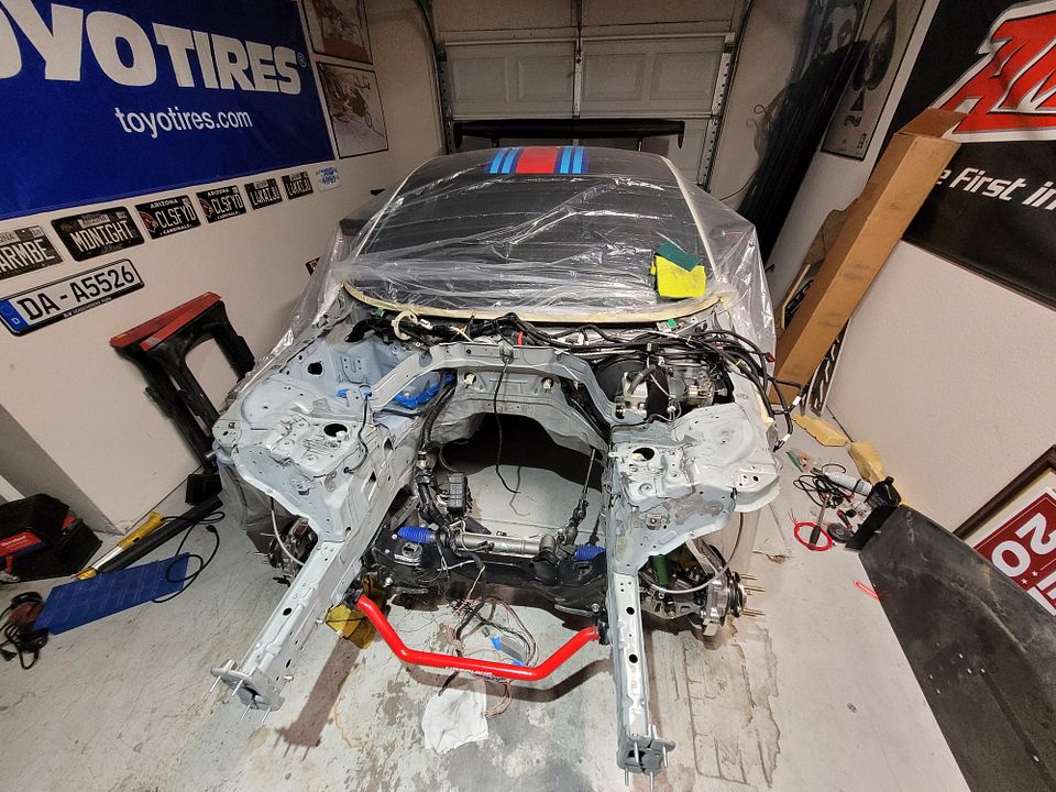

Updates.
I've never stopped, but just stopped posting pics here due to photo bucket bs.
Hatch fixed.
Engine bay painted w steel it.

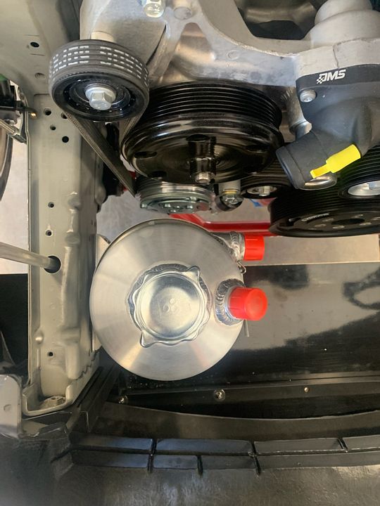

Fab done, power steering pump, radiator and dry sump tank all affixed.
Awaiting vibrant 12*12*2 core to be built w end tanks into dual pass coolers for the super charger
Finishing wiring the ecu and screen over this weekend..
Test boot worked fine yesterday.
Oil pan should be done at anodizing this week.
Tilton st 246 dual clutch arrived months ago
Still need money for a transmission but I have everything I need to finish right now, jst waiting on the cooler core fab, then I can plum this thing
