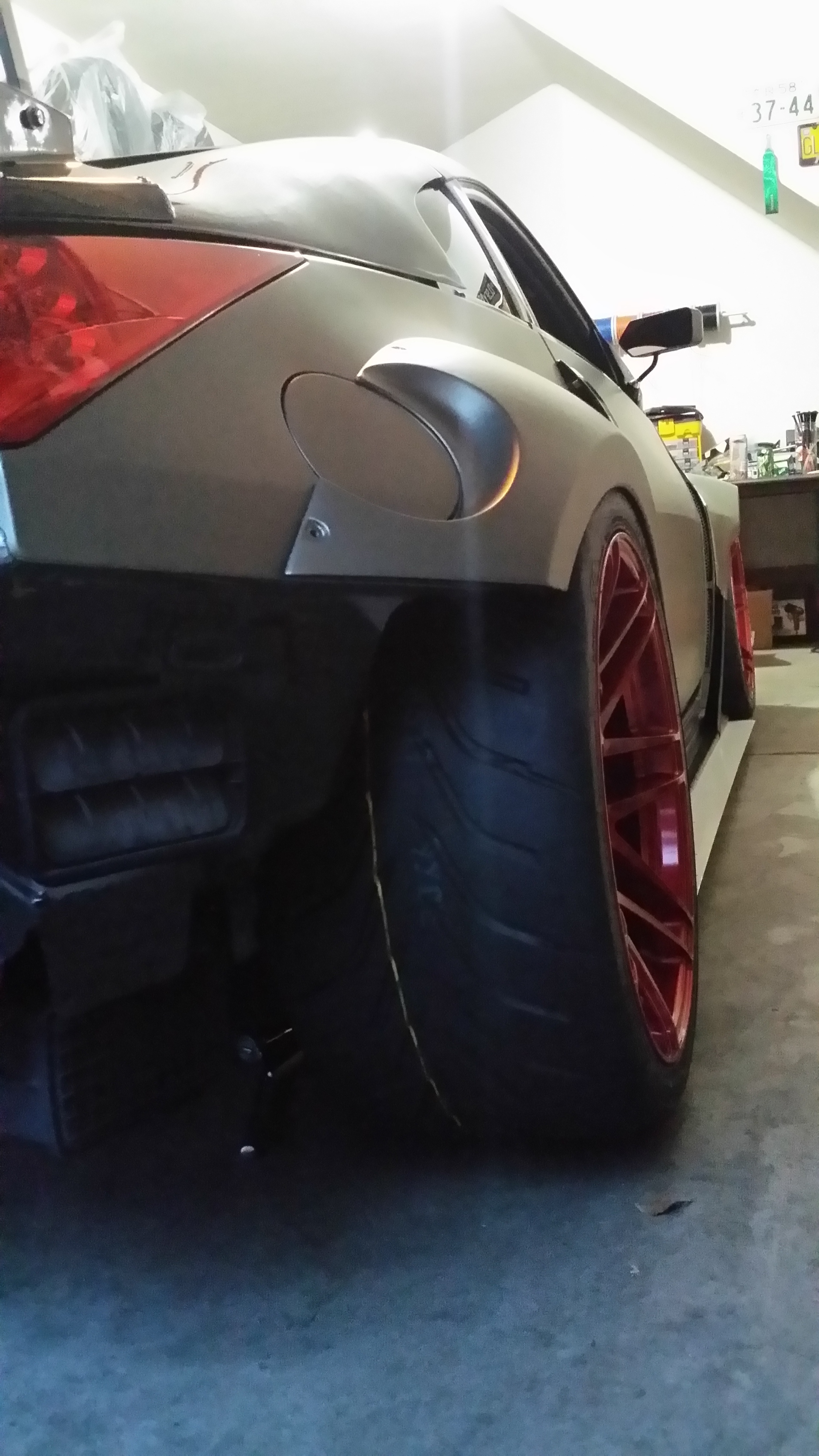

still waiting to hear backl from precision turbo.. so ive been ironing out details as it just sits here.
wheel fit.. needs to be tackled..
front aired out.. has tons of room.. will likely adjust out a degree of camber and also add a 10mm ichiba spacer i have here.
now the rear is a different story.. this tire sticks way out almost until it hits the flare.. then the shorter RUCA pulls in and slips it right under the flare.. sooo close lol.
as we started adding camber, it really adds toe out, so i ordered some Kinetix adjustable traction arms to help.. this fit is killer, but its also aired out, meaning that at ride height, it has no visible camber.. and actually looks so straight up and down that its funny looking..
i plan to add back in a degree or so .. just a touch more..
should look frikn awesome when were done.

Not sure if these will work in correlation with your bags.. but these will help you with your toe issue. They'll grab the back side of the hub while the camber arms only grab the front.
next up on the B Money build, self adjusting camber arms that adjust as ride height adjust.
That rear shot - stance looks fire, fam. Makes me wanna camber mine out a bit more
http://www.splparts.com/spl-titanium...inks-350z-g35/
those are spendy and dont work well with airbags unfortunately.
The collpased bag height inst enough with those.. even w that mount dropped, the bag sets too high up .. wont let you air out.
I bought the kinetix arms.. a touch of adjustment there along w a touch more negative camber will be just fine im sure. Plus it only really impacts the fit when its aired out.. when its riding up you wont notice the slight fwd position .
