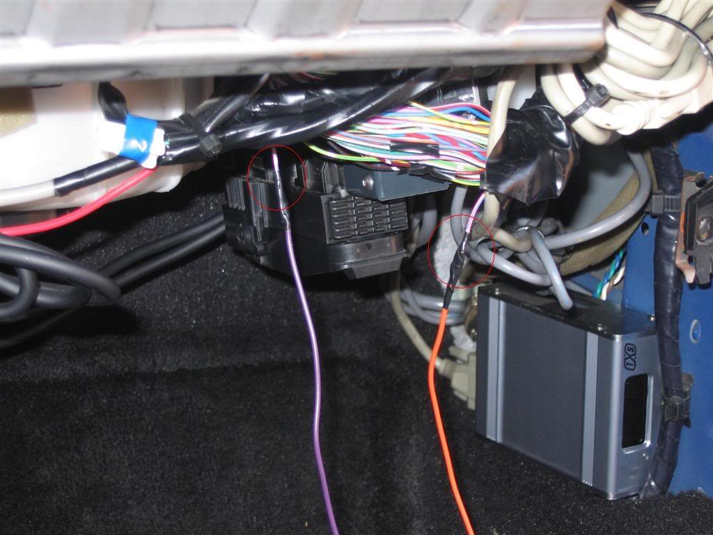

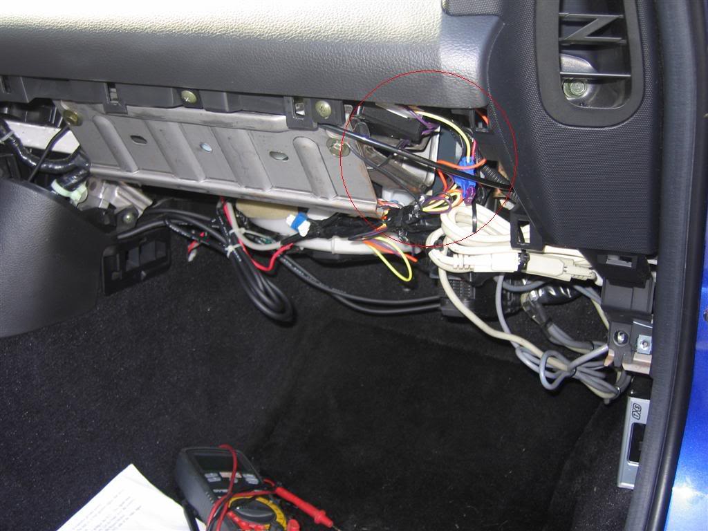

Ok, it works as advertised! Its weird brake boosting in this car, Ive tried before obviously with no success. It doesnt take as much brake pressure as I thought to build full boost from a roll. Below are pics of the brake wire cut/tapped with the brake module (stock cut wire circled in red), then how I secured the unit with the zip ties to the metal support behind the dash. In case of any issues the unit is still in reach (once I take out the 3 10MM bolts) yet out of the way and so is the fuse Any Q's feel free to ask, I did a few 2nd/3rd gear tests, its rush hour so I cant get any videos yet....thanks again Kevin!

Ha, your driver kick panel is pretty busy. Mine is installed down in the kick where I can access it easily.

Thanks for posting pics Alberto! I think that pink wire will be much easier to tap for those of us that don't want to pull the UTEC down...

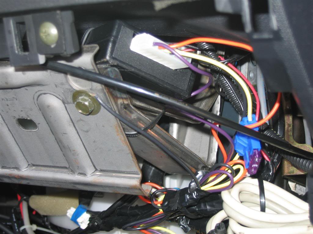

alright here are my pictures
1. cut the pink/blue wire in half. connect the orange wire to the pink/blue wire that goes into the ecu
2. connect the purple wire to the pink/blue wire that goes up the harness towards the brake peddle
3. connect the yellow wire to the white/blue wire. make sure you have the correct white/blue wire there is 2 of them in the harness.
4. connect the black wire to the thick black wire in the harness. there were two of them as well in my harness. it is best to use the one in pin 1.
