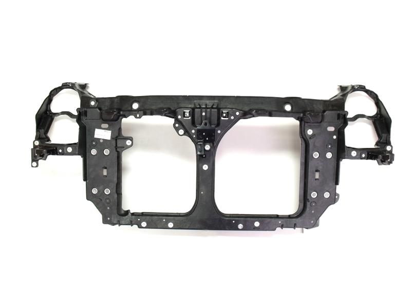

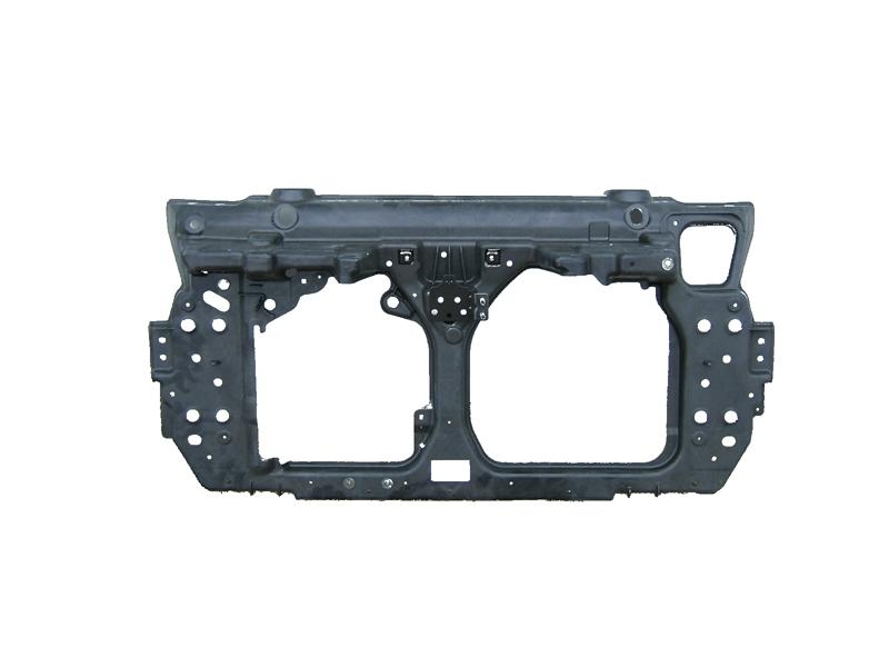

There is a pretty awesome DIY for a cai for the vortech kit in the DIY section by SamMcgoo. My question is this: Any of you G35 guys do this on your vortech kit? This would require cutting a pretty large hole in the radiator core support in a spot that seems somewhat structural. Images for g35 - 350z comparison:

Old Jan 10, 2013 | 12:41 PM
  #2028
str8dum1's Avatar
str8dum1
Joined: Oct 2007
Posts: 8,807
From: raleigh-wood NC
on a G35, just get a 3.5" 90* silicon bend and put the filter in front of the tire behind the mesh opening in the grill.
no reason to cut anything. Cost me like 20$ to make mine.
Old Jan 10, 2013 | 12:47 PM
  #2029
- bigc -'s Avatar
- bigc -
Posts: 1,014
Likes: 6
+1. I've seen two G35s that have intakes run through the core support. I believe GTM's tt kit also routes one of the intake pipes that way. Its fine structurally, but you have to bend a bunch of A/C lines out of the way which keeps most folks from attempting it. Like str8dum1 said, putting the intake under the headlight / in front of the wheel is much simpler.
