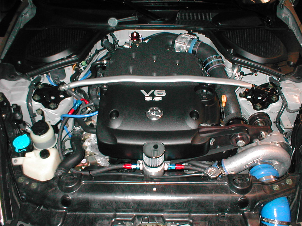

Old Oct 24, 2012 | 04:20 PM
  #1980
OldManZ350's Avatar
OldManZ350
Posts: 2,429
Likes: 230
Tied into Drivers Side valve cover and Pass Side, did not modify PCV. Pluged line to Plenum. Works great with 17psi boost.
Attached Thumbnails vortech FAQ: read this before asking vortech questions-p1010014.jpg
