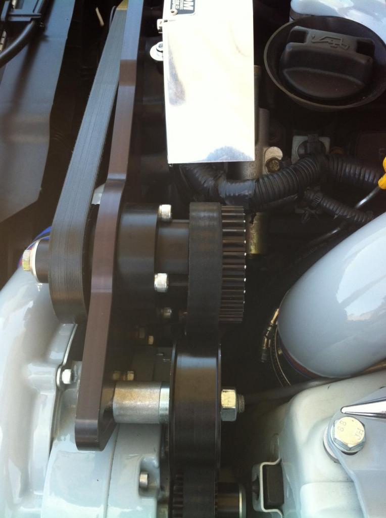

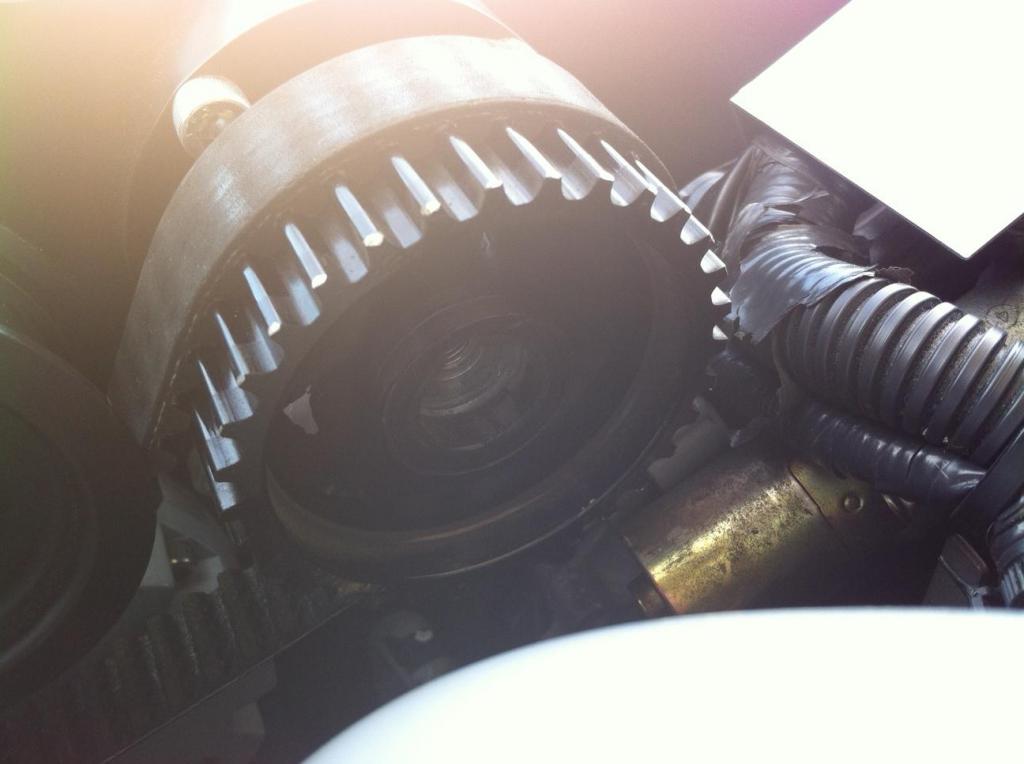

Looks like the bolt and key holding the cog pulley came off and now the cog pulley is jammed on the jackshaft. Ive tried and cant get it to come off.
Im going to pick up a jackshaft, cog pulley, and the bolt/washer/key. I got the jackshaft already, going to order the cog pulley, but I cant seem to find the bolt that holds the cog pulley in. Does anyone know where I can get that bolt/washer/key set up (for the cog pulley)? I was thinking it might be the same one as the ones holding the ribbed pulley up front and I can find those, but Im not sure.
Old Aug 11, 2013 | 03:09 PM
  #2112
OldManZ350's Avatar
OldManZ350
Posts: 2,429
Likes: 230
go to http://www.superchargersonline.com
they will have what you need.
Old Aug 11, 2013 | 11:18 PM
  #2113
BEBO'S ZEE's Avatar
BEBO'S ZEE
Joined: Dec 2008
Posts: 987
From: West Coast
yeah I had looked on there before and wasn't really sure what part it was. I emailed them and they helped me out, so I ordered what I needed from them.

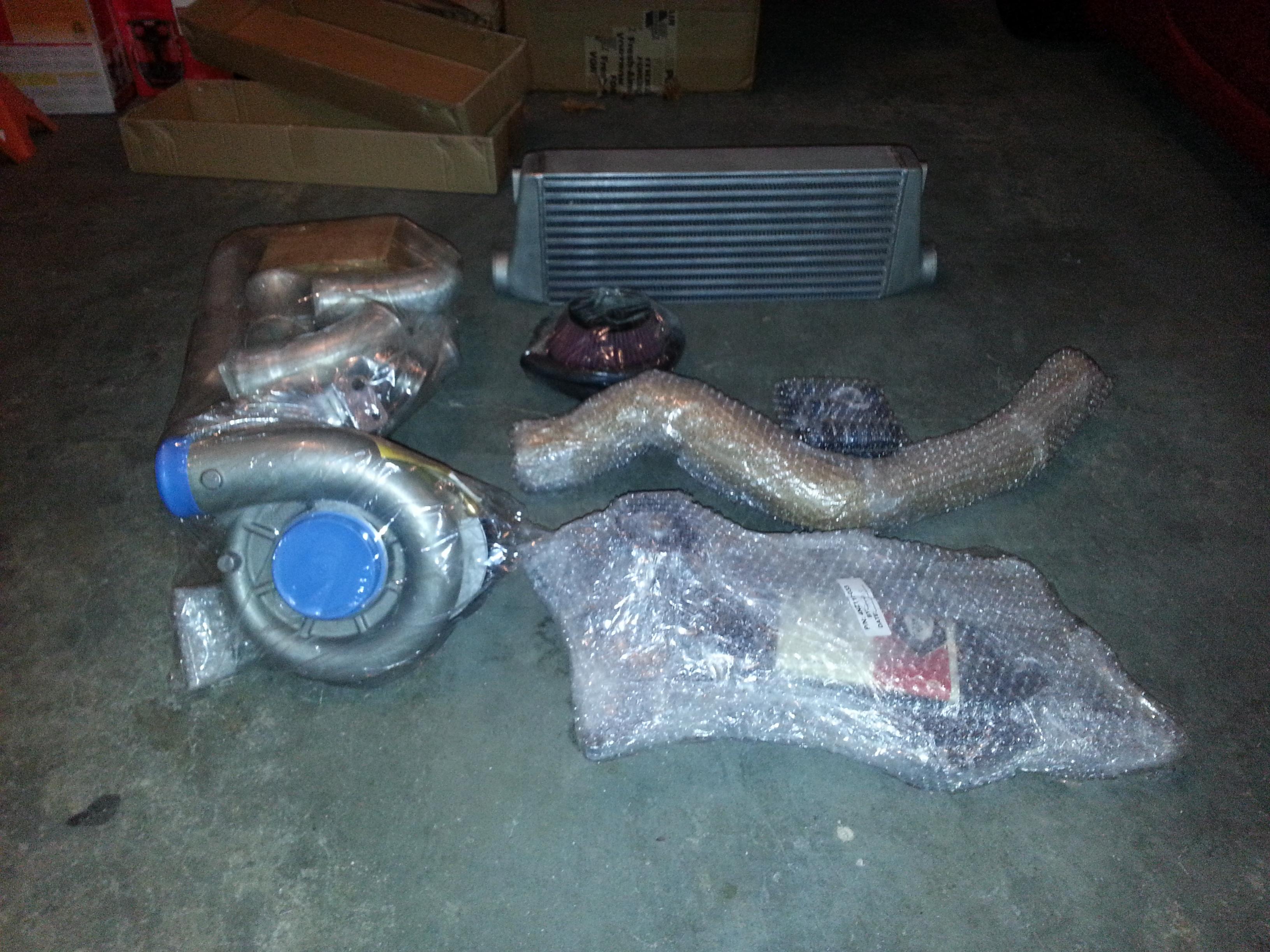

This came in last night. Tuner kit is the last pieces to be installed! I decided to pull the trigger on the Vortech supercharger because of this awesome write up by sentry65. Wish me luck
