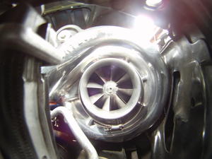

Ok so here is a picture of the impeller, it looks perfectly fine to me....also its about 45 to 60 degrees what I can twist the belt...
Is it possible to test just the blower to see how boost it is producing???
Hopefully tomorrow i will go to the shop to test the BPV with my mechanic ....running out of options
that's because you're testing the belt tension in an incorrect place.
You have to test it at the longest belt length between 2 pulleys. Where you are testing it is like 5" at the most between pulleys. You'll never be able to twist that since they are so close.
and you have to test it directly in the middle.
did you close down the BPV bolt to test if hte bpv is leaking?
