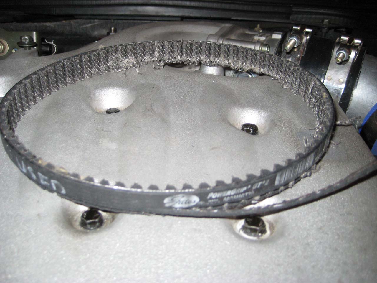

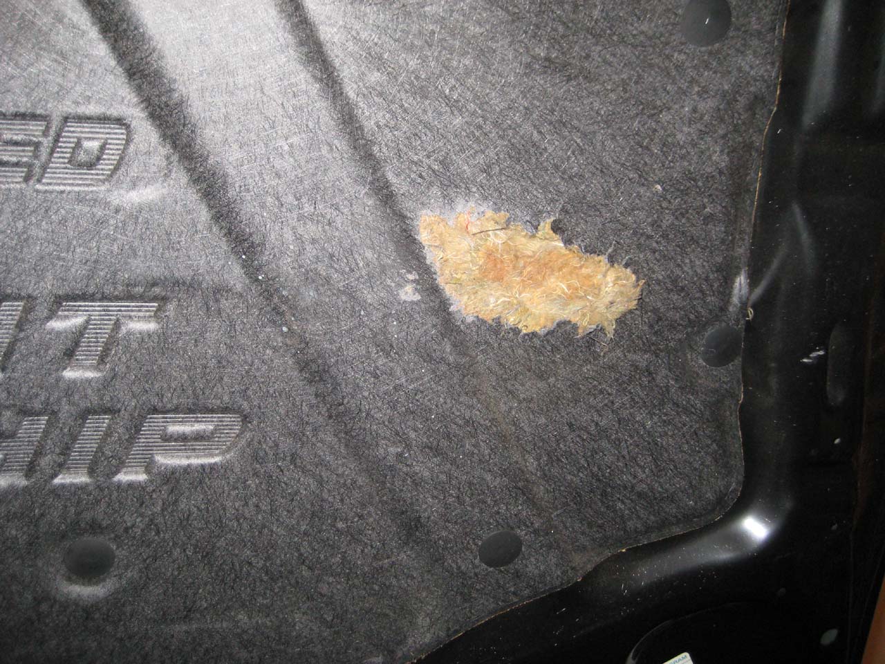

After a sweet dyno tune by Sharif, I was on my drive down to Macon, GA. Heard a knocking under the hood. Immediately pulled over. Saw that the cog belt had shredded. Tore up the hood liner real good and stripped the wires bare on the IVT solenoid.

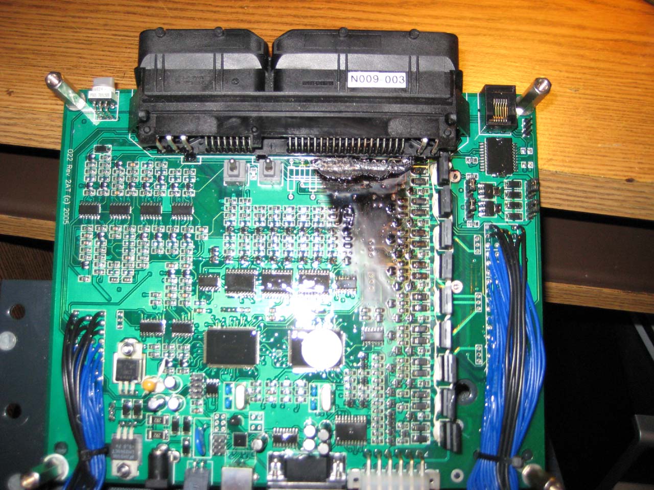

Well undid the f'd belt and continued my journey. SES came on, but I figured it coulda been anything. Got to my buddies and did a bike ride. Cleaned up and went to the car to clear the code. Turned the key on and the car filled with smoke. Of course car wouldnt start after that. Called AAA and had it flatbedded baCK to Forged 100 miles away. Sharif found a burned out ECU fuse, replaced it, and threw in a new UTEC. Got back home and still couldnt clear the p1136 code for the bank 2 IVT solenoid control.

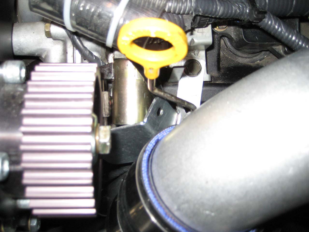

Attached Thumbnails I'll damned if that happens again..-torn-cog-belt.jpg   I'll damned if that happens again..-torn-hood-liner-1280.jpg   I'll damned if that happens again..-flatbed-out-of-macon.jpg   I'll damned if that happens again..-burned-utec-1280.jpg   I'll damned if that happens again..-solenoid-protector-1280.jpg

Any idea why it shredded? Bad belt, too tight ? Not aligned?

Sounds like some wire got short-circuited in the process and knocked out the UTEC (nice to know there's no over-current protection on there ), which in turn blew something in the stock ECU. At least the stock ECU blew a fuse - even if it didn't save it - at least it didn't go up in smoke like the UTEC.
Hope it all works out - good job with the preventative fix.

I think the belt was on too tight. Granted the car had been on the dyno and had numerous runs, but I ran her hard lots of times before that with no problem.
