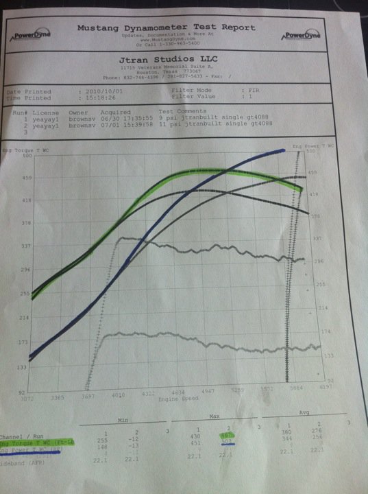

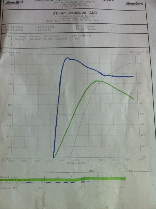

quick update guys... well since our last run at the dyno we had some issues with the turbo... long story short parts were warrantied by garrett but have been in back order since early august!.... anyways still waiting and hopefully i get news soon! .... i got a dyno sheet but not very good considering it started slipping on the dyno! also got my runs at 11 psi and 9 psi

^Can't see the numbers. What were they?

581 rwhp and 540 tq.. 19 psi
503 rwhp and 467 tq.. 11 psi
451 rwhp and 430 tq.. 9 psi
