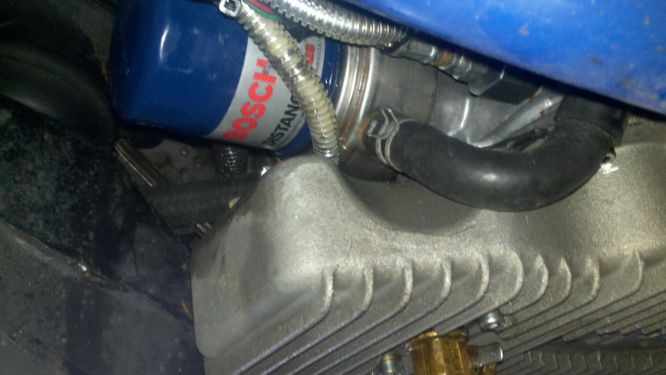

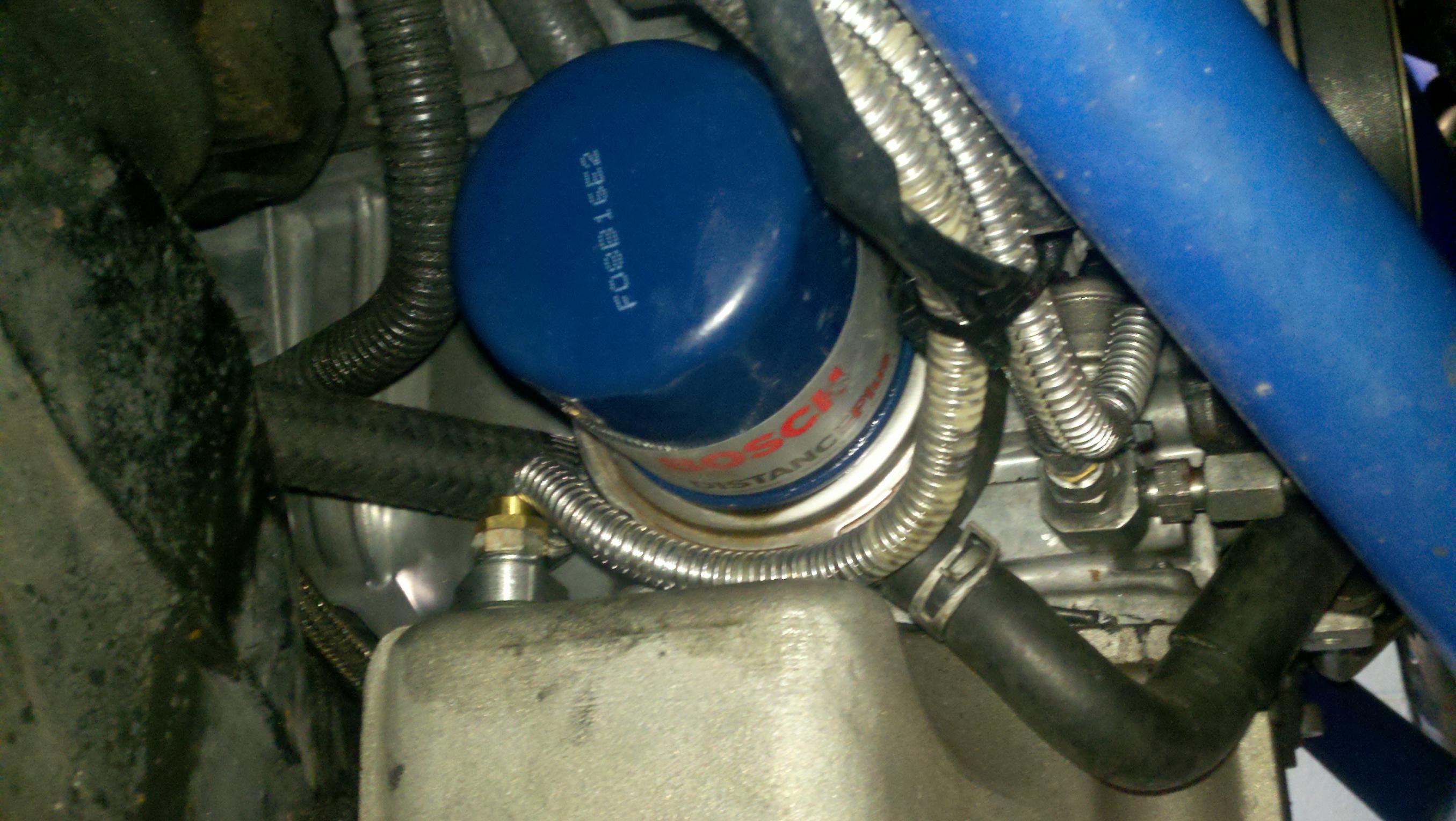

Glex - any chance you have or can take some pics of the setup and the modded bracket? Are you using the APS oil pan? I have small straight fittings that convert the 1/2 BSP to -10AN fittings right out of the plate and then 90* fittings off of those. Are you using 90* or 45* fittings off the plate?
I have the oil temp in the old APS turbo drain plug and oil pressure where the stock pressure reading unit used to be. I suppose I could eliminate the coolant plate all together as the car isn't ever going to see real cold temps
Here is the area I'm working with:
Cass007.... ver 5.0-2011-04-15_15-06-40_671.jpg Cass007.... ver 5.0-2011-04-15_15-06-54_933.jpg
I know the tires aren't recommended for 9.5" rims, that is why I was asking if anyone has mounted them before. I'm running 275mm right now and I'd hate to get thinner to a 265mm.

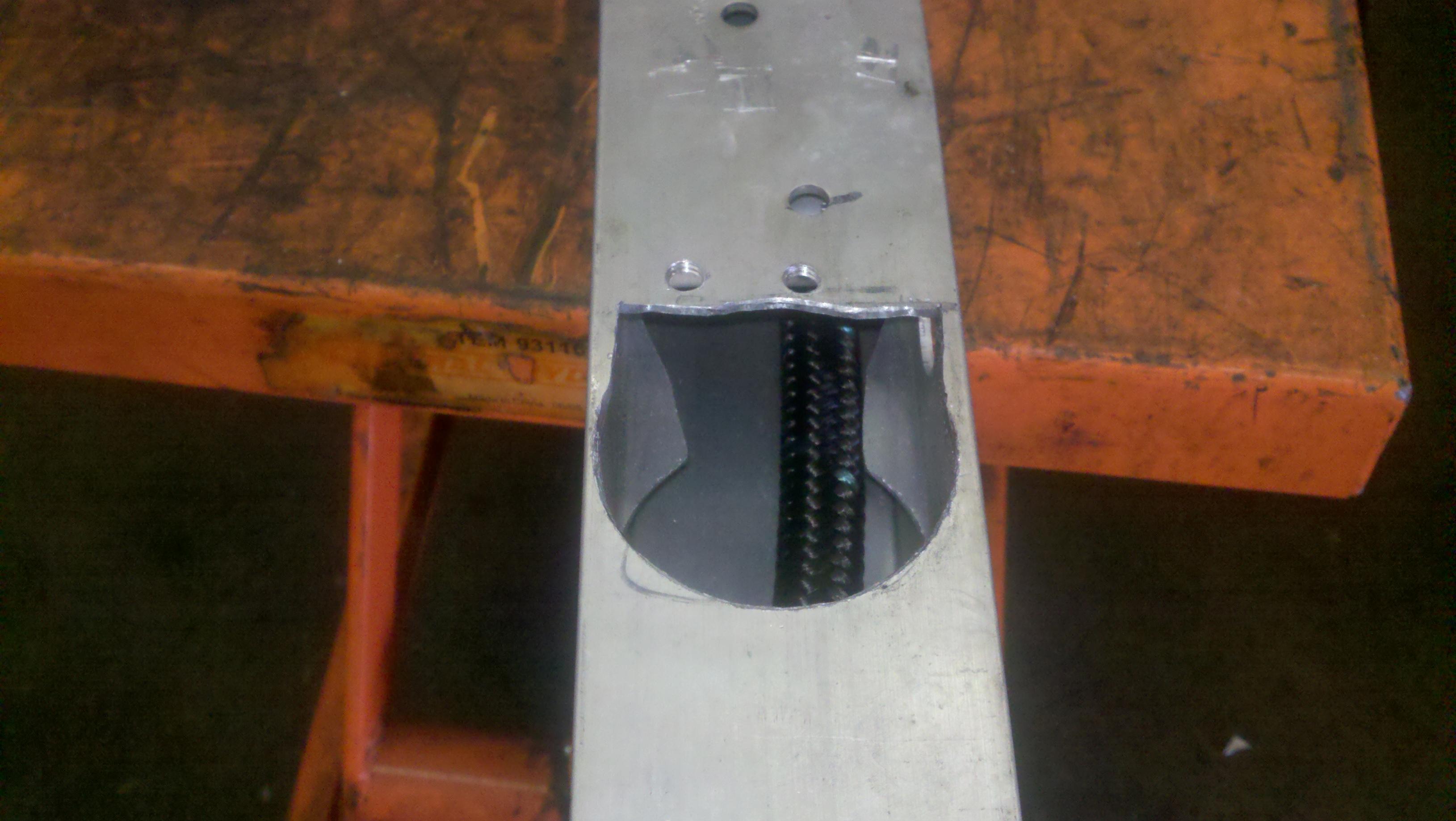

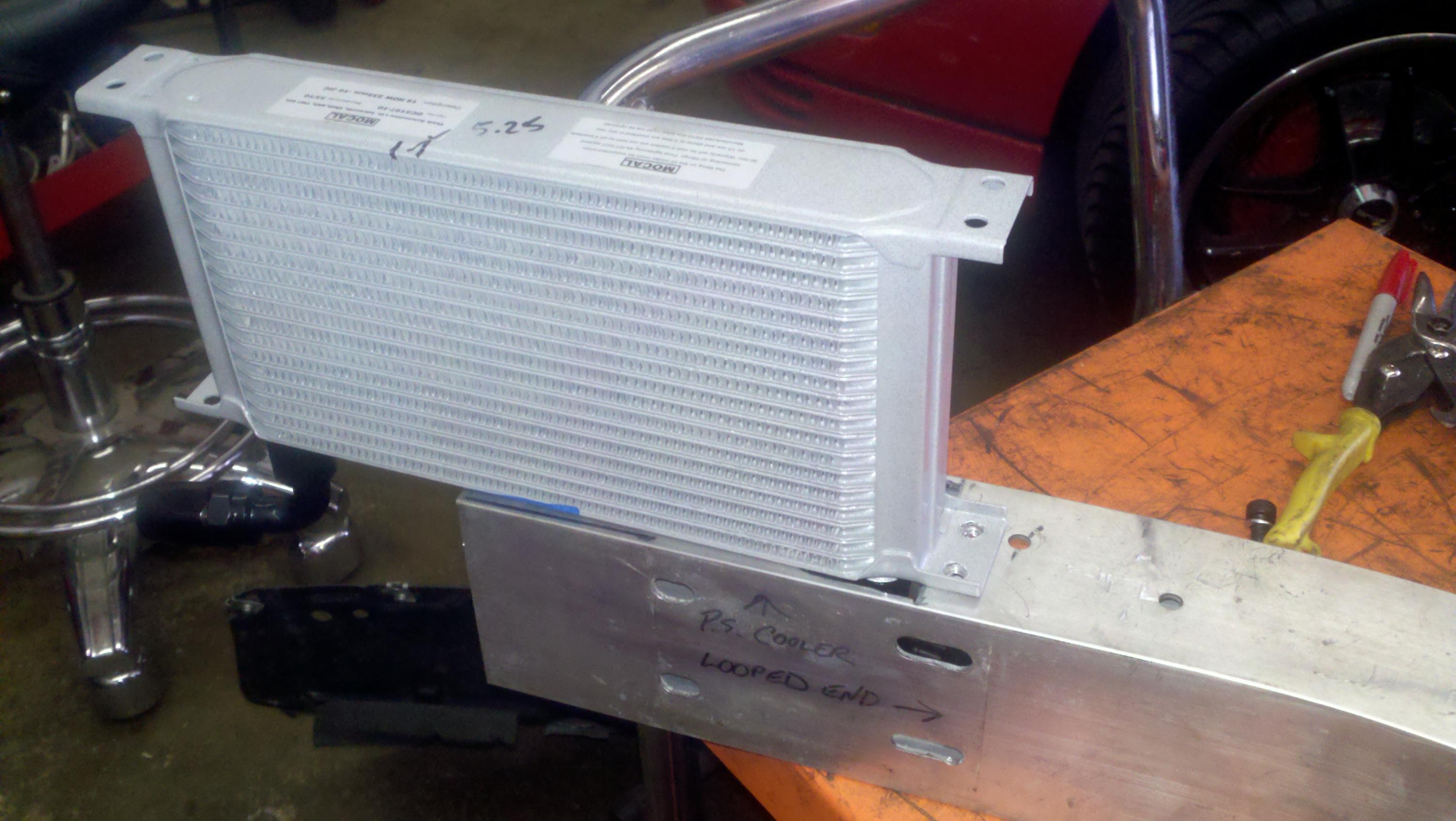

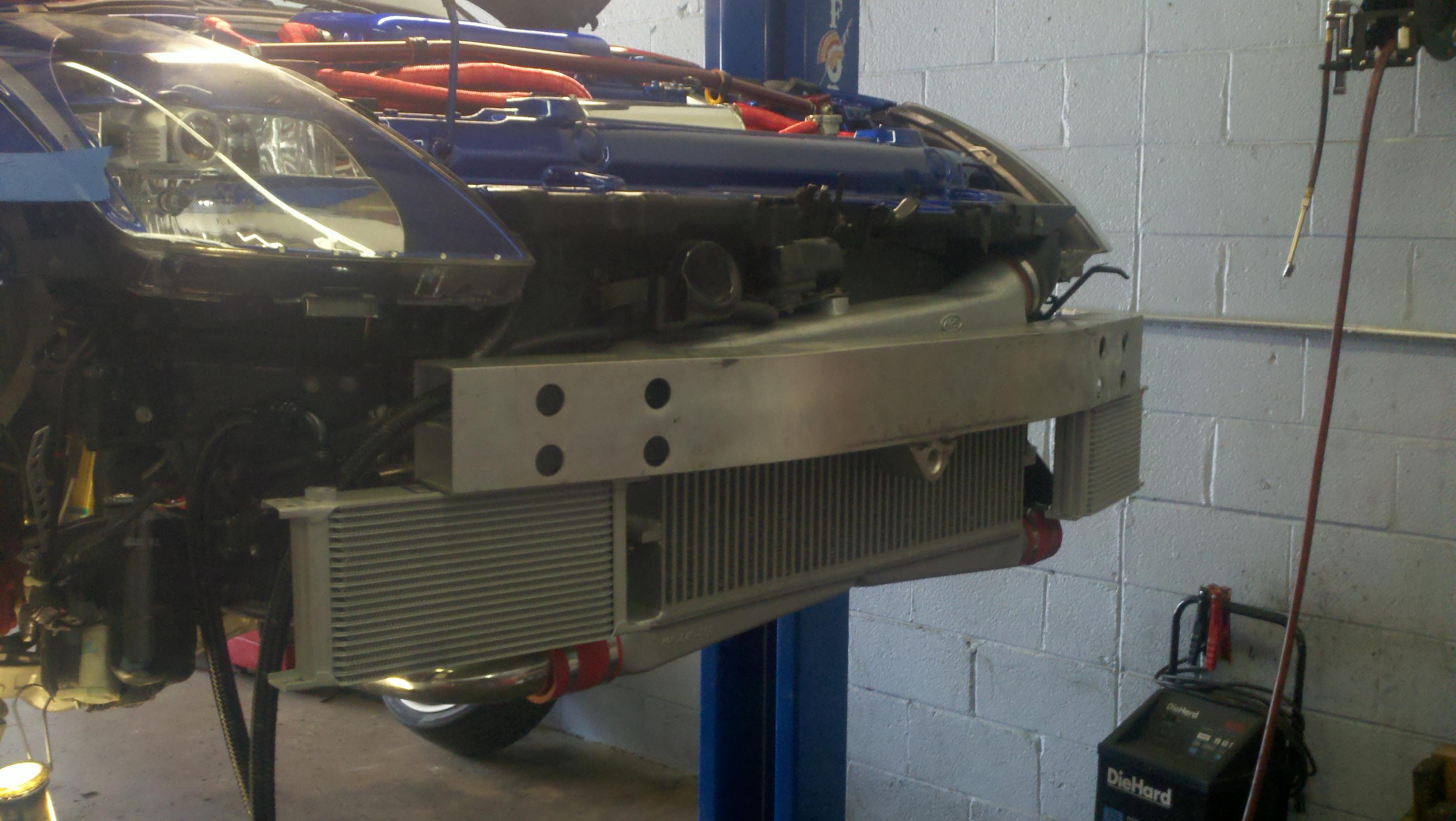

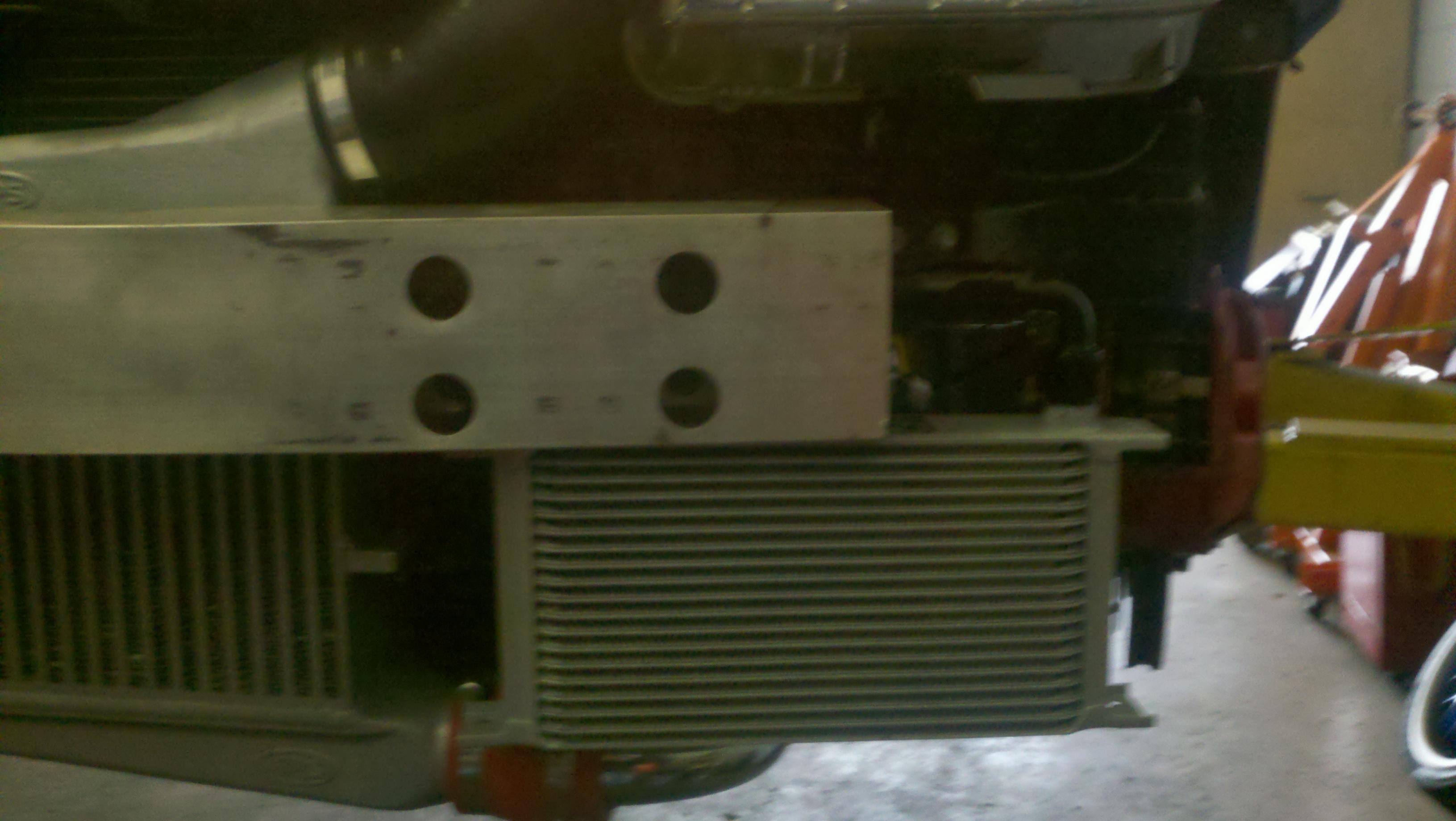

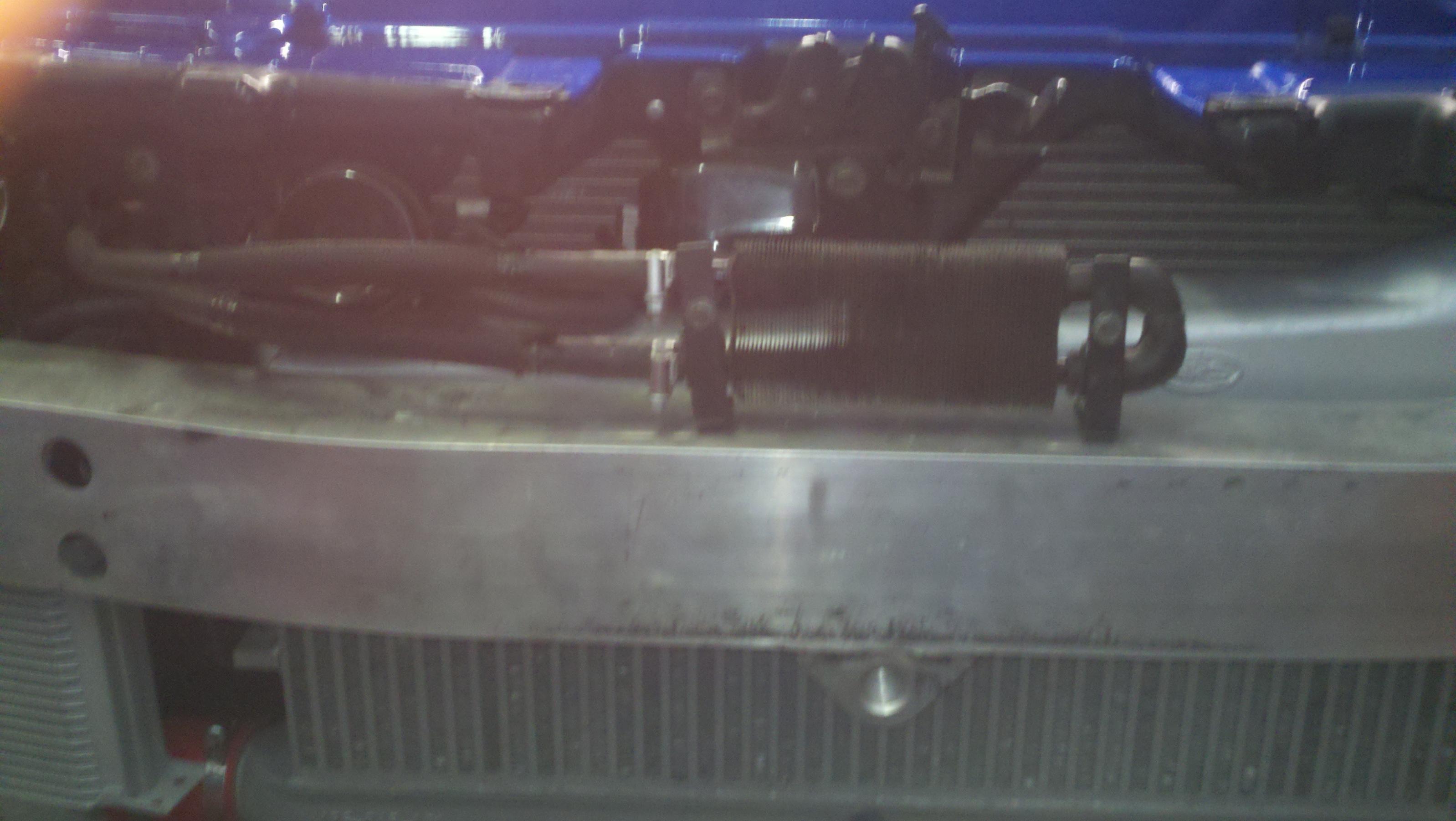

Pics of the mods to the crash bar and setting up the coolers:
Cass007.... ver 5.0-2011-04-15_13-40-17_468.jpg Cass007.... ver 5.0-2011-04-15_13-40-29_950.jpg Cass007.... ver 5.0-2011-04-15_14-24-52_160.jpg
Frank mounted the coolers flush to the bottom of the crash bar and we ran the hoses through the top section of the hollow bar. The writing on the bar is from me when I reassembled the car this last time. We had to relocate the PS cooler and it fit tucked in right here:
Old Apr 15, 2011 | 06:09 PM

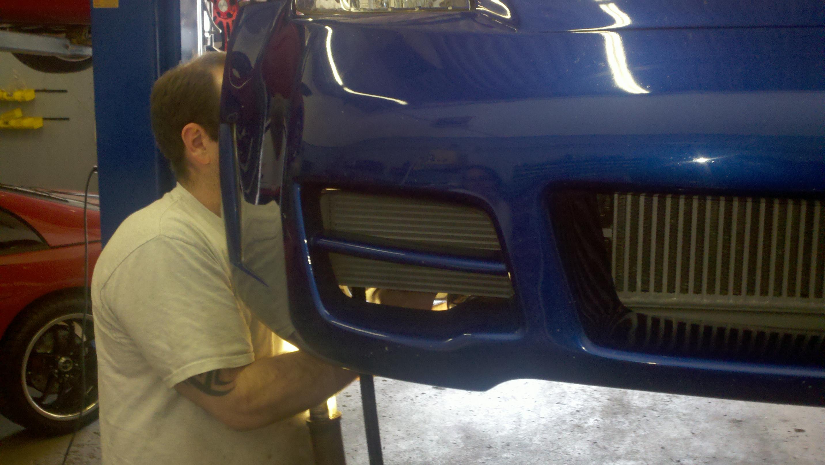

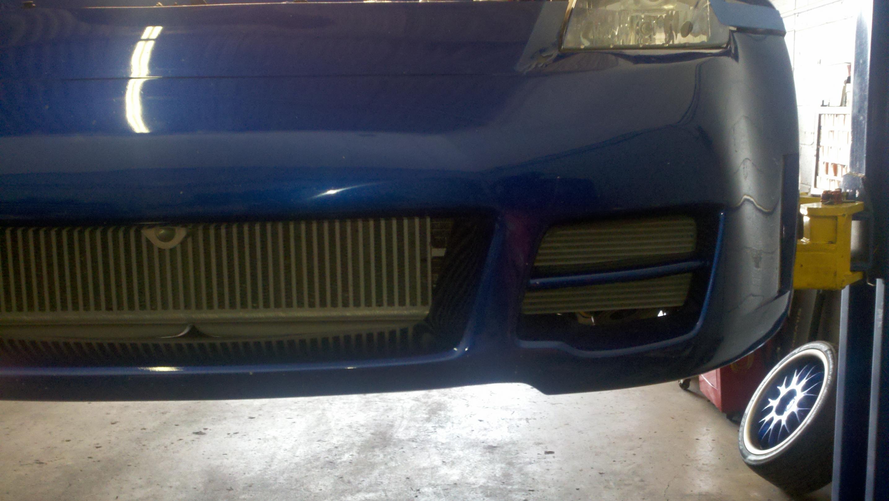

Pics of the setup on the bar and how it looks with the front on. We got pressed for time so I forgot a full frontal shot. I will get it and post it up tomorrow if I can.
Cass007.... ver 5.0-2011-04-15_14-25-03_168.jpg Cass007.... ver 5.0-2011-04-15_14-28-47_794.jpg Cass007.... ver 5.0-2011-04-15_14-28-57_310.jpg
Attachment 312682 Attachment 312683
Sorry Cass for the late response but no I don't have pictures
But Randy's setup was the same one Jeffie did here
You see the elbow fittings I put them where you see the factory oil cooler line is routed towards that little cut out on the APS pan facing towards the front of the car ( Picture #2 that you posted) and just cut the bracket to have enough clearance. It was tight but it fit
Attachment 312688 Attachment 312689 Attachment 312690
hahahahah i see my car on the lift in the background..
speaking bout oil coolers.. ima have Frank upgrade my lines on mine cooler.
