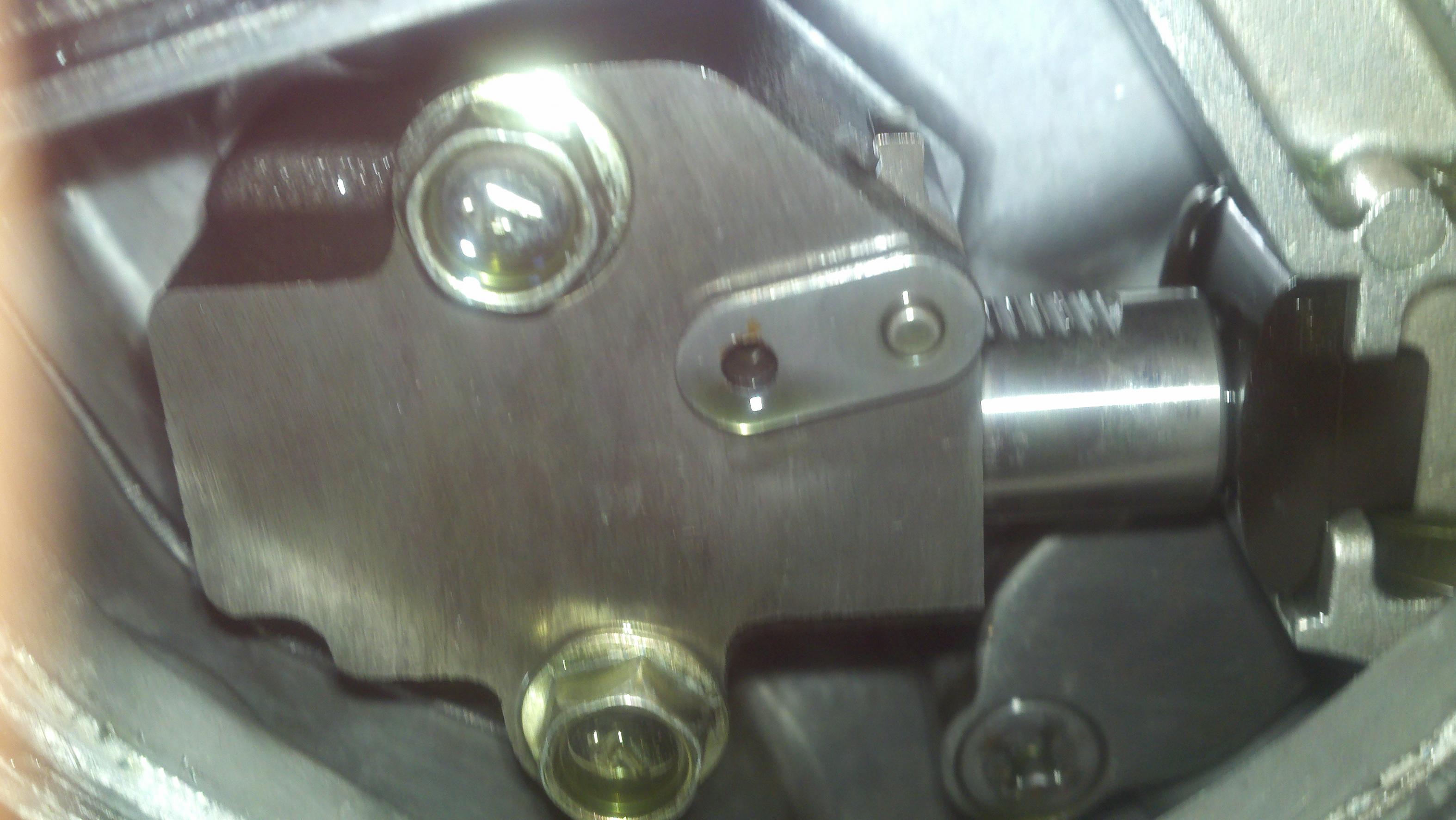

Ok, I can't stand the waiting and today was 70*+F outside so I got out a few tools and did some discovery.
Here is a pic of the tensioner as it is sitting in the car now:
Notice how it appears completely depressed. Also, I believe it is resting at the point where lock to install it is lined up. I was able to slide an allen wrench right in it. Is this how it is supposed to look at rest?

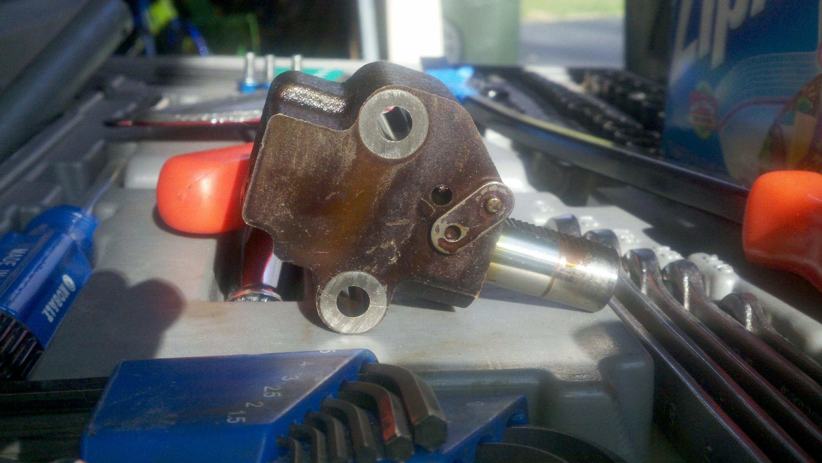

Here is a pic of the tensioner off of the oil burner used as a core:
It seems that the resting position is not fully depressed, but it also has no resistance on it. When I depress it fully, it does not appear to give as much as the tensioner that is in the car.
Can anyone help me out on this Oh, the tensioner in the car appears to have resistence on it, meaning I couldn't push it in any further and there wasn't slack in the chain to move it to the right easily.
