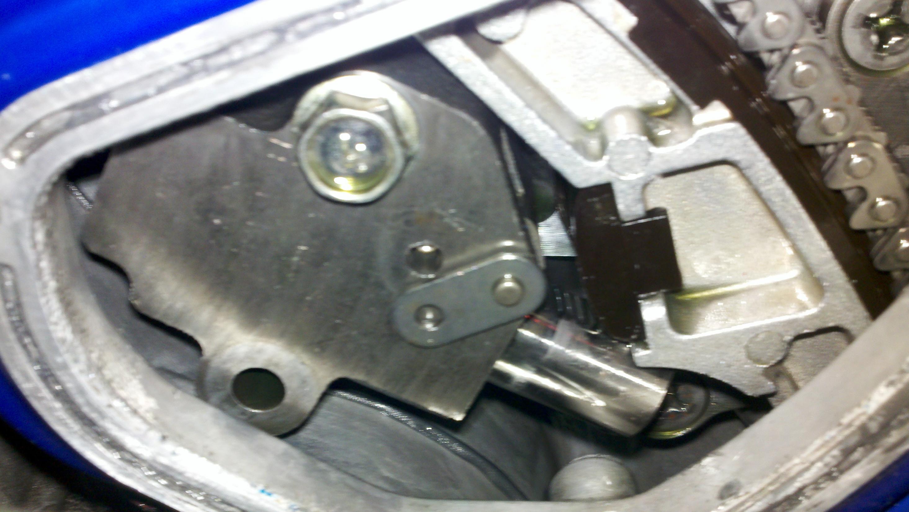

So today was another adventure. I attempted to remove the timing chain tensioner by following the steps in the service manual... FAIL.
As soon as I slid out the bottom bolt, the tension on the timing chain snapped the tensioner over and pressed it against the side of the cover.
To make things worse, when it did this it knocked out the drill bit I was using to hold the lock on the tensioner in place and it disappeared. After searching for 30 minutes and fearing the worst, it had fallen inside the timing cover, I jacked up the car and removed the under tray.... nothing.
Several minutes of swearing followed and then I promised the car that I would part it out and have it crushed if I didn't find the bit in 5 minutes. I crawl under the car again and sandwiched between the oil pan and filter is the bit. Obviously I was relieved and the car must have known I was serious.
The issue still remains that the chain is causing too much pressure on the tensioner for me to remove it or even get the pin depressed at all
Does anyone know how to get the chain guide out of the way to get the dumb a$$ tensioner out? Is there such a tool as a mini spreader or something that would do this?

TIMING CHAIN
24. Remove internal chain guide, timing chain tensioner, tension
guide and slack guide.
 Remove timing chain tensioner as follows:
a. Pull lever down and release plunger stopper tab.
 Plunger stopper tab can be pushed up to release (coaxial
structure with lever).
b. Insert stopper pin into tensioner body hole to hold lever, and
keep the tab released.
NOTE:
An Allen wrench [2.5 mm (0.098 in)] is used for a stopper pin as
an example.
c. Insert plunger into tensioner body by pressing the slack guide.
d. Keep the slack guide pressed and hold it by pushing the stopper
pin through the lever hole and body hole.
e. Remove the mounting bolts and remove the timing chain tensioner.
PAGE EM-52

If you remove the 2nd bolt, you can't wiggle it out? Hope someone that has done this before chimes in! Good luck man.

Chris try to loosen the other bolt that should release any pressure on it, then try to release the plunger to push it in some and wiggle it out. The timing chain guide will push only slightly to the driver side, as the chain will not let it go to far.

I took out the second bolt and was able to fully depress and secure the tensioner piston, but it still won't come out. There is still too much tension on the guide from the chain.
I will try tomorrow to advance the chin a bit by using a socket on the crank and see if I get any slack on the guide. If not, I will have to give up on this. Space is very limited between the fans and the timing cover.

Got it. After consult with Blinkerfluid last night I manually turned the crank this afternoon and the chain and guide became slack. Where the F is that little tidbit of advice in the service manual
The other tensioner is swapped in and fresh RTV on the cover. I will let it cure over night and then pull the fuel pump fuse tomorrow and build some oil pressurem put it back in and see what happens.
