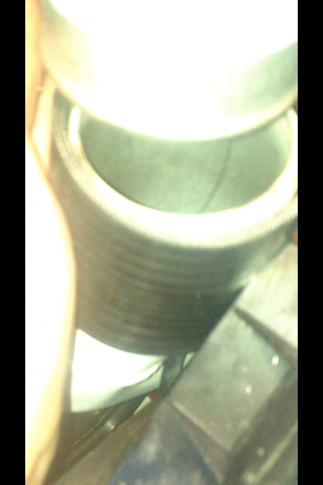

Well I pulled off charge piping coming directly from blower and for the most part it's pretty dry. You can feel a hint of a film of oil. But doesn't seem like anything catasrophic. I'll have to be easy on it or not drive it at all till I get this BLV off this..

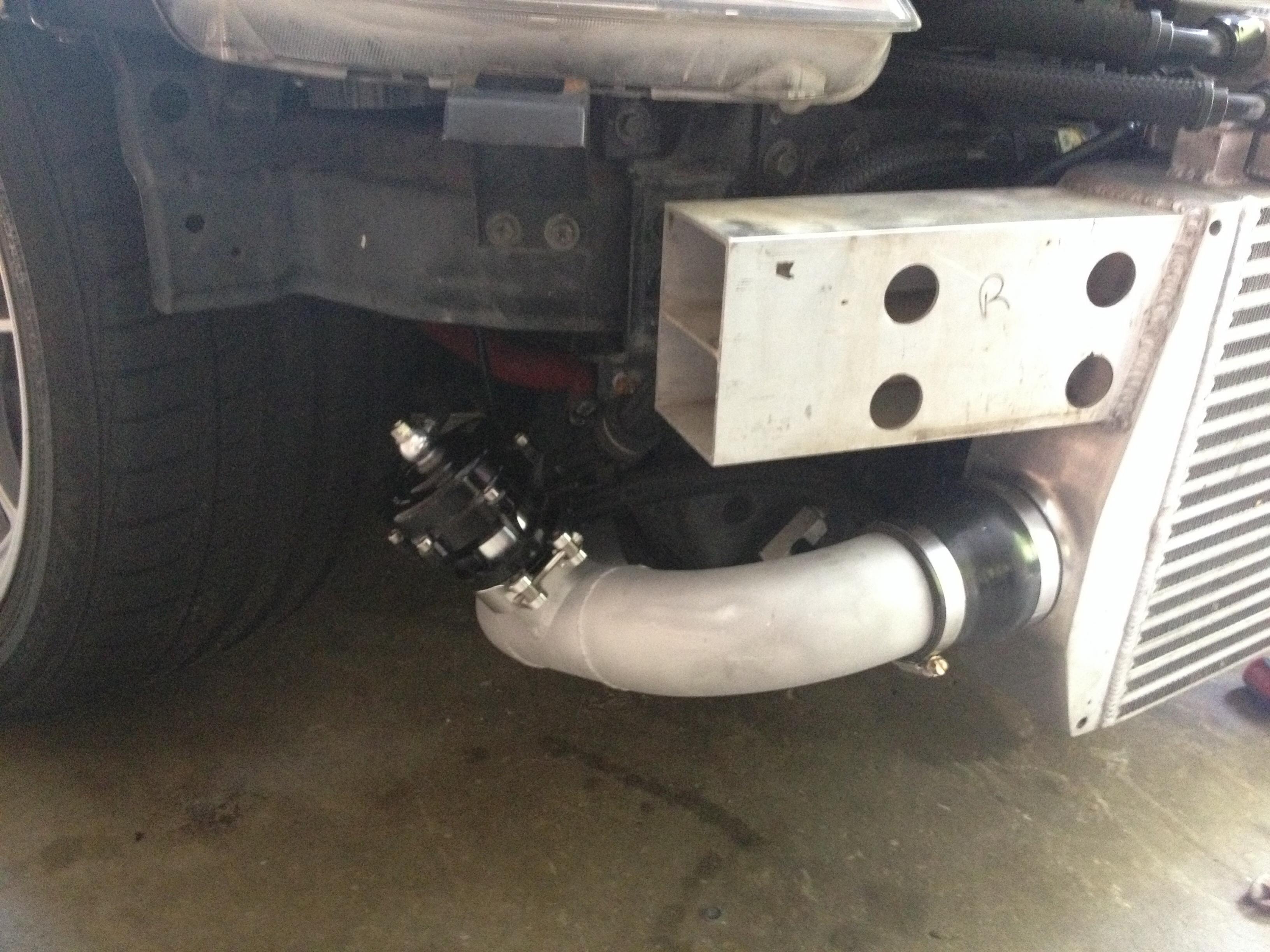

Finally got my tial q bov welded and hooked up. Also added a much larger vac hose to control it.

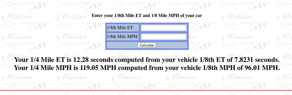

Here is a ballpart est of where your 1/4 run would be.
If you set your car up right, you should see Low 11's and High 120's mph
